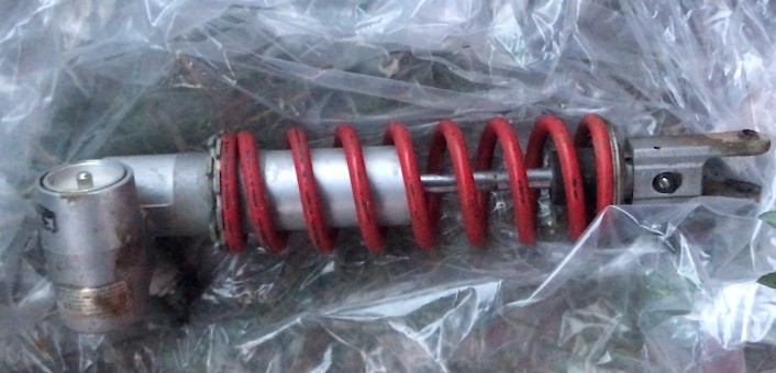

Shock is removed and I want to get it re-valved. This was a lousy shock in its day but I never could afford to get it worked on years ago. Plus, I was a Novice race so I probably wouldn't have noticed if I did.
Contacted what I thought was one of the better Colorado local suspension experts and turned out I was in for a little surprise.

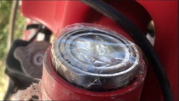

Since I don't have any motorcycle salvage yards in my area I contacted some people on Ebay and Craigslist about the triple clamps they were selling. And to my surprise I actually received some valuable intel. It appears Honda hasn't changed the headset length on their bikes in many years. I came across a sweet set of forks from a 2008 CRF 250 and the measurements are real close. I ordered my All Balls Racing bearings and low and behold they fit.

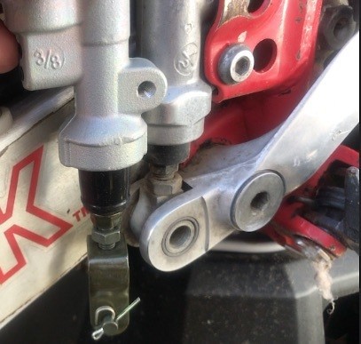

So as I started working down the bike it appears my rear master cylinder is shot. A rear master cylinder rebuild kit is about $19 bucks but I started looking at the basic design and size of the newer rear master cylinders and again decided to take a chance. I purchased a newer style master cylinder, if the current bikes are using them there must be a reason. Unfortunately, I did rear that in 2002 Honda actually make the rear brakes smaller so this might be a mistake if there isn't enough pressure for my old brake caliper.
In 1989 Honda put the newer style rear master cylinder "rmc" on the 125. The clevis is different and the bolt is smaller, therefore I ordered a 1989 brake pedal figuring the frames are close in size and can't be that much different, I hope. I also came across a new product which solves the other problem, that being the spring. A company named Fasst Company makes a rear brake return spring which fits on the bottom of the "rmc". Using this product makes the brake pedal spring attached to the bike frame unnecessary.
Photot
I have my fingers crossed the the brake pivot bolt for the 1989 cr 125 will thread into my 1988 frame.

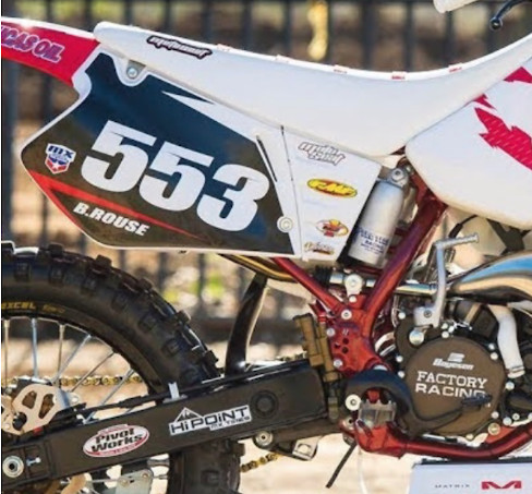

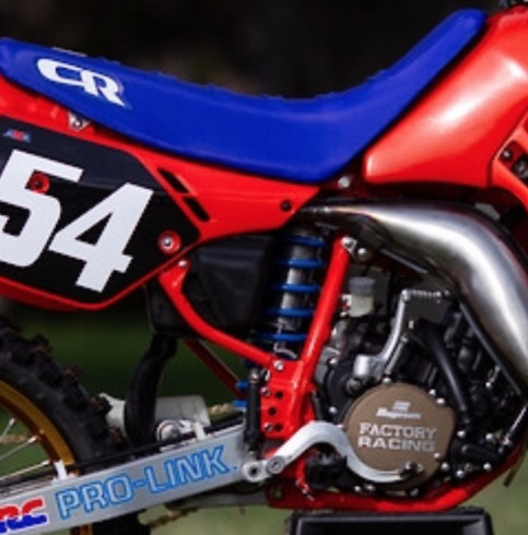

Pictured below is the rear suspension of a 1987 Cr 125, which is pretty much the same as my 1988, just with better valving. Now after looking at photos of newer bikes into the 2000's I noticed the mounting of the shock is different. The 1988 was the last year of the top mounted linkage to the rear shock on the cr 125's. Ricky Johnson's 1988 250 had the bottom mounted linkage to the rear shock. This enabled Honda to put on a longer shock, I am guessing, and of course lower the center of gravity on the bikes. Oddly enough the design hasn't changed much over the years.
vs a 1995 bottom mounted linkage
With that in mind I started looking at rear swing arms I could install on my Works Bike to possibly improve the suspension. I haven't done any measure but I know the engine cases didn't change into the 90's so the newer swing arms should fit. Unfortunately, most of the swing arms I came across on Ebay were trashed. Not sure how people trash a swing arm with a chain but there are a lot of bad one. I guess getting one welded is a possibility but I found one that was in good shape and Black Powder coated for the same price as the crappy ones. Thing is it is not a 1989 or 1990 which I think will mount up perfectly, except for the linkage and shock. The one I bought is a 1992 but after looking at pictures and knowing the engine cases haven't changed nor has the frame it should work but I have my fingers crossed.
