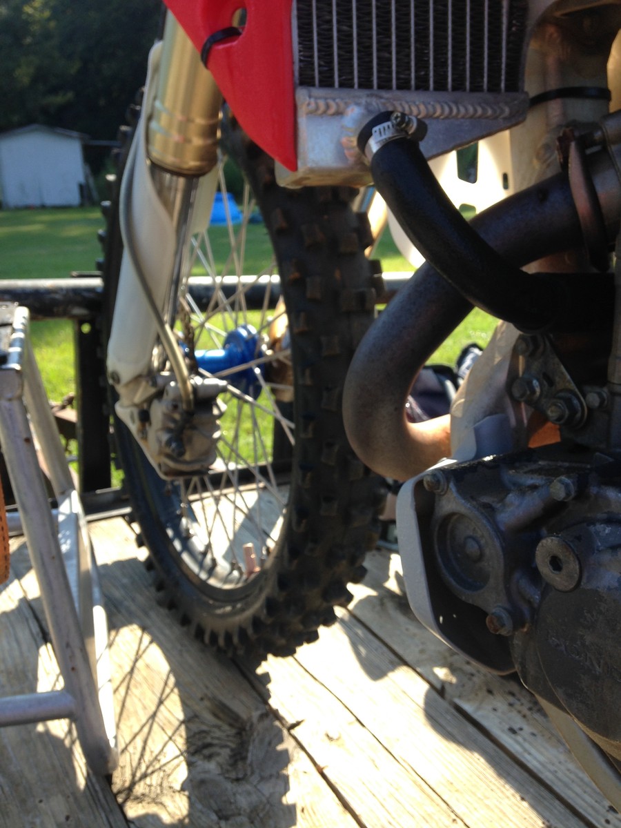

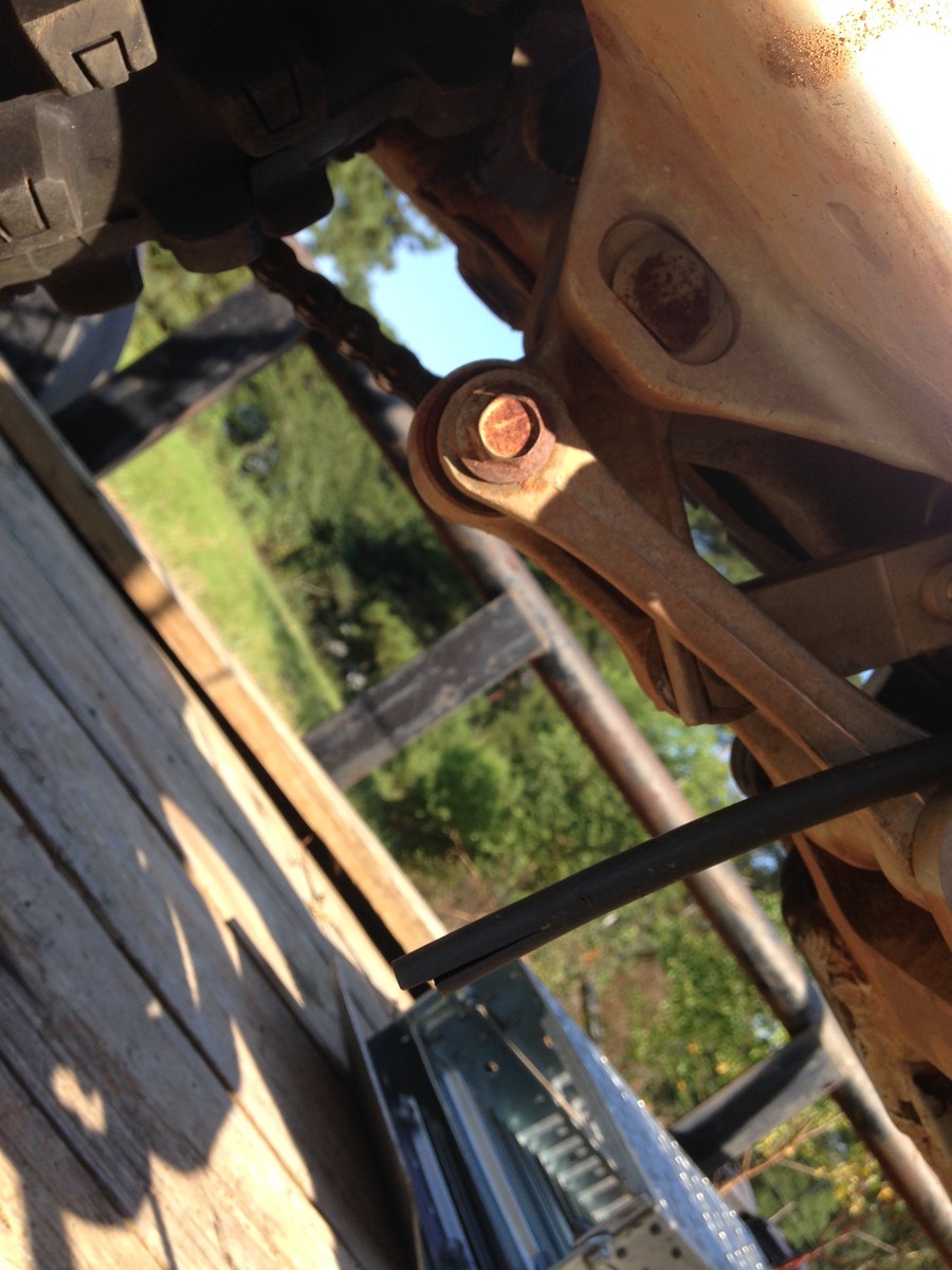

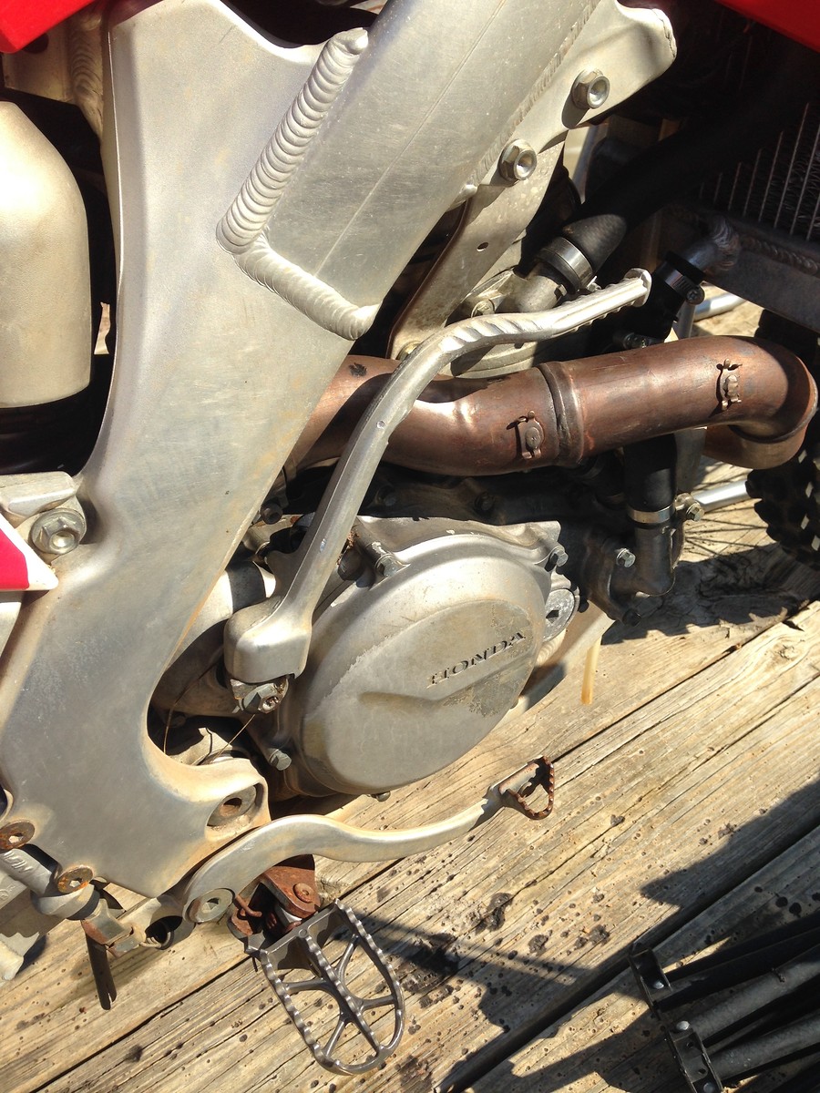

The above pictures are just before I bought this bike. Needless to say it was a little neglected. The below picture is about where I am at now with it.Photo
2012 CRF250R
2012 CRF450R
2017 CRF450R
10/7/2017 8:21 PM
Keep up the good work. I am interested in how this is going to turn out. Do you have a picture of the whole bike before you started working on it?
10/8/2017 5:12 AM
No, I forgot to take some when I brought it home. I started to clean it and the next thing I knew the electric impact was out and the bike was in pieces. Some of the bigger bolts had rust on them; so I had to know what I had gotten myself into. I'll take some pictures later today. The motor is slowly but surely being taken apart. Now I need to order some of the specialty tools. With being in such bad shape cosmetically I was pleased to see the motor was in good shape internally.
