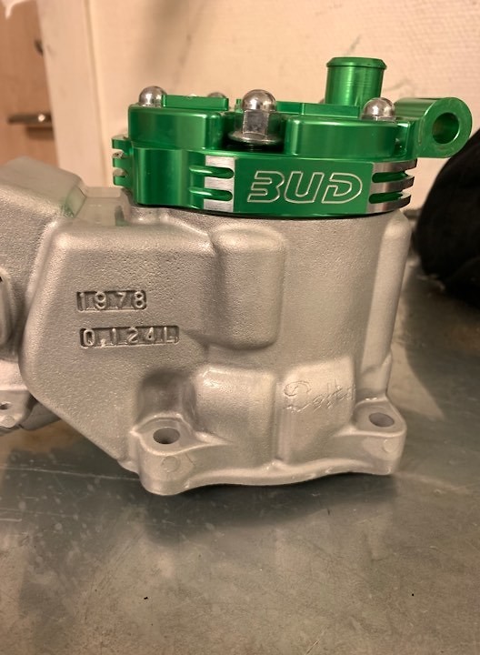

Engine is sent off for some porting.
BUD Racing top
Boyesen intake
Lectron - will come soon
PC works exhaust

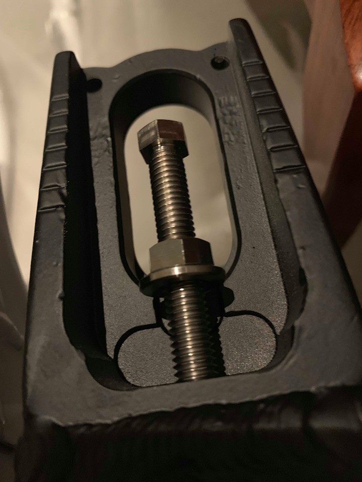

CRF 150 (same on older CRF250) clevis with CRF rebound adjuster.
Grinding 1mm to get it over the linkage.
The only thing Ive noticed is that you get the ordinary clicks on the rebound and some more without any clicks, but it hasnt botherd me since it works great !

Also got the engine back from glassblasting, at the moment I have no bearings in the blocks and is still waiting on them to arrive. Went with all original Kawasaki bearings to be sure that everything is the best as it can be.
The cylinder arrived from porting and new nikasil (is this the right word?) i am very happy with the outcome.

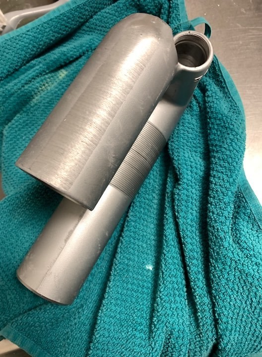

Also disassembled my suspension, and tripleclamp to send it off for some cerakote. My local suspension guy will then build the suspension so it works for my riding style.
