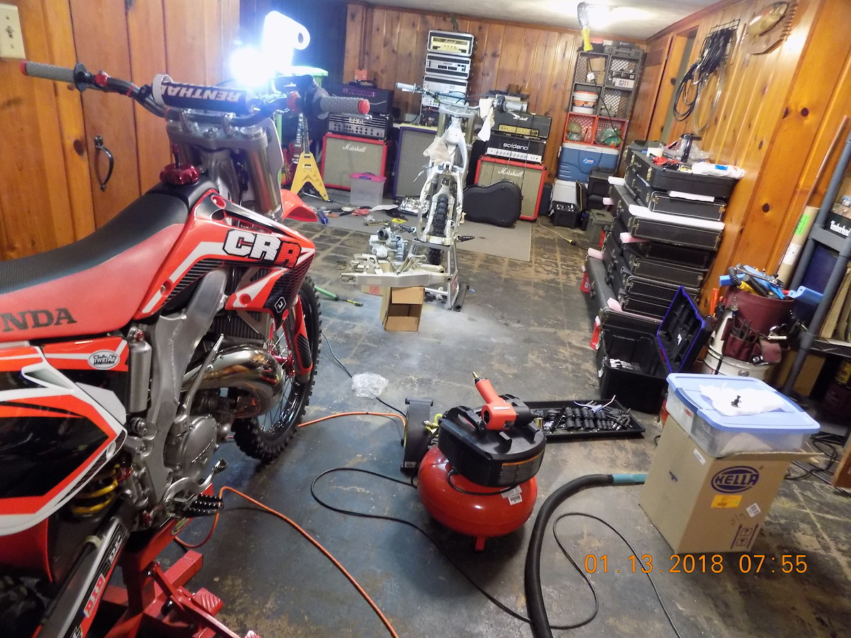

Well, cold as all get out.
Got a CR125 07' unit broken down, and tons of parts awaiting installation.
Suspension going to Factory Connection for revalving/springs, etc. $$$
Wheels will be silver Takasago/Talon/Bulldog/spline nips/Starcross5 med. FMF Fatty/Turbinecore2. Ride Engineering clamps(perhaps?). Leaning towards the "Lighter Side" with my cheap assed epray FLU graphics and am tired of black rims.
Engine/tranny will get the "Full Monty", and ALL other bits of the bike will be rebuilt to OEM. Not a rocket, just reliable fun.
I restored an 05' last year and it was a blast. I fabricated some tools from basic hardware store stuff to simplify much engine work, and will post photos of the 07' rebuild as I go along over the next few months. Hey, I have a demanding job. Keeping the build under $5K. I know, $$$, but I love these bikes.
It is only money and time, and good to keep old Honda 2T's around... Stay tuned, because it is good to share and I have learned so much from the builds of others.

Gotta tidy up the Man Cave a bit, get the guitars put away, and get moving!

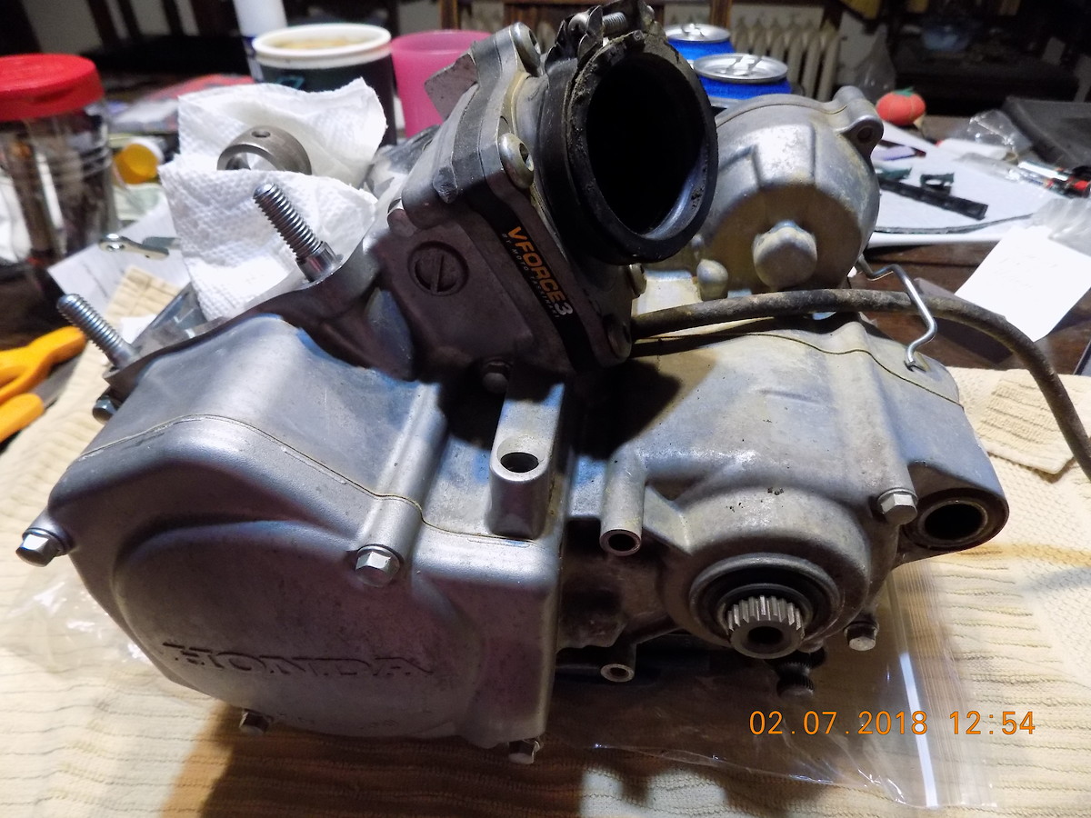

NOT good... Can feel severe bearing contact ridges with fingers alone. No need to measure/mic:
YamahaJT1
1233
3/17/2015
VA US
2/7/2018 4:36pm Edited Date/Time 2/7/2018 4:50pm
GOOD:
I cannot imagine how bearing race worn axles benefit my pending new FasterUSA setup...Wheel slop from worn axles compromises and promotes wear from the "get go". It is a Holistic system....
YamahaJT1
1233
3/17/2015
VA US
2/7/2018 5:13pm Edited Date/Time 2/7/2018 8:27pm
A bit of brass brush cleaning during Oakland SX... Sit at the bench/table and lightly brush. Watch the "Boob Tube".
I am not a fan of removing "casting ridges", because they do function as "Mini I-Beams". Anyone who has been to a "Strength of Materials" class knows this. Excess removal of material via blasting/sanding/grinding is your call. Yes, even brushing falls into that category overall.
EDIT:
With patience and light brushing, you'll round over the harsh OEM casting ridges that trap dirt. Yep, I am that OCD in the winter... Gotta get this build done soon.
Also note perhaps the most "organic" parts on a dirt bike... "Oddly shaped" Shifter and Brake levers and how they direct/funnel contact points via bevels towards the control surfaces. Cool. I only completely remove the casting ridges on the top and match OEM bevels on these parts, No wonder we love these things.
