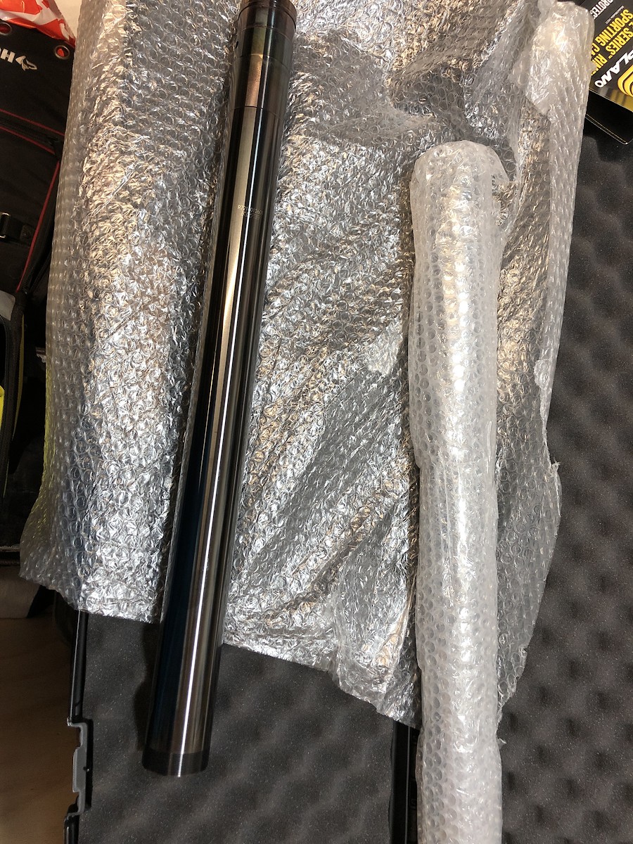

Sneak peak at the JGR lower tubes. KYB factory dlc lowers. Also have a few other really cool parts that Factory connection is adding to the forks aswell. More to come when I pick up the forks in the newxt week or two.
How much for the JGR tubes? Thry quoted me a set for $700usd, got a set from TT for $400aud
2/23/2019 4:22 PM
I picked them up a few months back from someone on here in the for sale section. That's also where I bought most of the bigger stuff from. I try not to buy brand new but I also work at a dealer so it is convenient to just buy from our parts counter.
