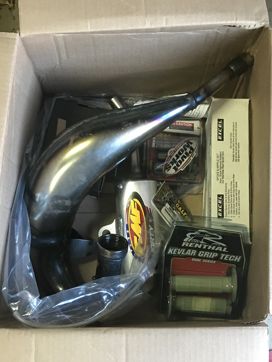

Box of parts from BTO. Fmf fatty and shorty for the pipe and silencer. The spokes for the wheel set. Renthal kevlar grips. VForce 3 reed valve. Galifer steel braided front brake line.
