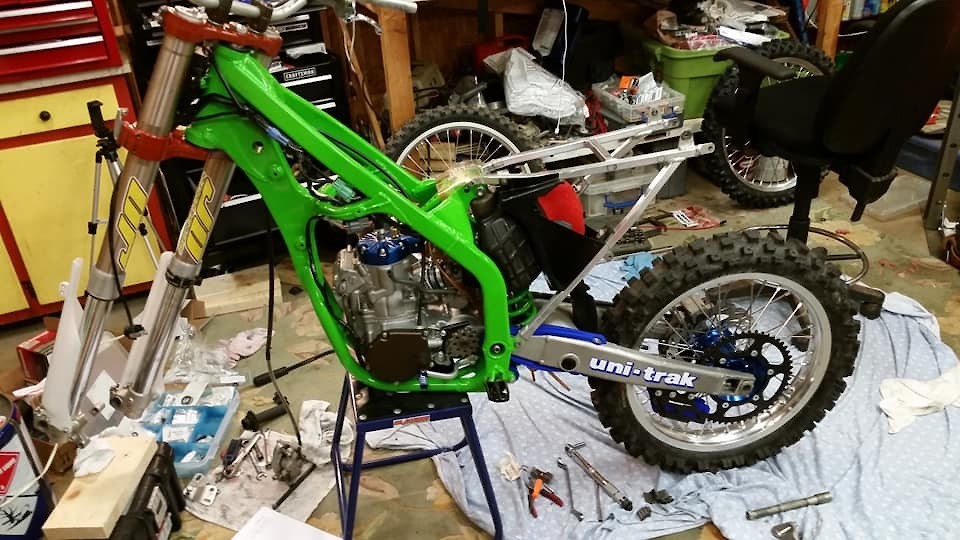

Piston kit should arrive Thursday. So tonight I torqued the rear linkage & shock to spec and installed new chain roller and slider. Couldn't find any non-black sliders stateside so I got the blue one from UK.

Powder coating done. Also, seat is finished with a pretty trick cover that I haven't seen on a bike in a really long time. Will drop...

Mounted tires and disc rotors on the new wheels tonight.
8/30/2018 9:48pm
Can't decide if I want to keep the uni-trak decals on or go with plain swingarm.

Piston kit came in today. I like that it's coming together quicker now that most of the intricate work is done.
Hope to have it back together in time for Sunday or Labor Day break-in.
8/31/2018 9:34pm
Always helps to have the right tool for the job. These interior cylinder base nuts were always a PITA until I discovered that an offset 12pt box end wrench works perfectly.
Luke hooked me up with a slightly lower compression Phathead insert to allow me to run 93 pump if I want. He also supplied me with two standard compression head inserts as spares.
The OEM intake boot was dry rotted, so it was either direct OEM replacement or RAD valve. The RAD valve was a few tenners more, but I get a nice AL intake and maybe improved throttle response.
Won't be long now...

The old brake pedal and kicker were worn out and rattle canned, so I indulged in new replacements...
Motor is all together now:
Need figure how to glue the rubber gas tank mounts to the frame. They were stuck on before, but not sure what Kawasaki used.
Anyway, progress:

Notnsure what others do, but I usually sand down the middle part where they sit and use grip glue to hold them on for the rear ones, the ones on the frame spars i just use small zip ties

Tomorrow I gotta fix two stripped fork guard threads from PO. Have helicoils ready to go for that. Then, install front wheel & brake, then get the cooling system installed.
9/2/2018 12:30pm Edited Date/Time 9/2/2018 12:30pm
Radiators installed. Got some GPI hoses, but only 1 out of the 4 in pack actually came close to fitting. Ordered for a 07 KX250 two stroke, so not sure what's up..they looked close but were just off either inside diameter or length too short.

Threw on an old seat for the time being. Gonna study up on graphic installation then install the plate backgrounds, shroud graphics and new seat tomorrow.
9/2/2018 7:37pm
Just started her up for the first time. Bike sounds so good. I picked up too short of a chain so I won't be able to ride it just yet.
