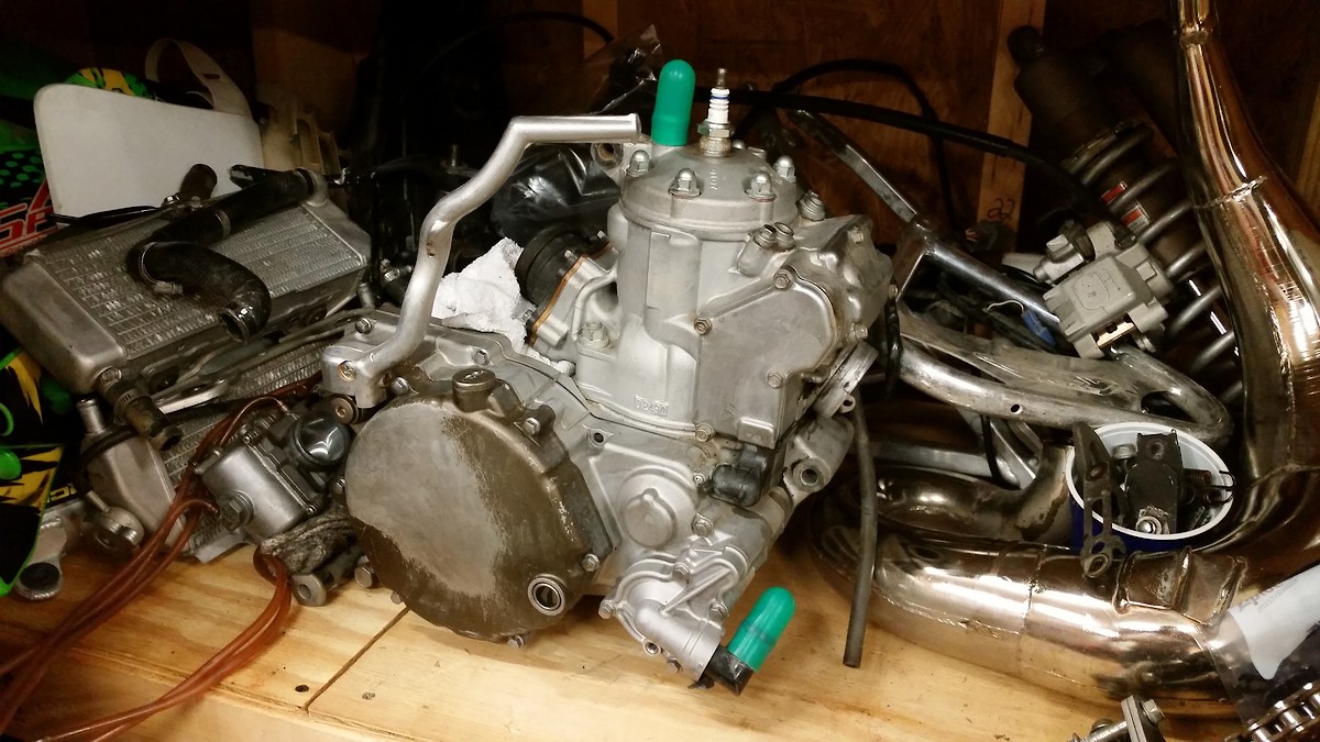

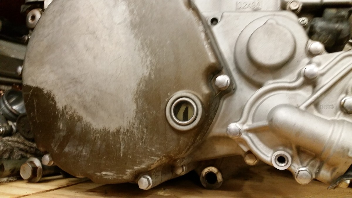

PPO had a chain break which then broke the center case. The welds look good, but the PO used a little patch of JB weld to fill a spot the previous repair missed. I've ordered new center cases from Kawasaki.

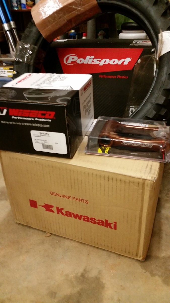

* OEM centercase set
* New UFO plastic kit
* Pro Circuit linkage
The plastic kit comes with white side number plates. Anyone know where I can get green side numberplates?

Stash is comin' in
In any case, I have new cases. Need to order new crank seals just in case. Plan to use OEM Kawasaki for anything in the bottom end. Heard enough horror stories about aftermarket connecting rods and cranks.
If you are replacing cases, surely at least your doing all seals, crank bearings at least, right?
On making sure its all oem, you might find theres not alot of oprions for seals/ gaskets oit there anyway for that bike. But if you do need a rod, pro x make quality stuff. Nothing wrong there. The hot rods brand have been cheese since they sold to another in mid 2000s.
Where was your cases cracked? If trans oil was getting into piston area, it would have been smoking white, even if just a little. Those cases use semi drying gasket to seal to eachother, like all kawis, wonder if they split it to repair, and didnt seal it up good when going back together,
Drain the oil out of trans and measure it out. If you mesured it in, that will get you an idea of what was lost.

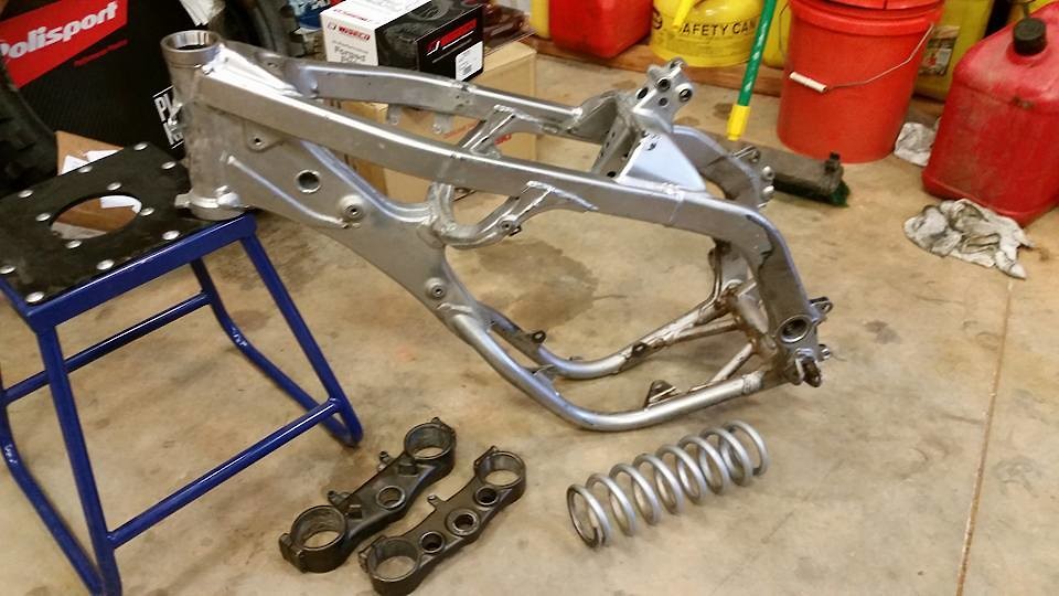

You painting frame green? Or leaving silver?

I ripped mine off and put them back on with super glue after my frame was powder coated.

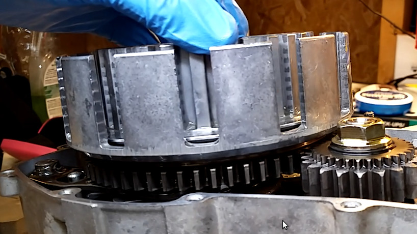

OEM Kawasaki: 13095-0048 - $282.79
Hinson: 151-1013 - $259.99
Wiseco: WPP3048 - $169.95
Barnett: 321-45-01014 - $233.10

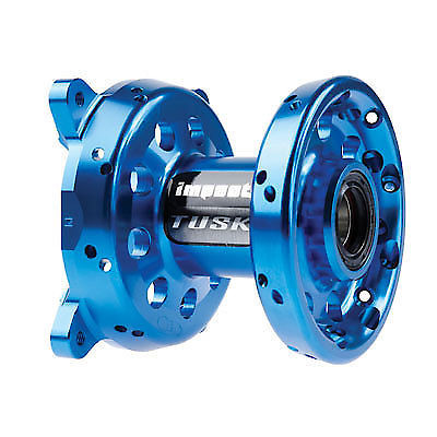

And if not done, would be a good thing to drill the inner hub. Helps with oil flow thru the clutch. If you could buy a better inner hub, main difference other than coating would be that its drilled.

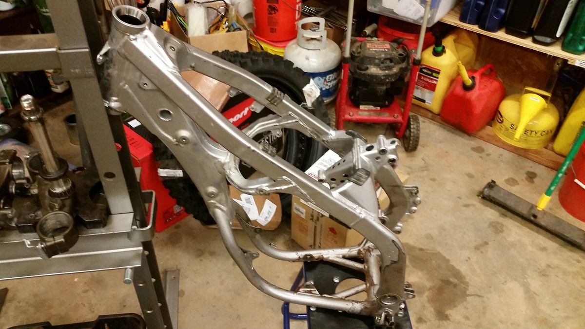

Waiting on a couple special tools to arrive for continued engine disassembly. Stuff I know I'm replacing with OEM part numbers:
* Connecting rod & big end bearing
* Main bearings and seals
* Shift and kicker seals
* Clutch cover (for aesthetics)
* Ignition cover (for aesthetics)

I think that Hinson stuff is overrated, especially now there are so many more options. I'd go the wiseco straight up, I copy and pasted this directly off their website "We will stand behind all Clutch Baskets, Inner Hubs, and Pressure Plates by offering a LIFETIME WARRANTY if they were purchased after 1/1/2009. This warranty covers breakage and notching and covers the original purchaser when proof of purchase is presented directly to Wiseco Piston Inc.". Plus it's a 250 and sounds like your a trails/woods rider if you're taking off the R304 shorty, so your not really going to be giving the clutch a massive flogging to start with.
Mitaka and Pro-X are also good options, only thing with Mitaka is I've seen some of their baskets have sharp 90 degree edges on the inside of the fingers which can break the tabs off clutch discs and ruin a gearbox.
Probably go ahead with the Wiseco basket since the warranty is so freaking good.
Who makes inner hubs for the '07 KX250? Searched around and all I could find was a listing for Vertex hubs but those are in Italy with $$$$ shipping.
