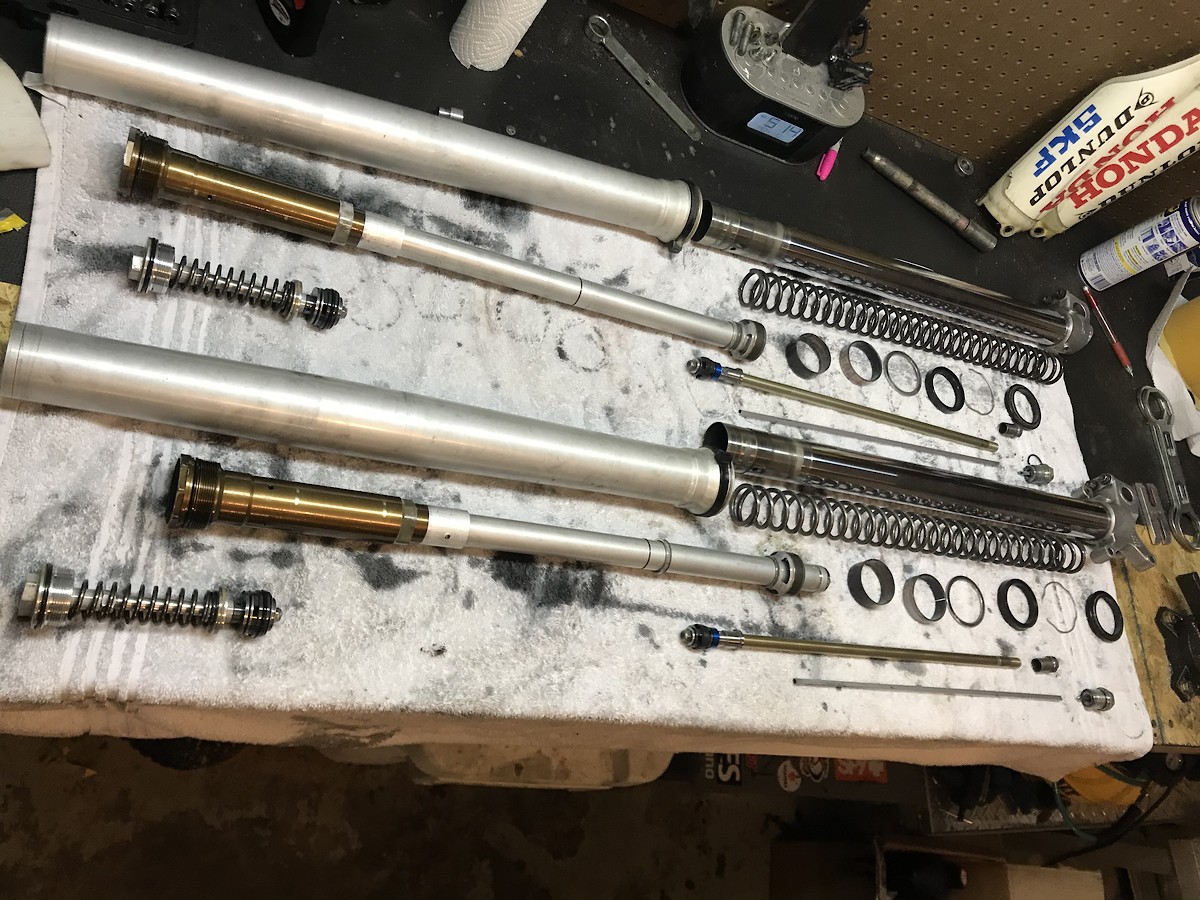

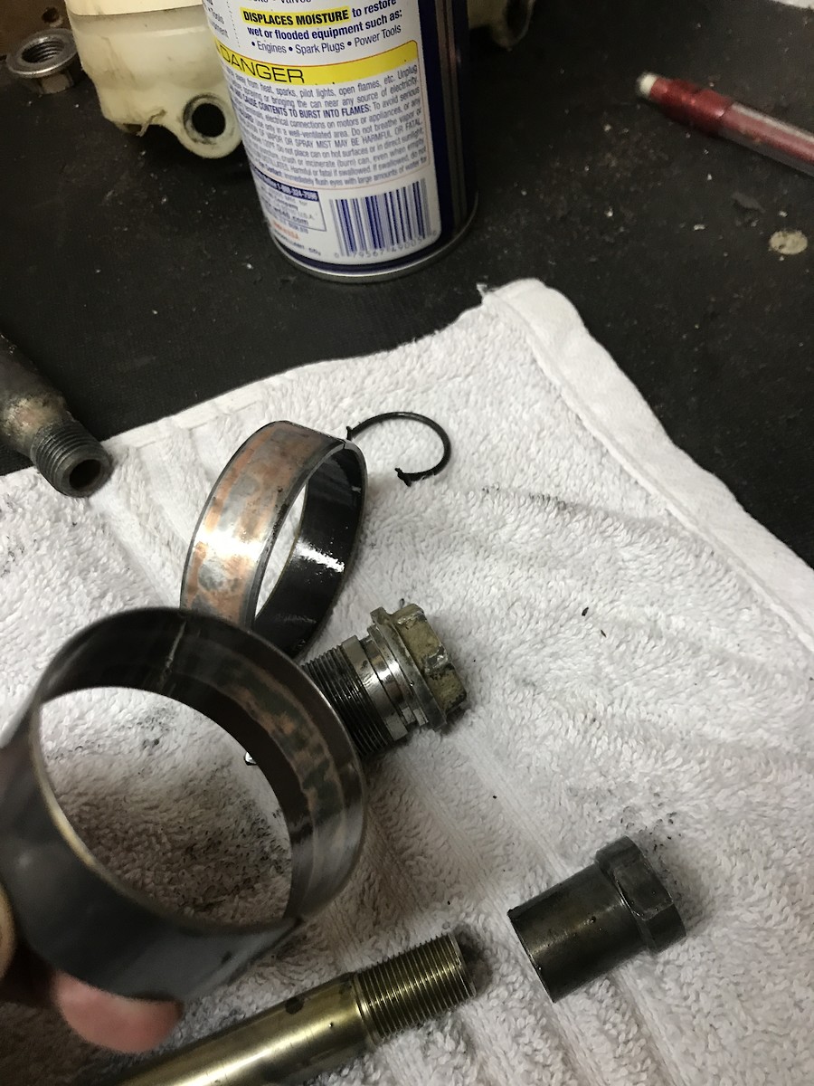

Last thing im doing is the fork seals, as they were leaking pretty bad, even after i would use a seal cleaner. These were a huge headache since they arent stock forks. Guy told me they werent that i bought it off, but wasnt sure what they were off cause he never needed to replace them. I ended up pulling the dust seal number, searching it and coming to racetechs web, which were for showa 47mm forks. First guess to order was to put a 2007 CR250 in and see if i get the same seal part number. Ended up being the same so i ordered seals for the cr250. Next was the bushings. For 47mm forks, there is only one inner bushing so that was easy, but for the outer they make a 15mm tall bushing and a 12mm tall bushing. Pulled the forks apart to measure and mine is the 15mm. So back to racetechs website to see what they list for the CR250 and they list the 15, again what i have. So now i can just order seal and bushing kits, or any other part (needed an o-ring) for 2007 CR250s and should be all good. Seal below thats torn, i measured the other side, and the oem seal is the same size for the Cr250. I havent put the forks back together yet cause im waiting for the bushings and oring, but i should be fine...hopefully.
Forks felt awesome when i got them, and i can visually see they revalved them because there is a nyloc nut on and its not peened. Also put a softer spring in one side to average the rate super close to what i would be running. I was bottoming them on the track, so ill play with fluid level once i get them all back together and see how they do
