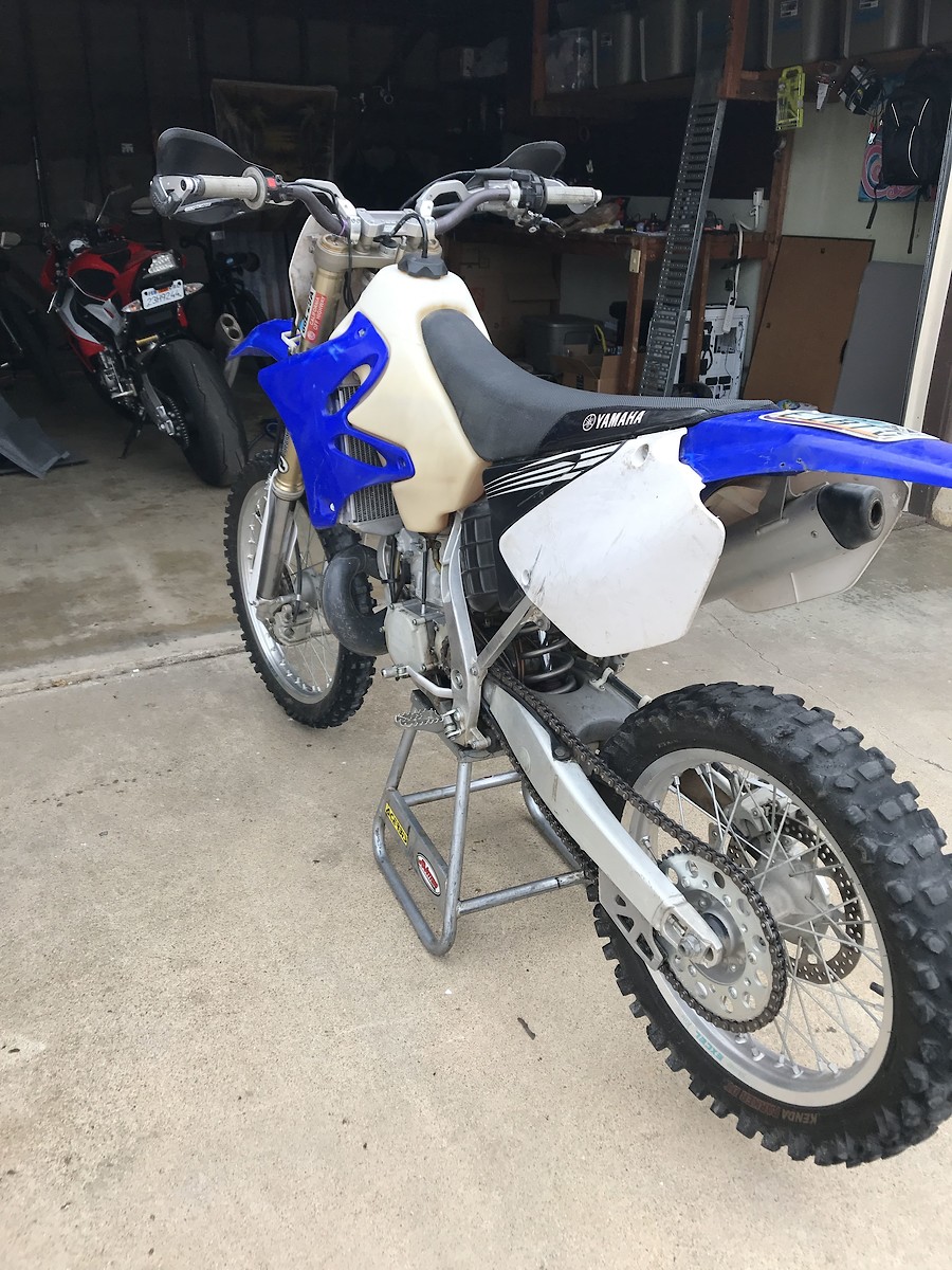

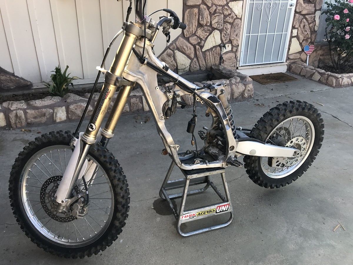

When I got it home, I knew I had some work to do. I am so used to 200HP street bikes, it was crazy how slow it felt. My last bike was a KTM 250 SX back in 2006 and was one of the first to do the 300SX kit...had that ported, etc and it RIPPED.
Saw a lot of people going Eric Gorr but heard a lot of mixed reviews. I used Tom Morgan Racing back in my 125 days and he promised his YZ295 is much better then Erics. So I tore apart the bike to the frame. The cylinder head looked good, but the piston had signs of detonation. Possibly the previous owner just swapped heads?

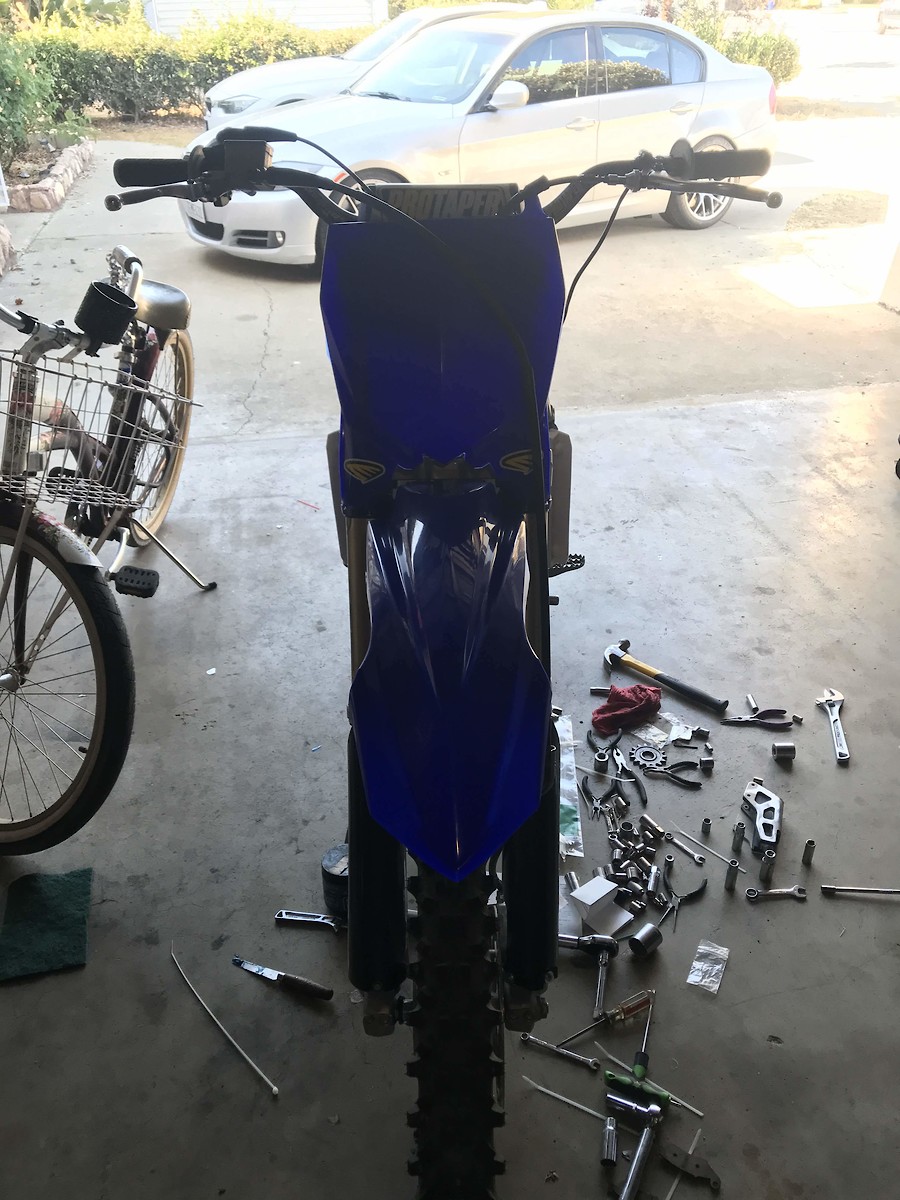

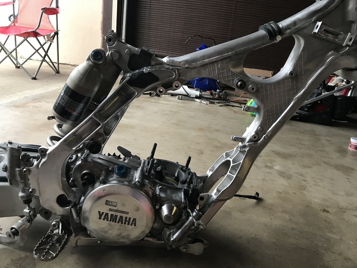

8/22/2018 2:26 PM
Edited Date/Time: 8/22/2018 2:28 PM

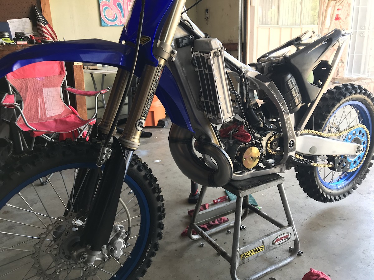

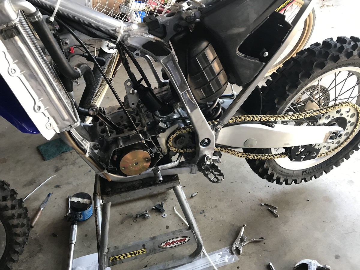

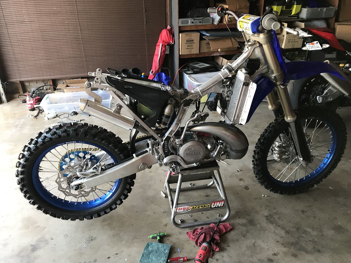

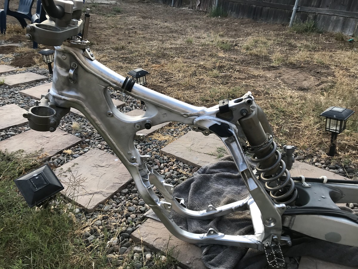

Frame was really bad shape, so I used a slow spinning wire brush on the end of a drill, a Dremel and some scotch brite pads.
At this point, I wanted to re-grease everything (no pics of that) and start ordering parts! DEP works pipe, R304 shorty silencer, 2008 CRF450R front brakes, Vforce 3 reeds, new plastics, chain and sprockets, and tons of other stuff. Some of it is already on. I then found some 2018 YZ250 wheels brand spanking new, so nabbed those up and threw on!

8/22/2018 2:32 PM
Sorry, site seems a bit glitchy. Sometimes will only let me post 2 pics. Photo

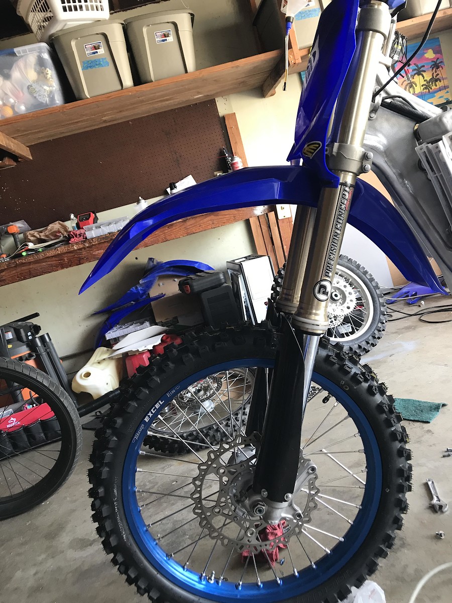

8/22/2018 2:36 PM

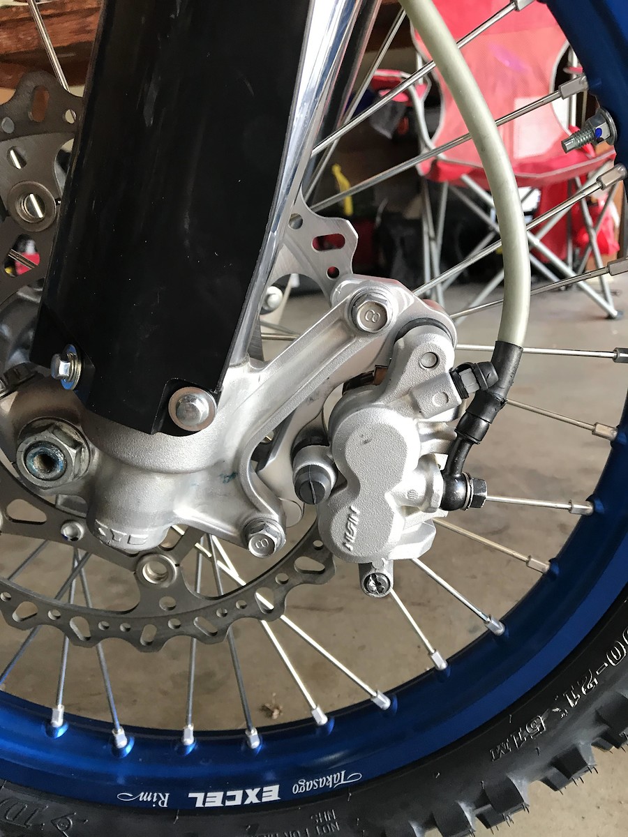

Had to order the Tusk 270mm adapter to get the 2008 CRF450 calipers mounted. Brakes work fantastic now that it's bled with new system!

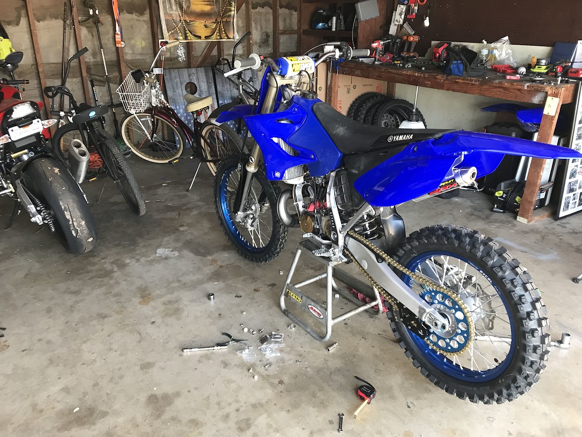

8/22/2018 3:13 PM
Ordered a guts seat, blue bottom, white top and red stripes. I like the patriotic look. Also, Red Label is making the graphics and waiting for them to show. Here is the final product.
Also wanted to see how DEP pipe might look, so just threw that on to see smile

Mostly MX, but may try some other stuff. I'm from Oregon I did all sorts of riding...MX, woods, Desert, dunes. Took it to Pala the way it looked when I first got it and it was rough!

I did the whole front brake system, master cylinder, lines, caliper. Was a little more expensive then most, but looks almost brand new! Threw on new Honda pads, put on an adapter to fit on 270mm disk, and bled it.
Obviously haven't ridden yet but old one couldn't even slow me down even after bleeding. Probably needed a rebuild.

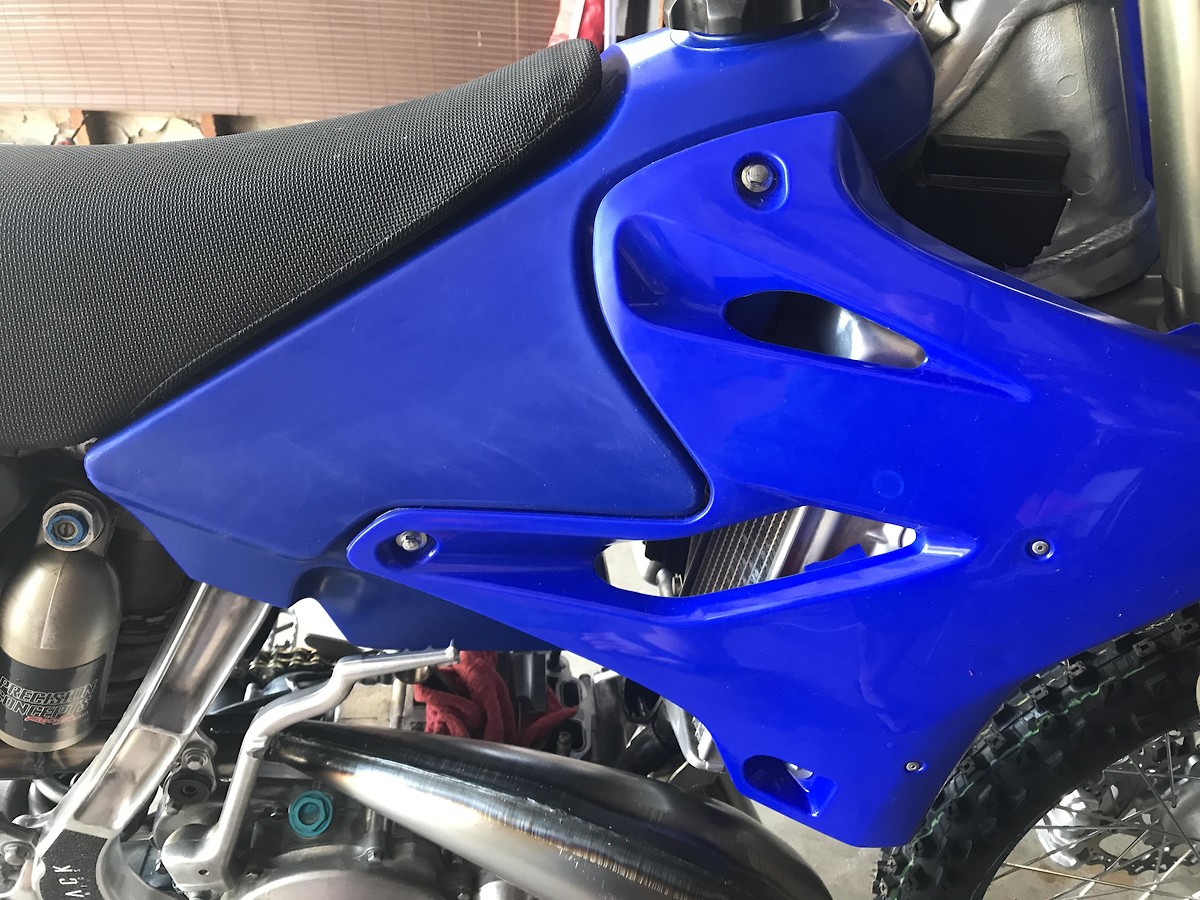

8/23/2018 11:18 AM
Still waiting on a ton of parts like cylinder/head/piston from TMR, GUTS seat, graphics. But the graphics should be here next so I decided to do a mockup and to make sure I could find all the fitting for plastics!

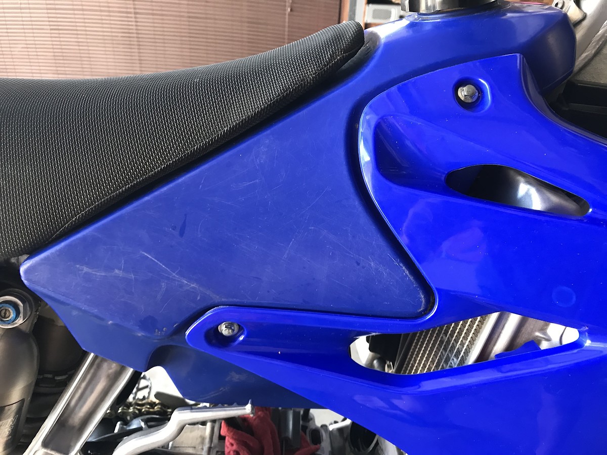

Anyone have any tips on cleaning the gas tank up? As you can see, pretty big color mismatch. Photo
Photo Photo

Tried a little magic eraser, and goof off to help clean up tank. It's been drained of gas for awhile. I guess most of it will be covered by graphics, but a lot is still exposed. Before and after of 15min clean up job...
