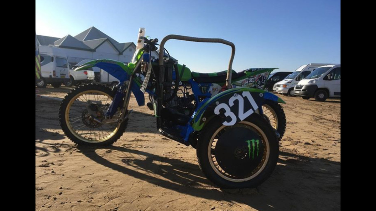

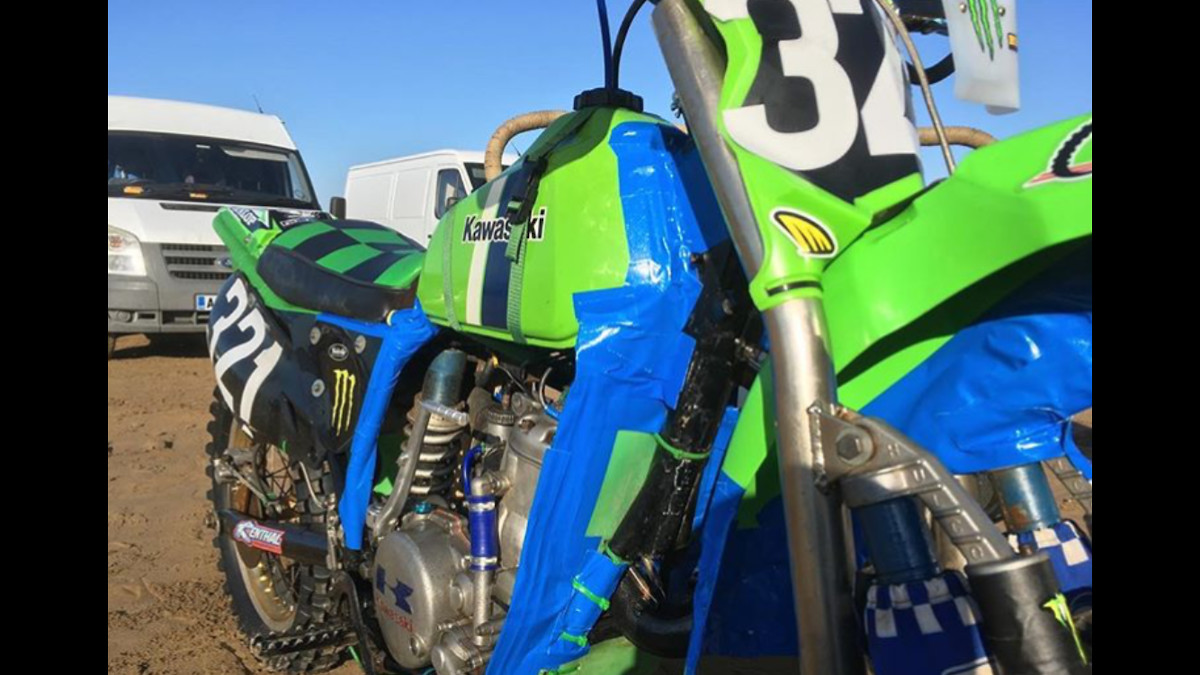

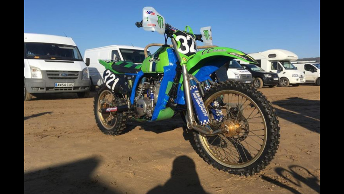

Sorry I haven't had time to post the past few days. I've been busy in the gym and ordering parts.
It's going to be a PC 97 splitfire replica.
Here's where I'm at:
-Neon green frame
-big tank under seat
-decals and gripseat cover from EVOMX+ big seat.
-yzf 450 front end (Kayaba SSS)+ brake+ bigger springs
-kxf 450 triple clamp offset 25.
- swingarm sent for +3cm
-bud racing HGS pipe + carbon silencer
-13oz flywheel weight+ carbon cover
-carbon front and rear disc cover.
-Boyesen carbon Reed's
- Flogreen Neken bars w risers
-ohlins steering damper
-raptor footpegs
-new to me break pedal
- big radiators and found Devol protection+new hoses.
-rebuilding wheels w new spokes and Powder coat hubs bronze and rims black.
Added bonus found myself a nice splitfire jacket online ?

Nice Color, tank looks great with the weight distribution.
I want to see more pics of that tank!

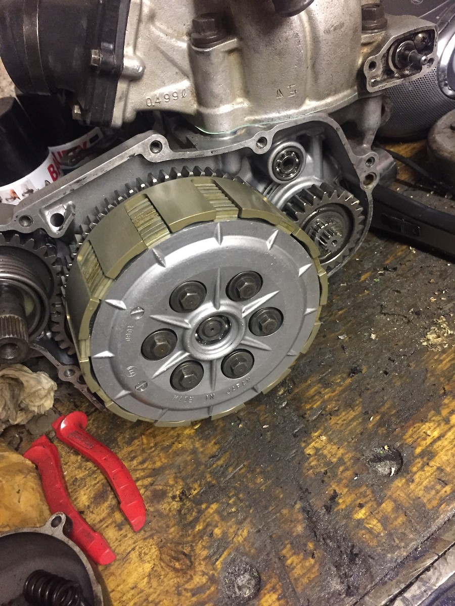

Back from the states, let's get to business.
Graphics, break down the wheels, add flywheel weight, new blue silicon hoses, bits of carbon parts.

Where did you get the tank?
Found it for 20 euros in Spain. I've been told it's from racing team. Weirdly it has same reference number as the oem
