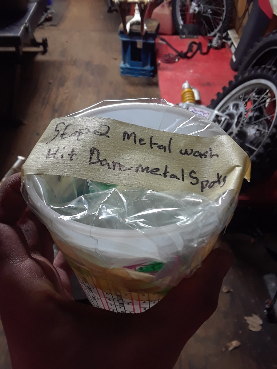

Sorry to u purists that powdercoat everything but this bike will be raced this year so just touching up a few spots with duplicolor. Also nice of my body shop friend that gave me some awesome cocktail of chemicals to prep everything. Once the frame guards and skid plate are on you wouldn't even know ? Will be splitting cases here in a few. Just wanted to get the frame and subframe done first.

I envy you tackling a complete tear down. I think it's great that you're not powder coating everything. I've got a buddy that found a cherry 1996 CR125 and he powder coated and went a little overboard with the rebuild modernizing it I think it kind of took away from its originality. This is actually my second 96. I bought one new back in November 1995(should've kept). Anyway I had a can of PJ1 Honda frame paint from 23 years ago that I was going to use to freshen up the sides. I thought it would be in the bikes best interest to not use it. I even called PJ one and they said the paint was discontinued years ago. Bummer.

Power coating a frame is not a "purist" thing, to me at least. If I had a clean original painted frame I would touch it up also. When I decide to have a frame powedercoated it is usually because I want the frame sand blasted & inspected for cracks, then any repairs or welding as needed. It's a 25 year old frame, If I were going to seriously race it, I would want to know the frame is 100%. You can get a frame to look very good with the rattle cans, it just does not hold up like automotive paint or powder. Nothing like scraping the paint off the lower rails just putting the bike on a stand.... of all my bikes there are 2 that I rattle canned, I grew up working in a body shop & painted cars commercially, I know how to prep a frame for paint, both of those frames I wish I had powdered or had body shop refinish. No matter what method, the finish will wear in the high wear area"s, but it's the other area"s where the higher quality finishing will hold up longer. Prepping the frame is the time consuming step in the process, If you donot sandblast it...if I had a friend in a body shop, I would ask how much to shoot the frame after you prep it...lay down some single stage enamel...thick & chewy! If he"s a really good friend he does it for a 12 pack.or lunch for the shop...and sends you off with a bottle of touch up in one of the little bottles with the brush tip......it's all good...I"m enjoying your build....

Thanks man alot of good points however I think I already commited to not blasting it and cleaning it by hand defiantly way more effort but now that I'm done it's all good. Kind of already have it in my head that the frame will get powdercoated next year so this is just to clean up bare spots or white spots that arw discolored. What i didn't think of though is inspecting the frame ,which I will do tonight before I paint it. Bike doesnt have alot of time but if it was rotted from inside from a hairline crack I wouldn't even have known unless I really check the frame over.
