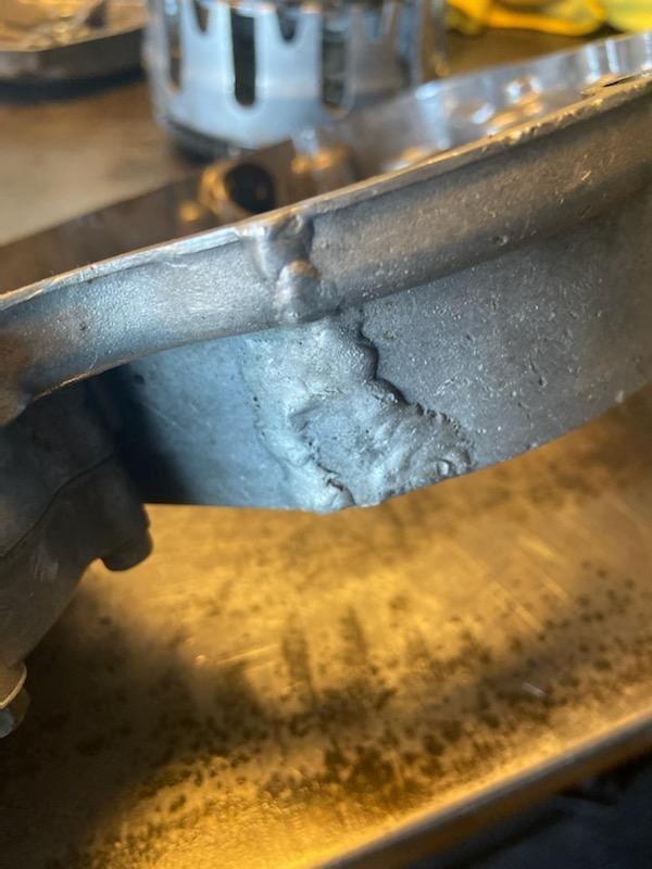

Second problem, tab for the lower radiator mount on the left hand side of the bike has snapped off
