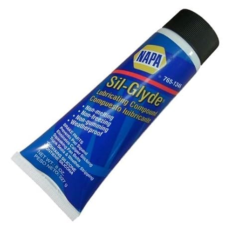

loving this build, i want a 95-96 cr250 build someday.
just a heads up, dont use normal or petroleum based grease in the brake pins, it will swell and ruin the seals/boots very quickly, the proper gease for those is this silcone based stuff made for brake pins/sliders. can get it at any auto parts store
ok the Maxima is not suitable then?
I put this one there because it is waterproof

adam8781 wrote:
correct any normal grease meant for bearing will swell and ruin the rubbers.
get the silcone brake grease in there
https://images-na.ssl-images-amazon.com/images/I/41DwwjgRZLL._SX466_.jpg
Ok, nothing is going up again, so I will quickly remove the maximum grease and go up with silicone grease.
thank you for the info
