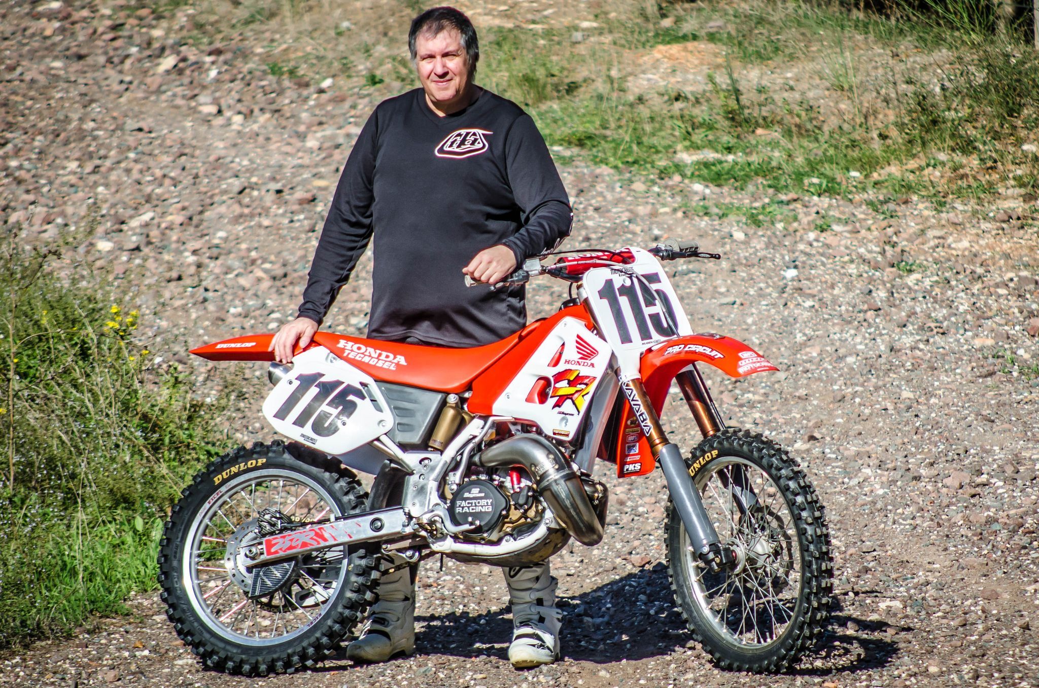

I am happy to finally start rebuilding the bike, after all these long months (and years) that I have started to collect the parts.
I really want to ride with it

2/28/2022 4:35pm
Hi guys
the bike is finished, here is probably the last video of its reassembly (I only have 2 or 3 things left to do on it) and then I go to ride it.
On this video I managed to activate the subtitles it will be easier for you to follow the video, I will do the same on the other videos.
See you soon
https://www.youtube.com/watch?v=v260gTtQvIM
