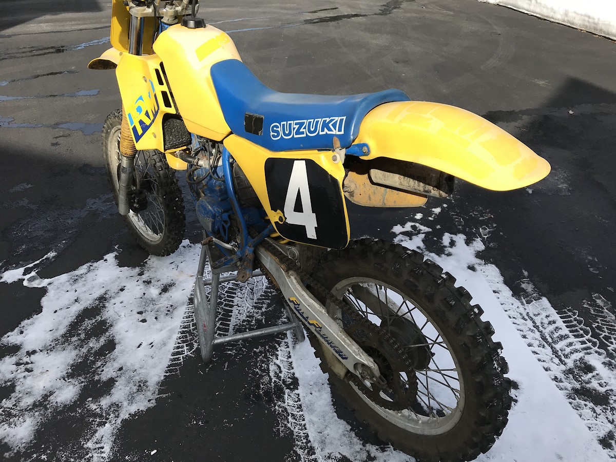

Bike had been for sale for weeks if not months locally, I had ignored it initially as the sellers photos were poor & ........it’s an 87 RM125...... nothing special....The seller had it listed as an 86 model....not a very good bike, I could tell it was an 87 based off the shock reservoir & shroud graphics, but that is all I could make out in the crappy original sale photos. Bike was listed as “no compression” so I knew it would be a project, but I got the bike for next to nothing..and It had some positive attributes for a project....no damaged cases or frame, pretty much original with low hrs...foot pegs, kick starter, rear brake & shift pedal and shock linkage all still tight....rare for a Suzuki....Seller did not even bother to wash the bike! Got it home & gave it a wash & looked it over better....

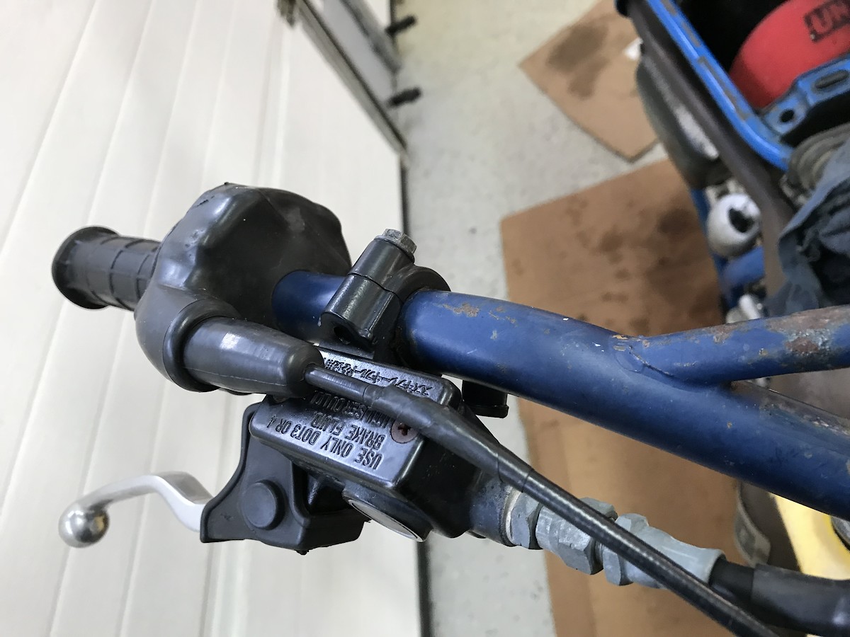

Original handlebars, bent but an indication of the hrs on the bike...the bars have a stopper on the front brake side for the master cylinder to rest on Photo

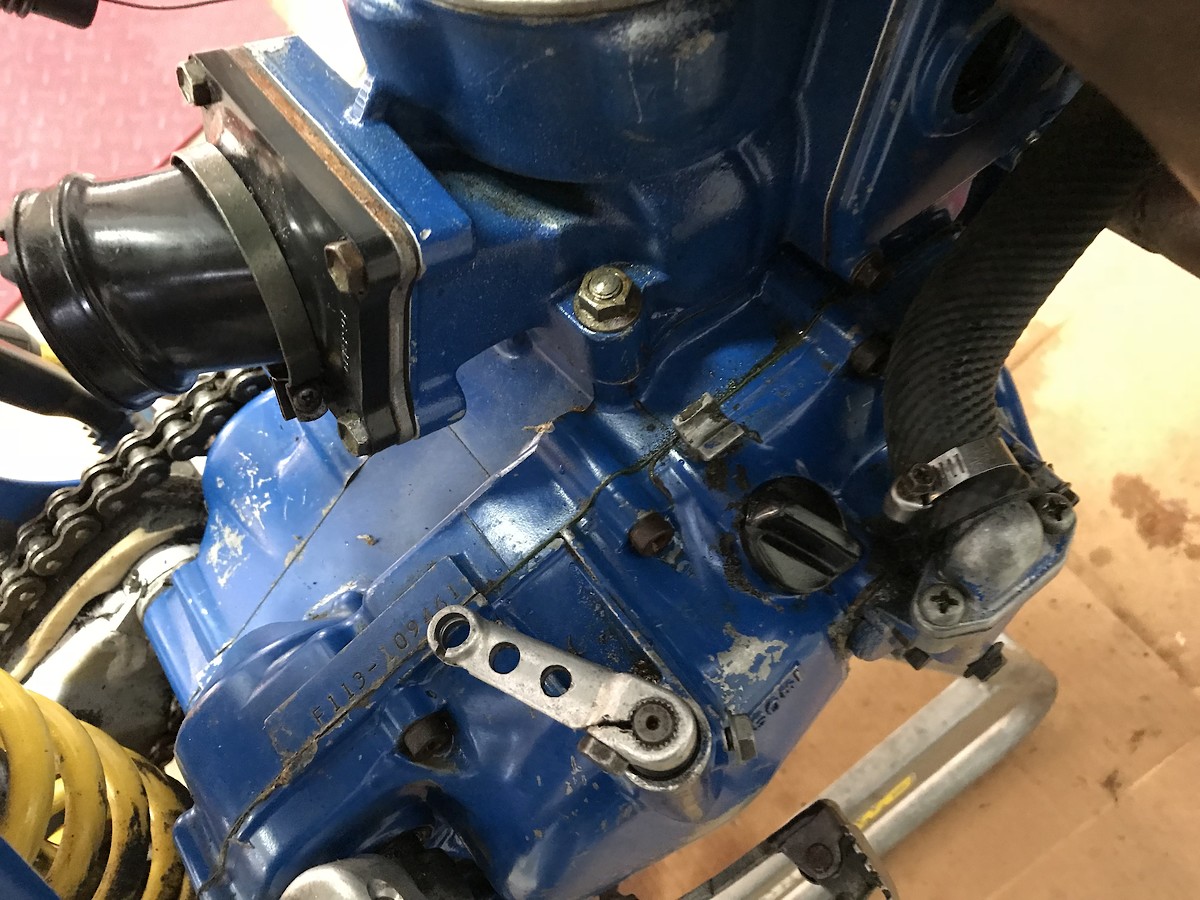

It will need a full engine rebuild...no coolant in the radiators....the P.O. Had the radiator overflow tube connected to the cylinder Powervalve vent! Genius! Photo

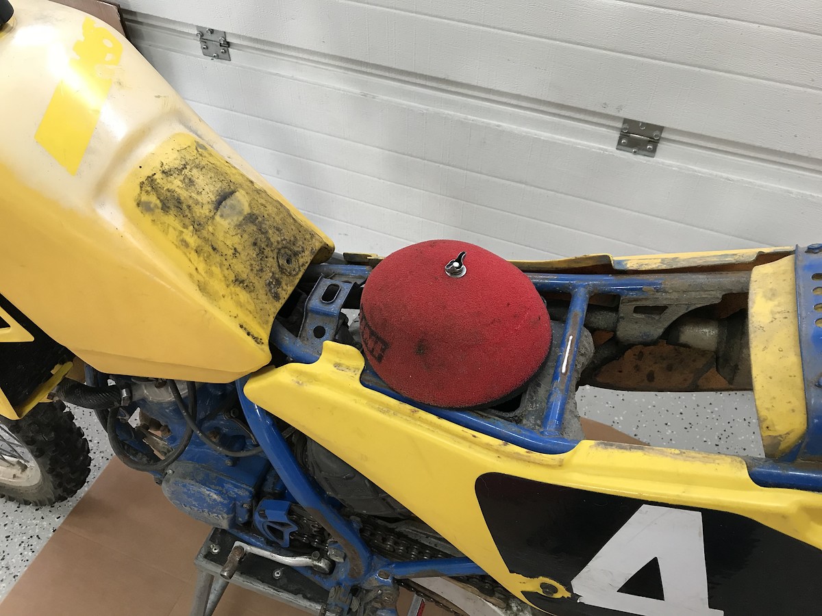

Wheel bearings are tight, chain buffer & rear guide still a lot of life left in them...even has the original lower chain roller! And what is this? An air filter....Shocking! Photo

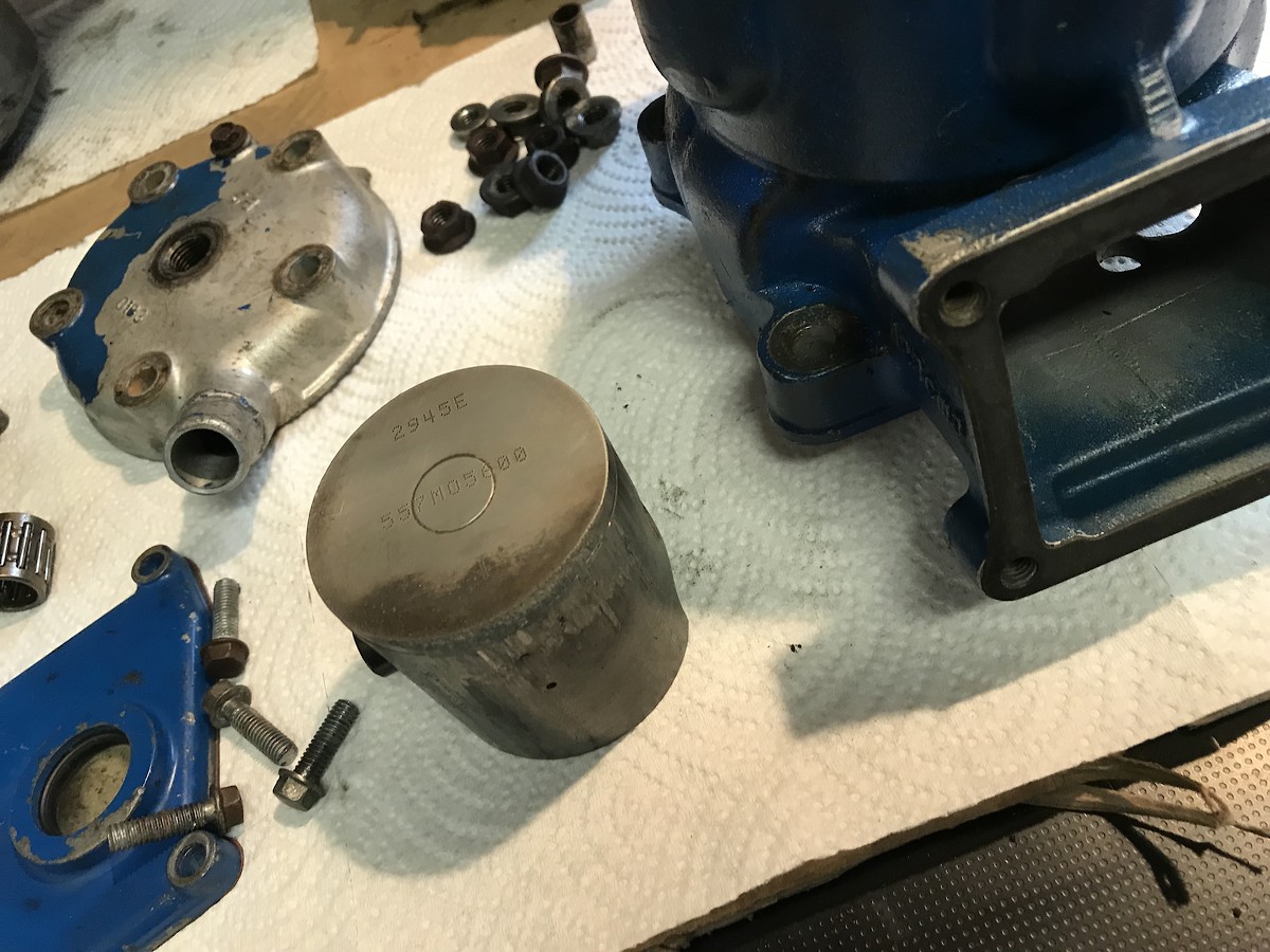

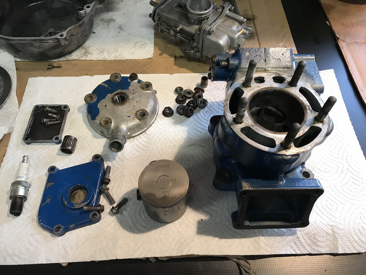

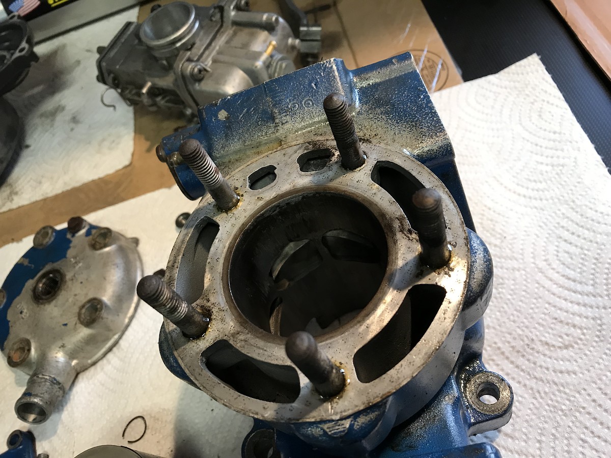

Now the bad....piston melted on exhaust side...no coolant...detonation....all the likely culprits... and of course the piston/cylinder on last overbore! But rod feels tight and Powervalves in good working condition... Photo

Crank bearings are a little loose, so full top & bottom rebuild required. Looks like it shares some parts with the 86 & 88 models....I”m going to take my time with this bike and attempt to graph the 88 RM250 tank/seat/ shrouds onto the bike as in the 88 Donny Schmidt GP bike...

I have noticed that places like power seal are starting to offer hard plating for steel bores. It's a little more expensive but not way more then an aluminium bore. Maybe something to look into if the bore isn't too out of spec.
2/13/2019 9:21 AM
SmokinJoe439 wrote:
I have noticed that places like power seal are starting to offer hard plating for steel bores. It's a little more expensive ...more
You are correct... My 88 RM 250 already had a sleeve installed when I tore it down, I sent it to Powersealusa & had them plate it as it was still on the standard bore....Options: 1. buy from eBay & get a junk cylinder, which I already have. 2. Buy new NOS from CMSL ...pricy &:shipping will add even more$ 3. Send my cylinder to Ken O’Conner racing and have the sleeve installed correctly..4. Be patient & wait for a usable cylinder to come up for sale.
I will b patient & teardown the rest of the engine & chassis...and see what other surprises exist...
2/13/2019 4:41 PM
Do they just use the nikisal on it? I have a couple of steel lined cylinders for my two stroke street bikes. I think maybe worth having done not to hijack your thread just i haven't known anyone who has done it yet. Might have this done on my 1986 Suzuki RG250 since they are still stock bore.

SmokinJoe439 wrote:
Do they just use the nikisal on it? I have a couple of steel lined cylinders for my two stroke street bikes. I think maybe ...more
Contact Powersealusa...in Pa. they have a good web site, that mentions preserving old rare cylinders with their plating process. Send them an email, they respond. My brother has an RG500, we rebuilt it 2 years ago...4 rm125 pistons!

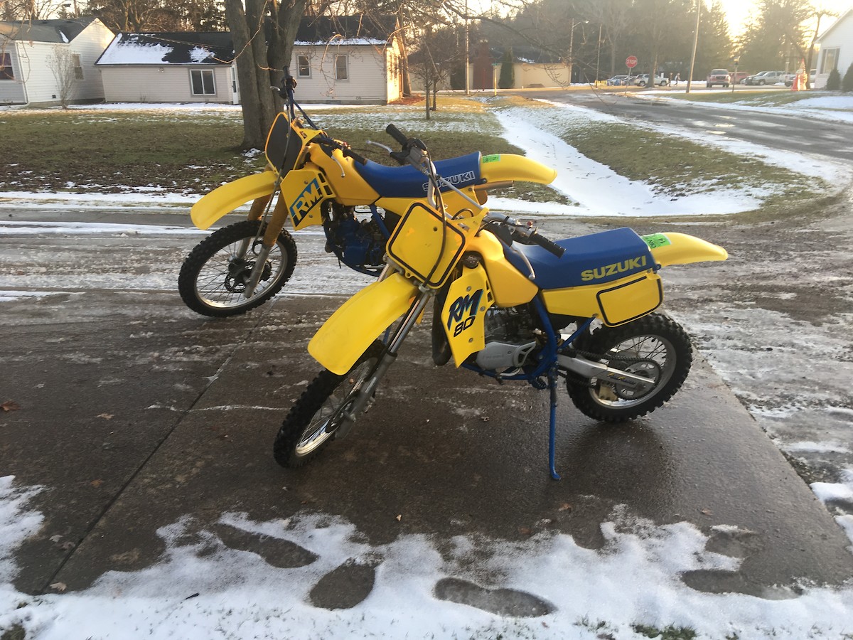

2/13/2019 8:44 PM
Sweet. Photo

Sweet. Photo
Sweet combo, I am looking to build an 88-90 RM-80 to go with our 125 & 250’s
