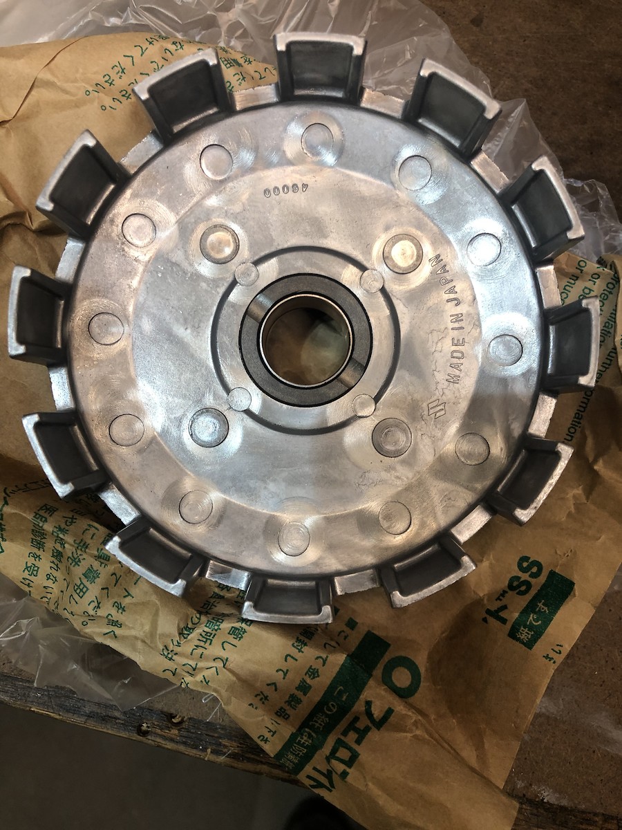

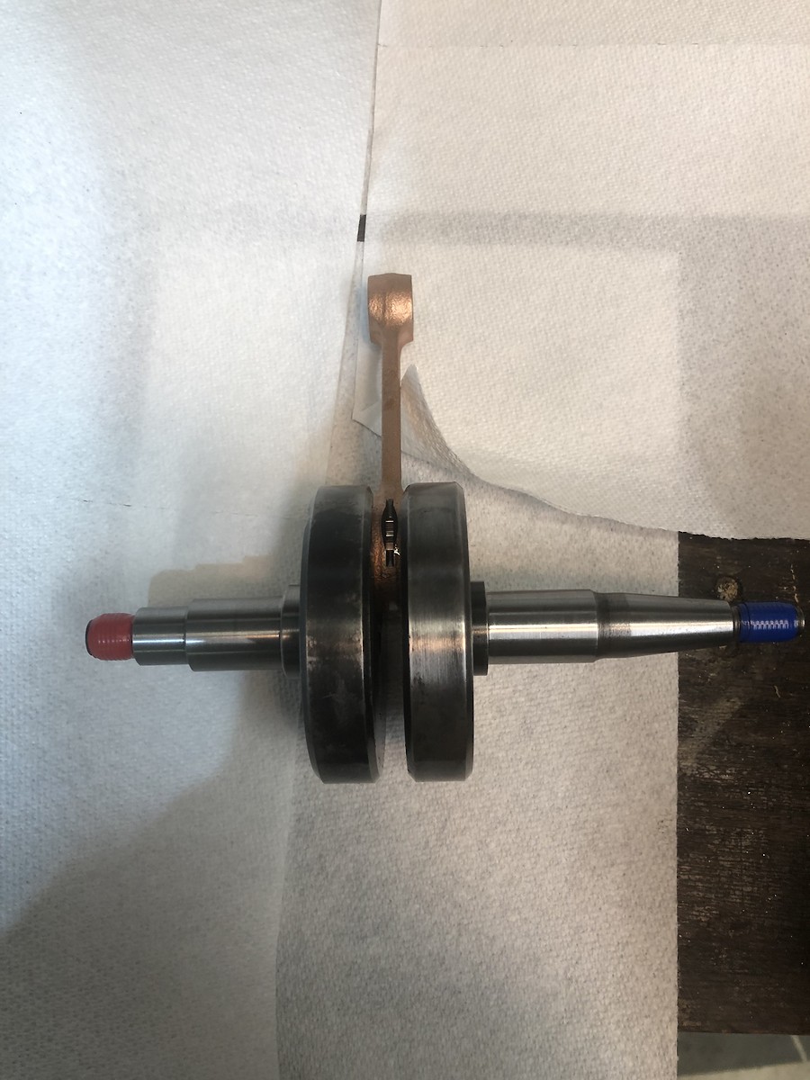

nos cranks
nos clutch baskets

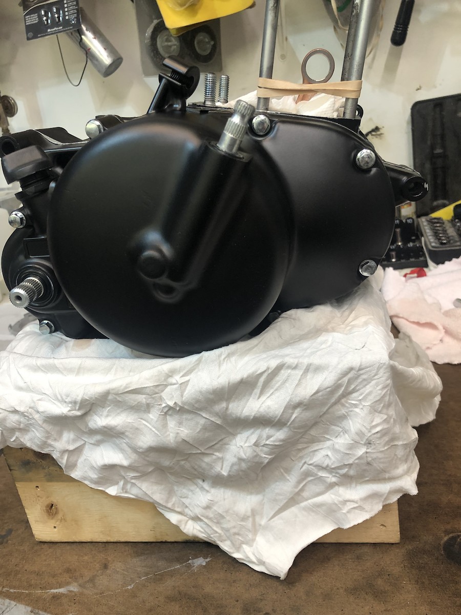

all new bearings/seals in case sets both engines are finished

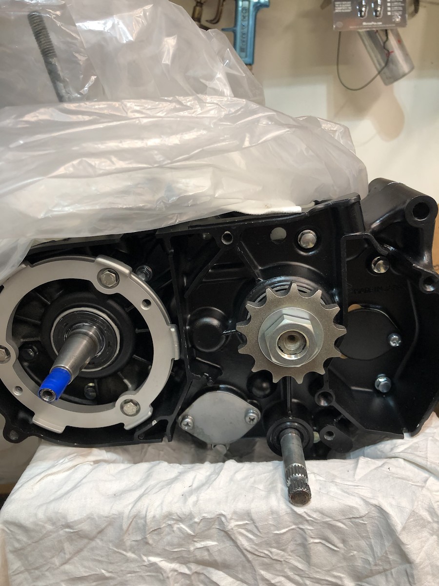

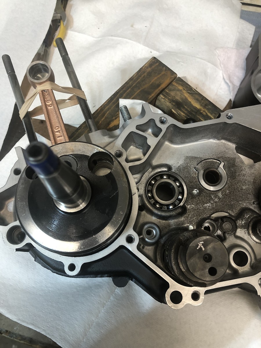

The case set on the 77B is totally different than the 78/79 set
5 speed engine
4 plate clutch basket
space by countershaft for a oil injection pump
crankshaft length on ignition side extension CDI spacer plate

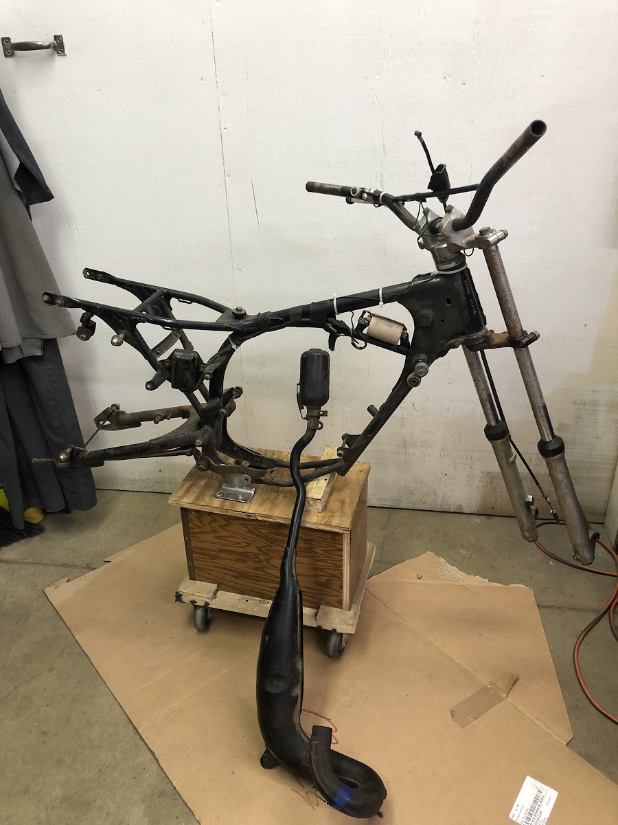

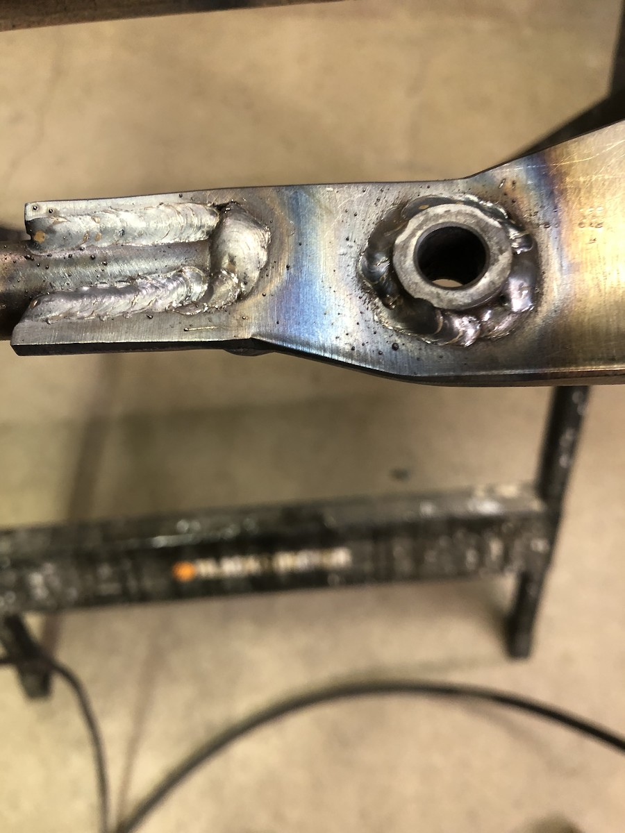

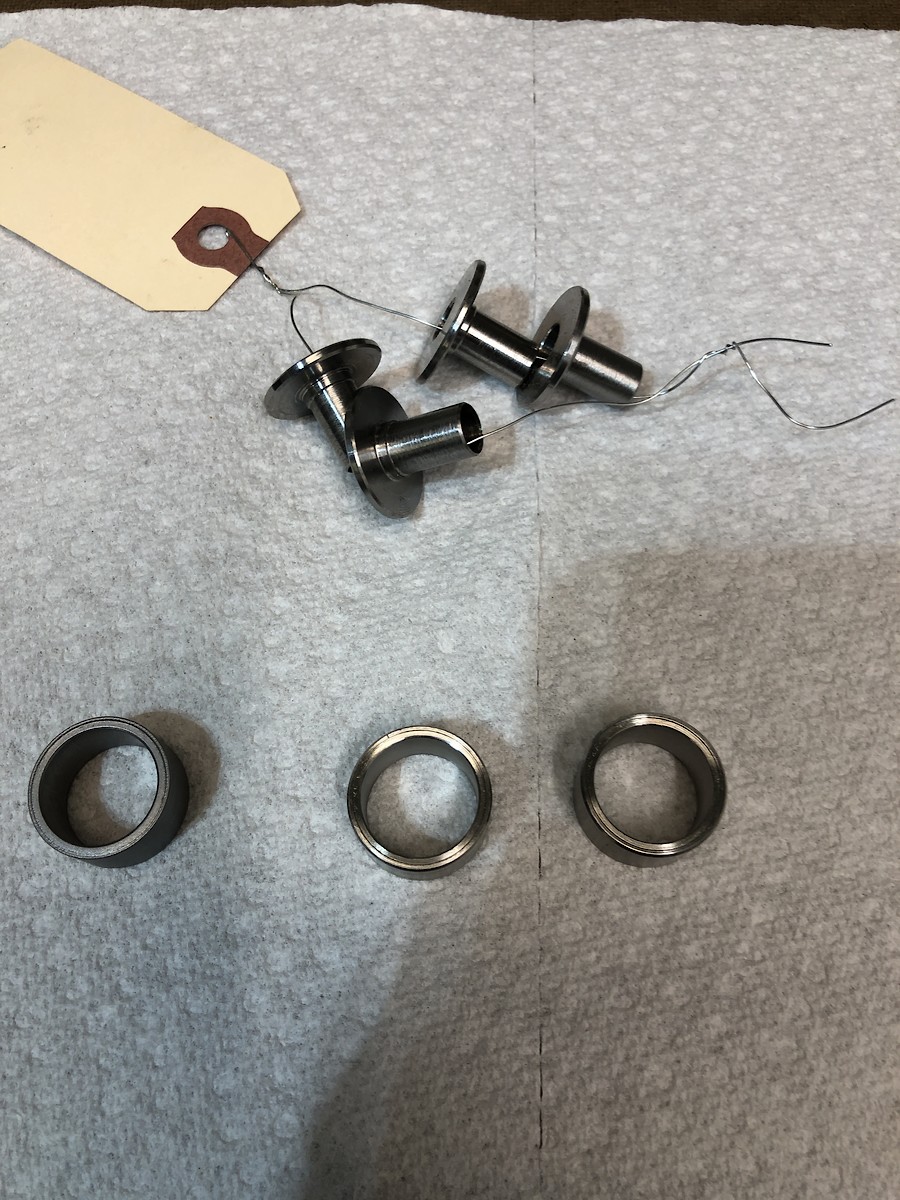

The frame engine mount holes on all the 76-78 RM's are way oversize vs the bolt/ case mount holes so fabricated these 17-4 ss bushings that press into the frames and have the correct i.d. for the bolts
The 78C countershaft spacer's are NLA so i made 17-4 ss replica's to replace the corroded stock left spacer

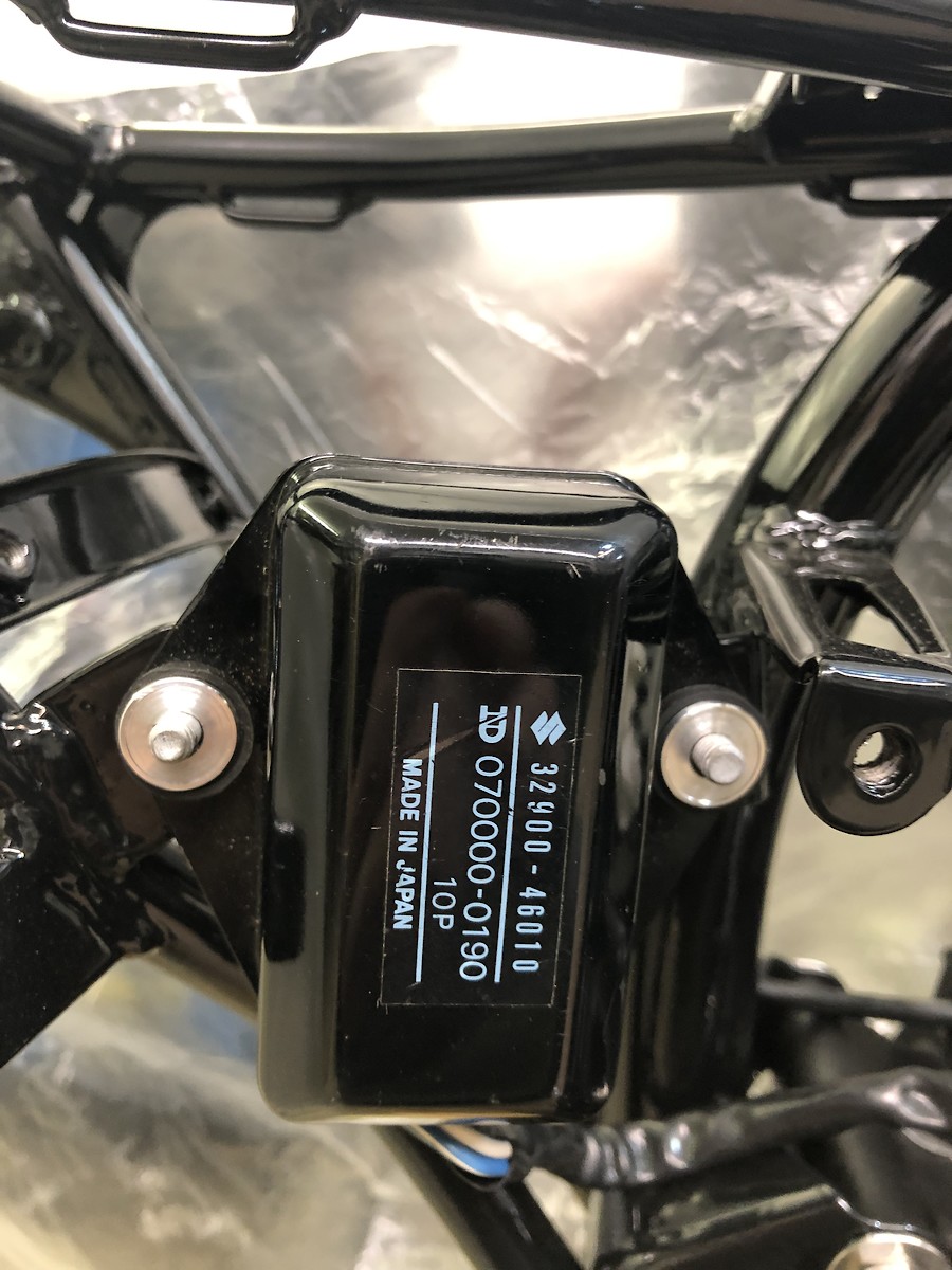

4/9/2022 10:02am
Relocated the CDI mounts from the 77 to the 78 location
Will be using triples on the 77 from the 78C
need the clearance

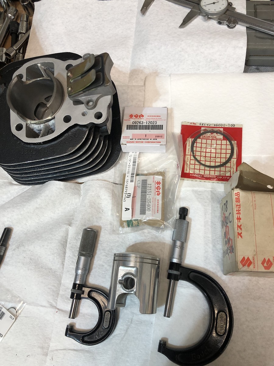

Lots of work ahead! Cylinders are bored(.02 over. .04 over) ported

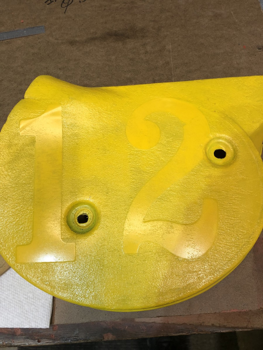

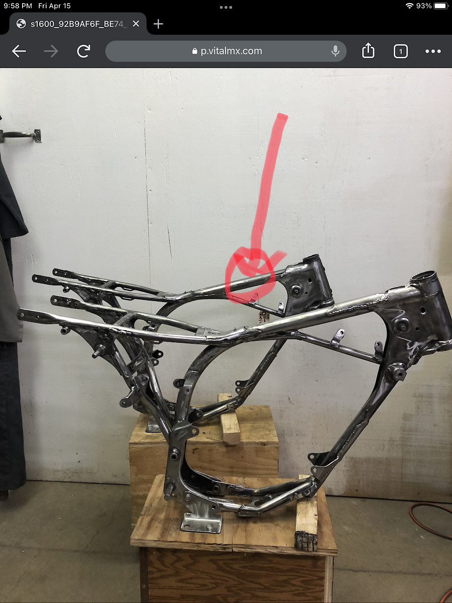

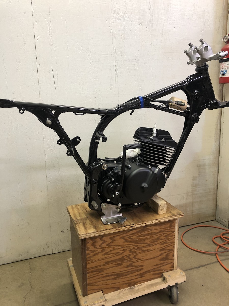

4/14/2022 8:16am Edited Date/Time 4/28/2022 10:30am

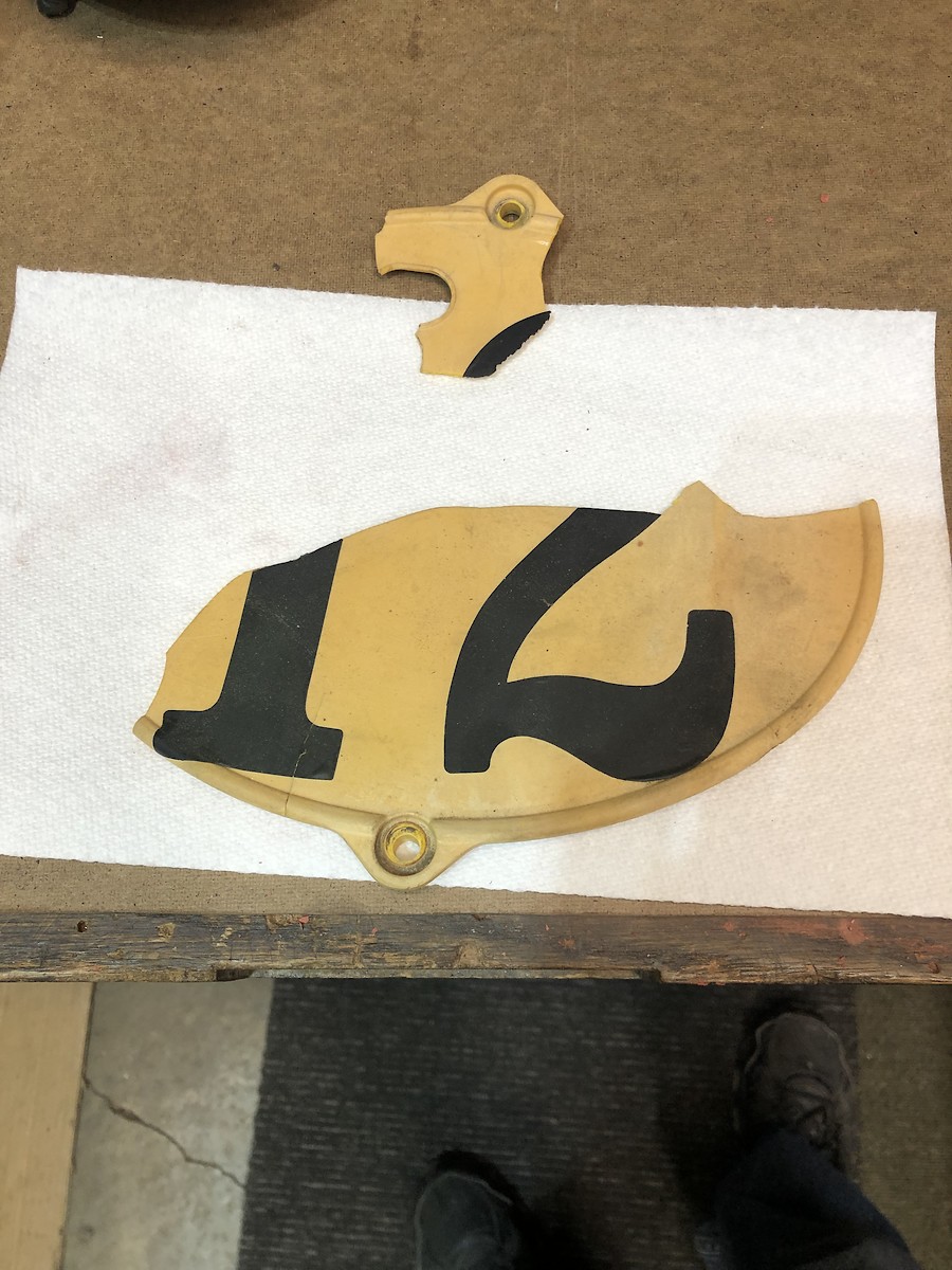

Cool, I see your number 12, one of 78C's I have here has the same #12 on it also from 78 ( rough shape, on side panels, broken front plate from D23 in 78

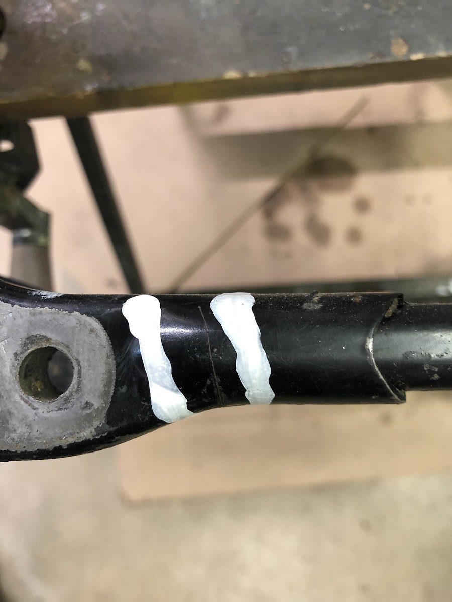

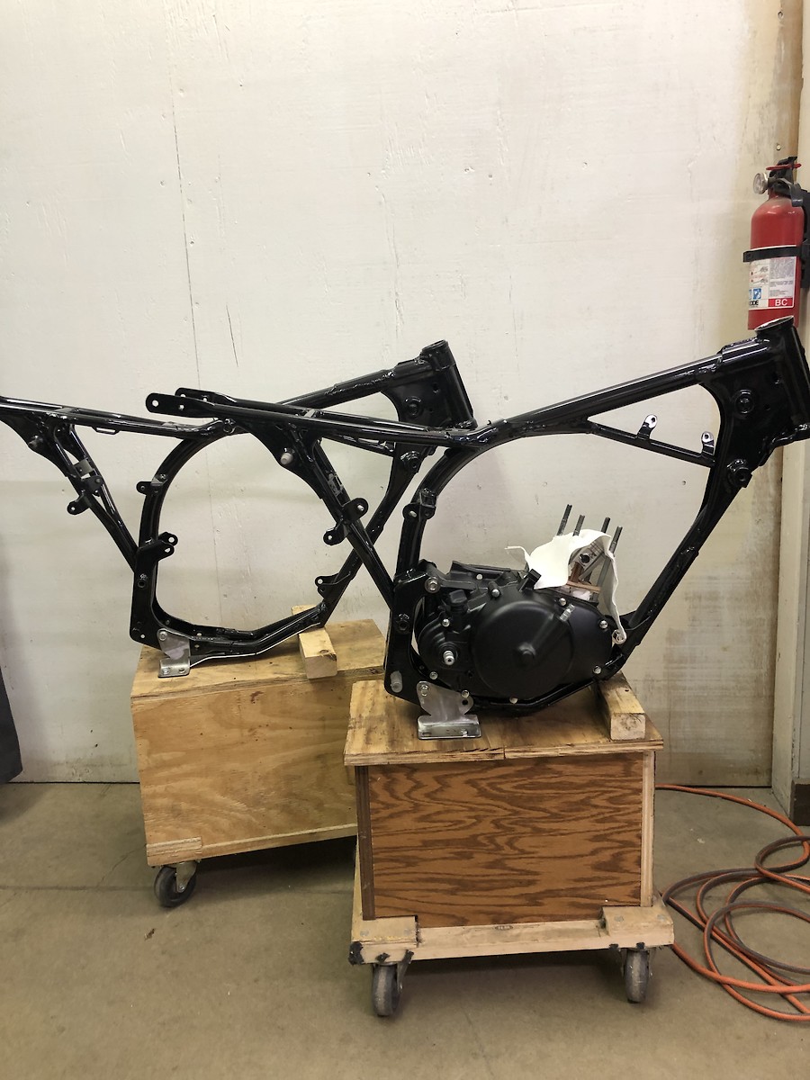

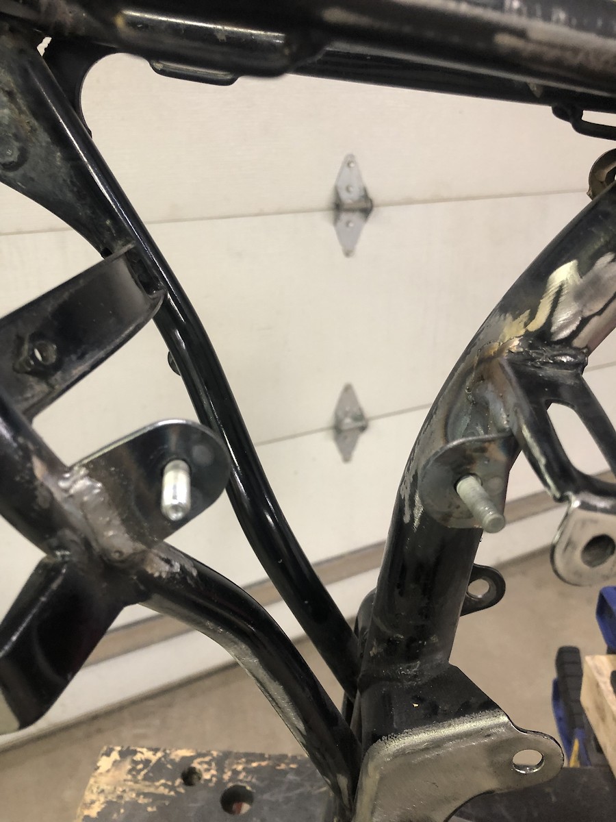

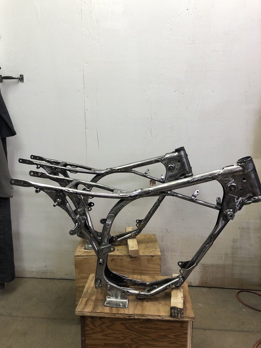

The 77 frame had 2 hairline cracks in lower frame cradle in same spot both sides, copied gussets from 78 and added to 77 per pic

4/15/2022 10:05pm
I am not sure which frame is which, but I remember breaking the frame right there in my 1978 RM80. Looks like you do great work👍
4/16/2022 8:39am
Both frames had cracks

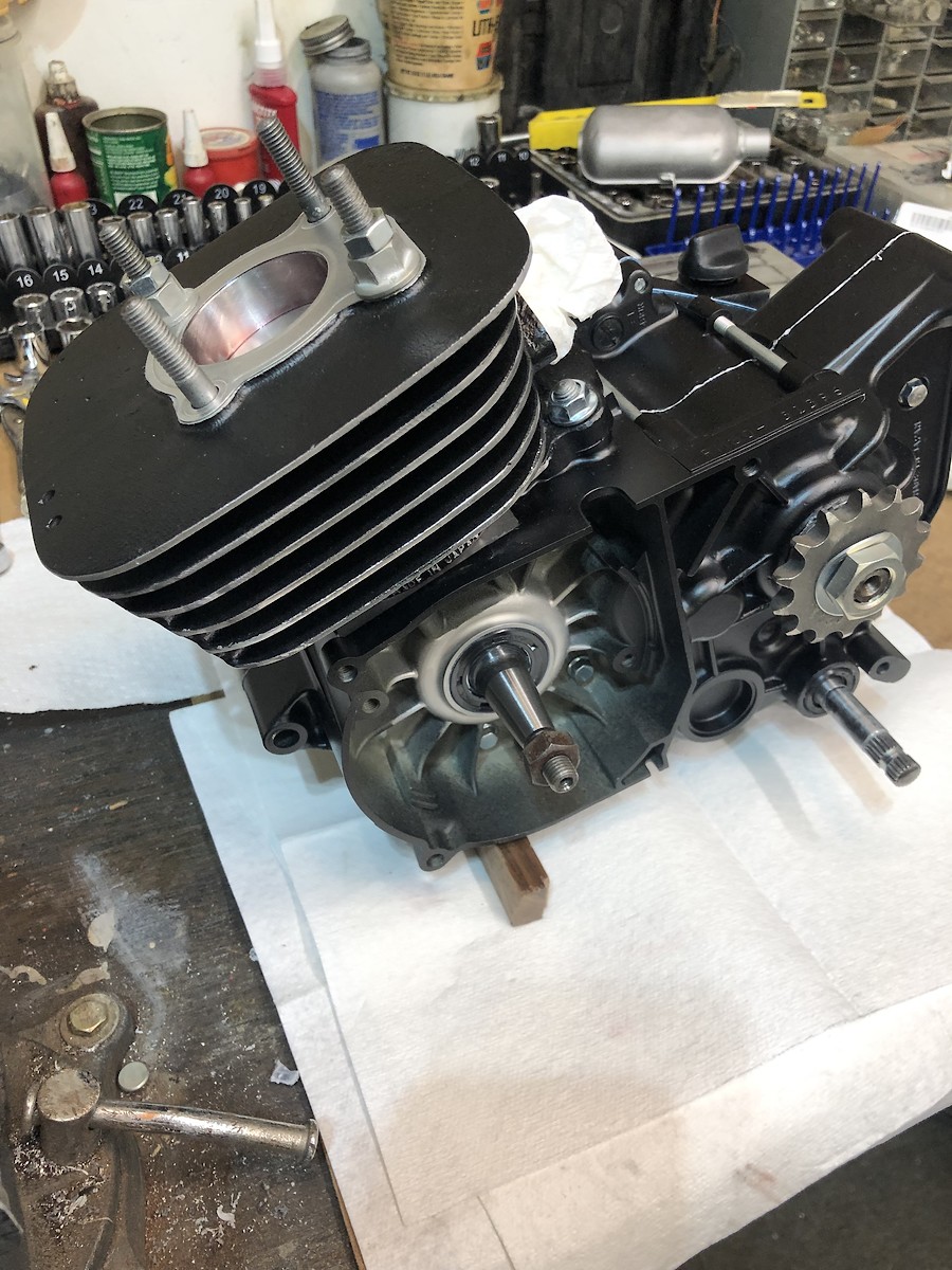

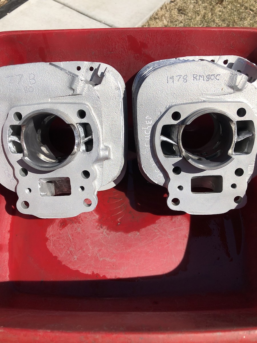

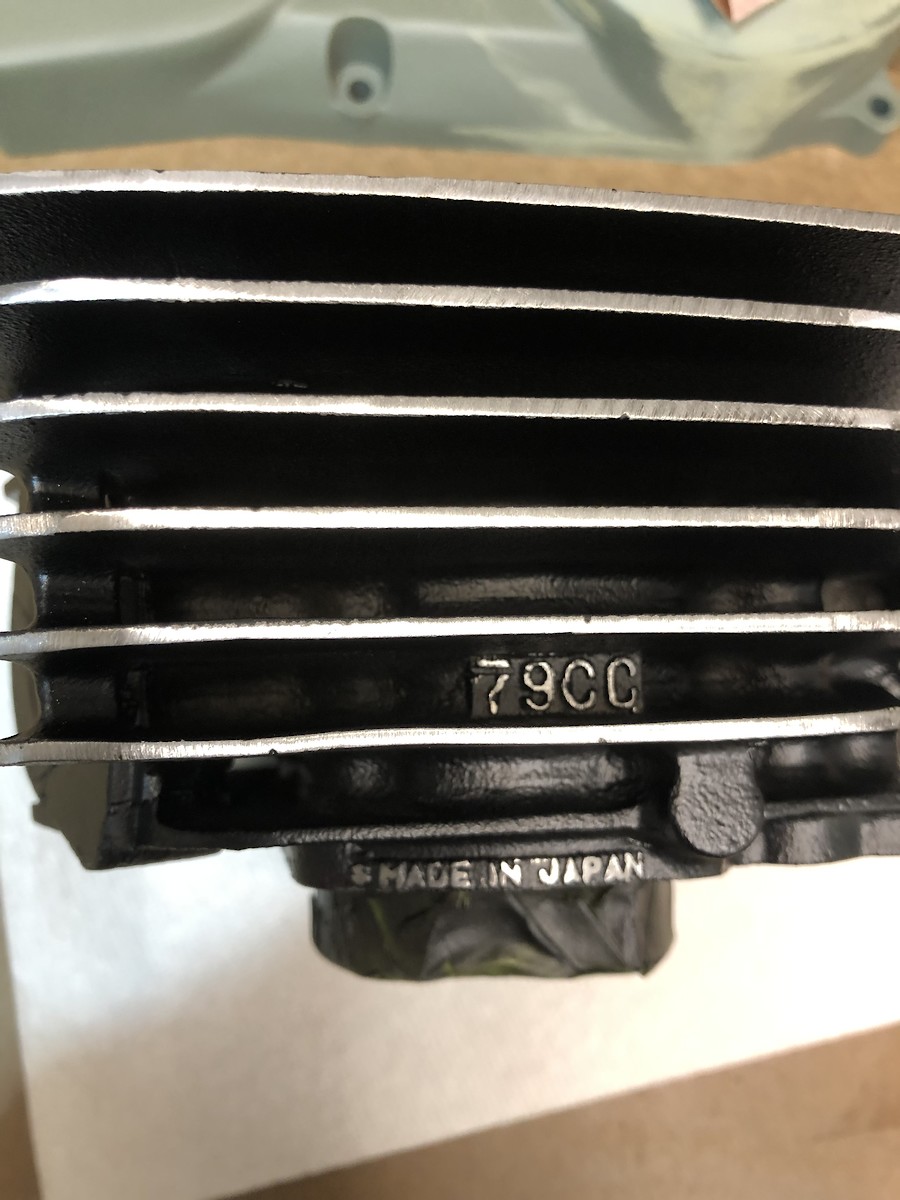

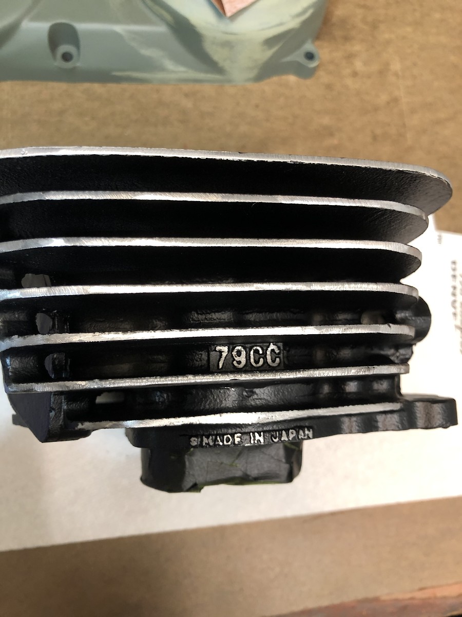

78 C jug casting, lots of mislabeled parts on the internet
The 78C, 79N castings no boss for oil port
10 mm holes for rear studs
80-81 8 mm holes
4/20/2022 8:59am
They share the same case set/ parts, even with the JR80, but the cylinder is 77 RM80 only
case is from a street bike

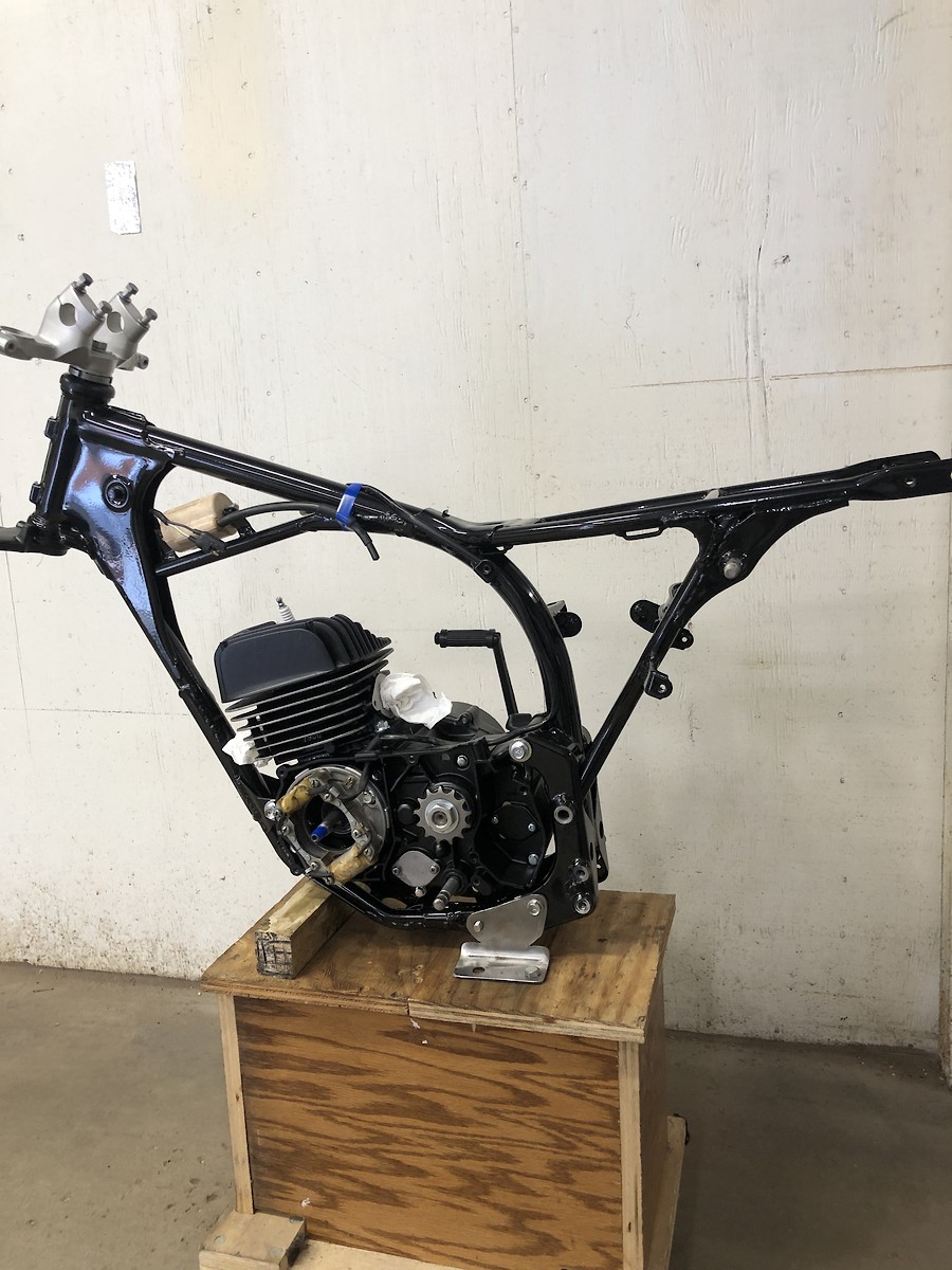

5/8/2022 8:45am

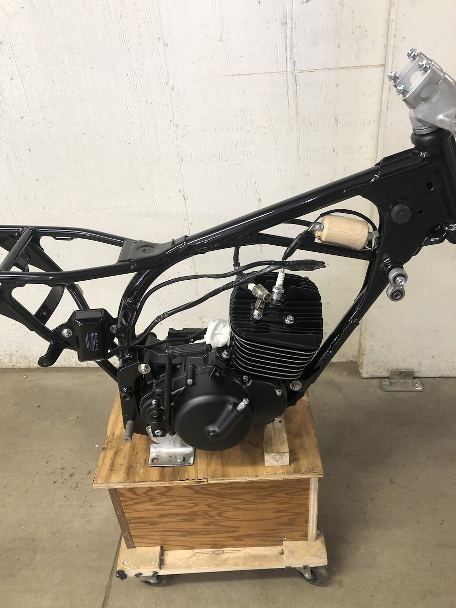

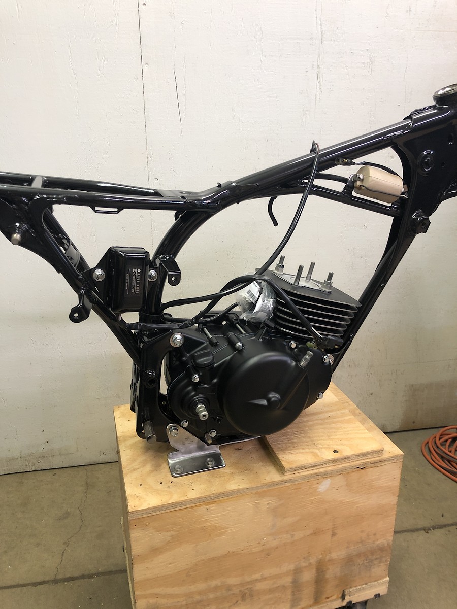

Custom machined bushings for the engine mounts
really tighten up the fit to the frame , single stage enamel on the frames.

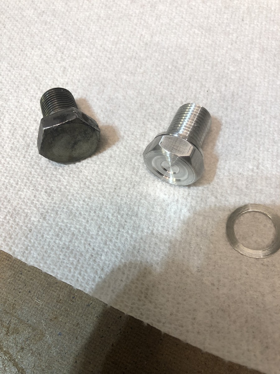

I will be replacing most of the steel hardware with aluminum/ ti handmade bits
billet aluminum drain plug/ aluminum crush washer

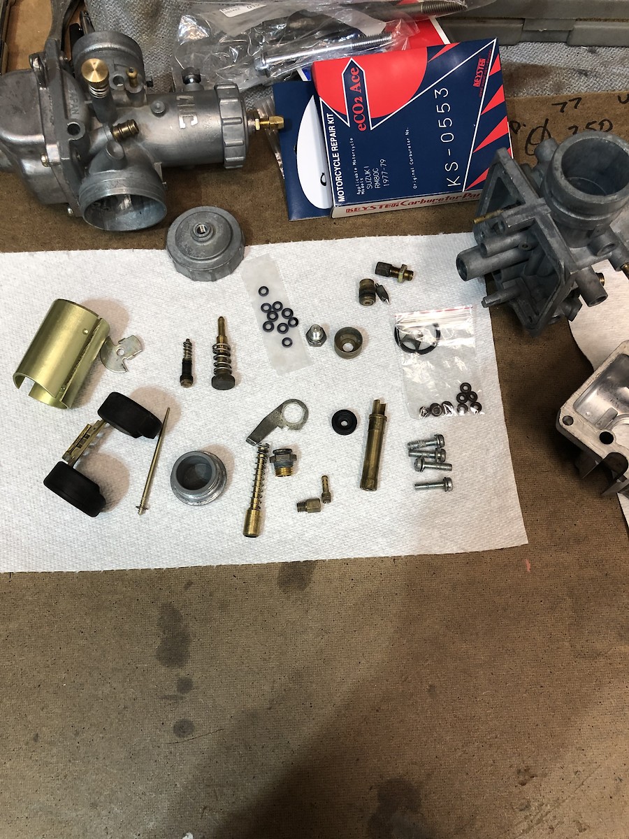

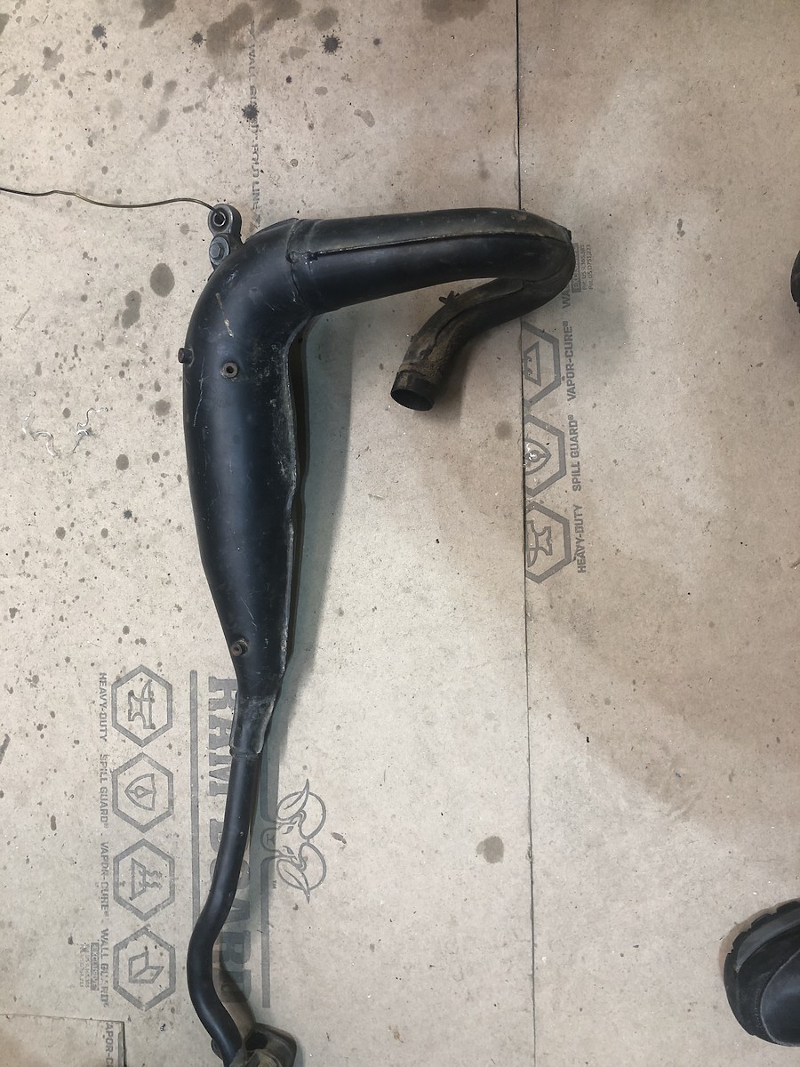

5/28/2022 3:45pm

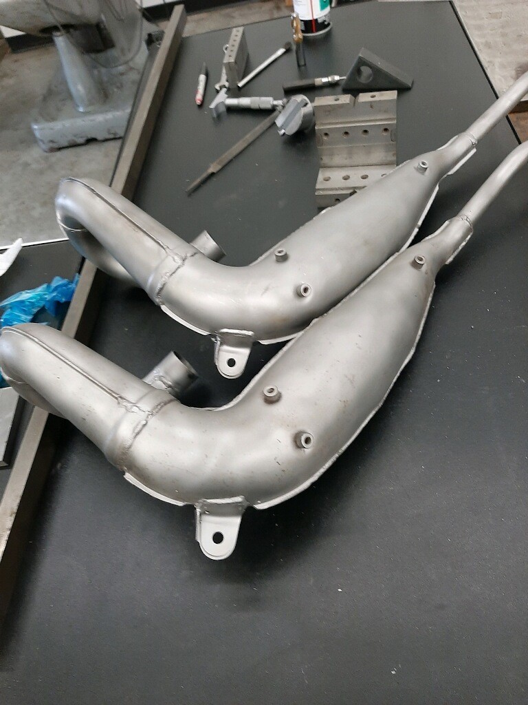

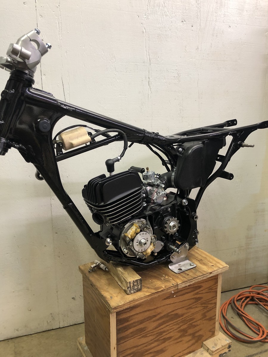

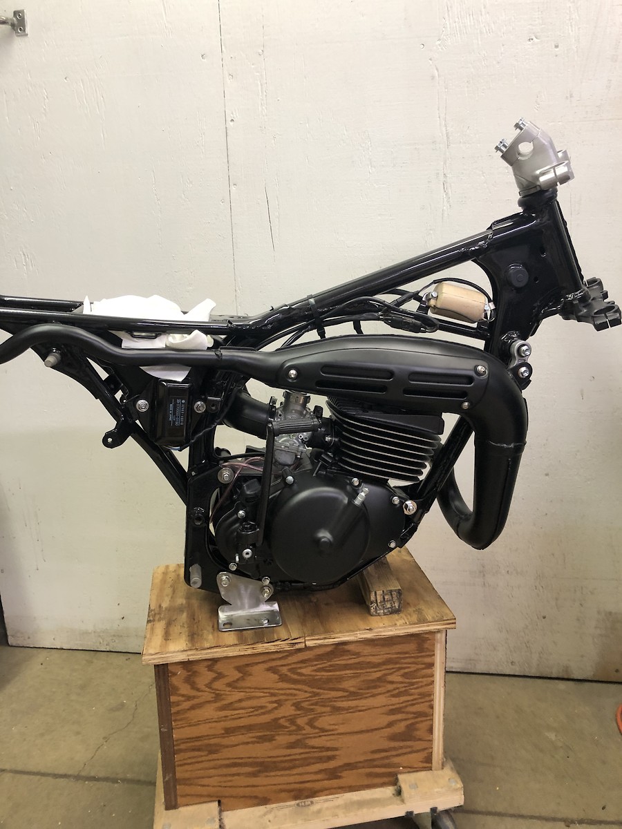

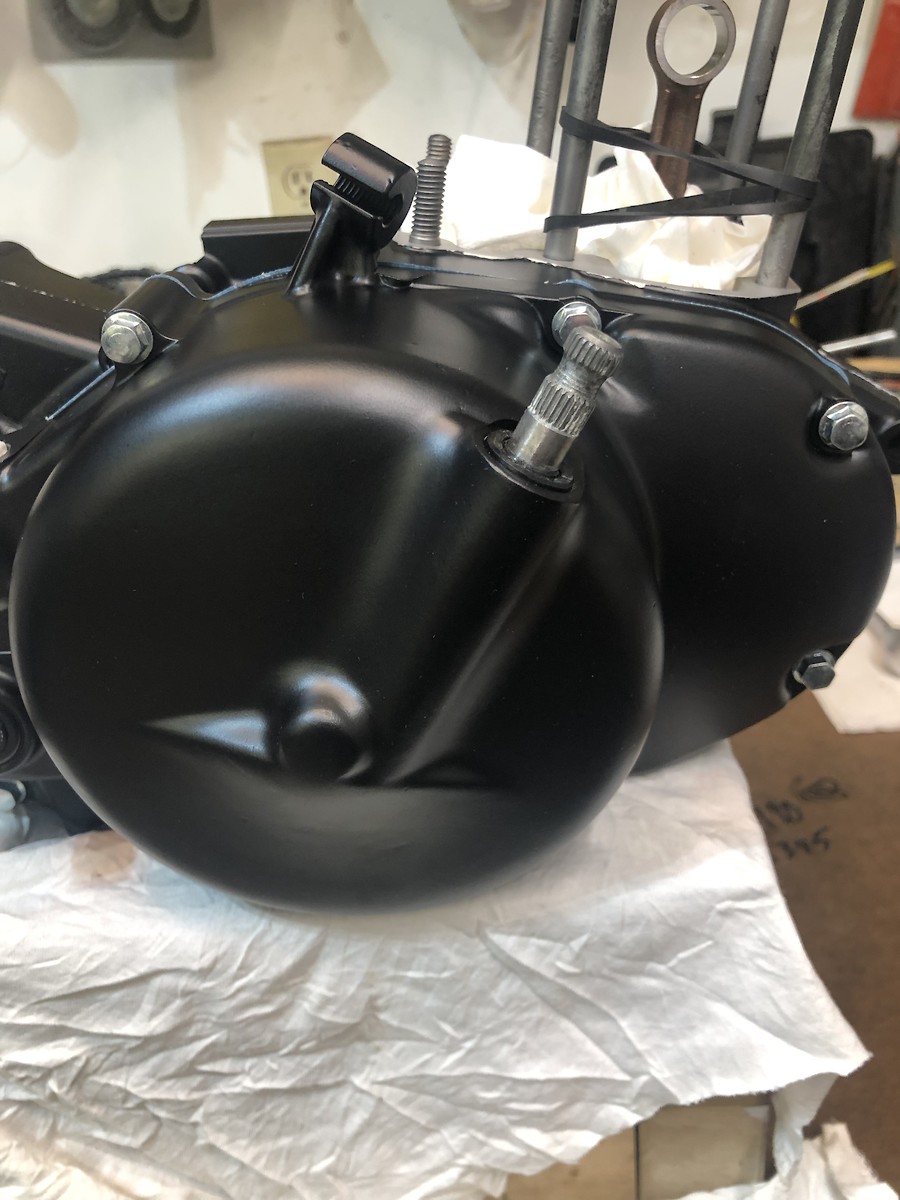

More progress on the B, new carb, pipe is ready to bolt on
Will get the engine in one of the 78C , and similar progress , 28 mm carbs on the C where in great shape , just carb kits
