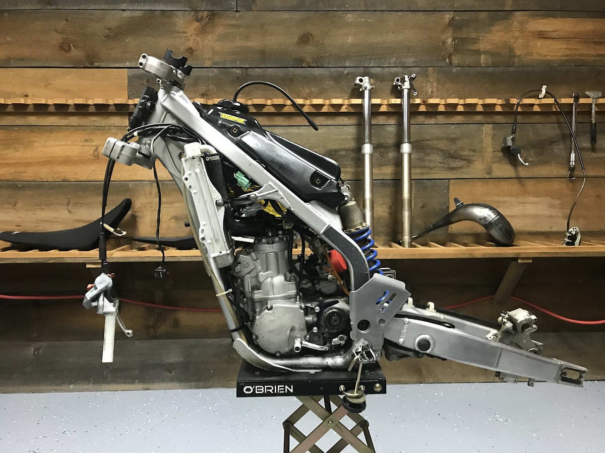

Started pulling it apart last night to clean it and check over everything. Everything has been good so far just dirty, I always dread pulling the linkage off used bikes.... ugh I'll update Monday afternoon or so.

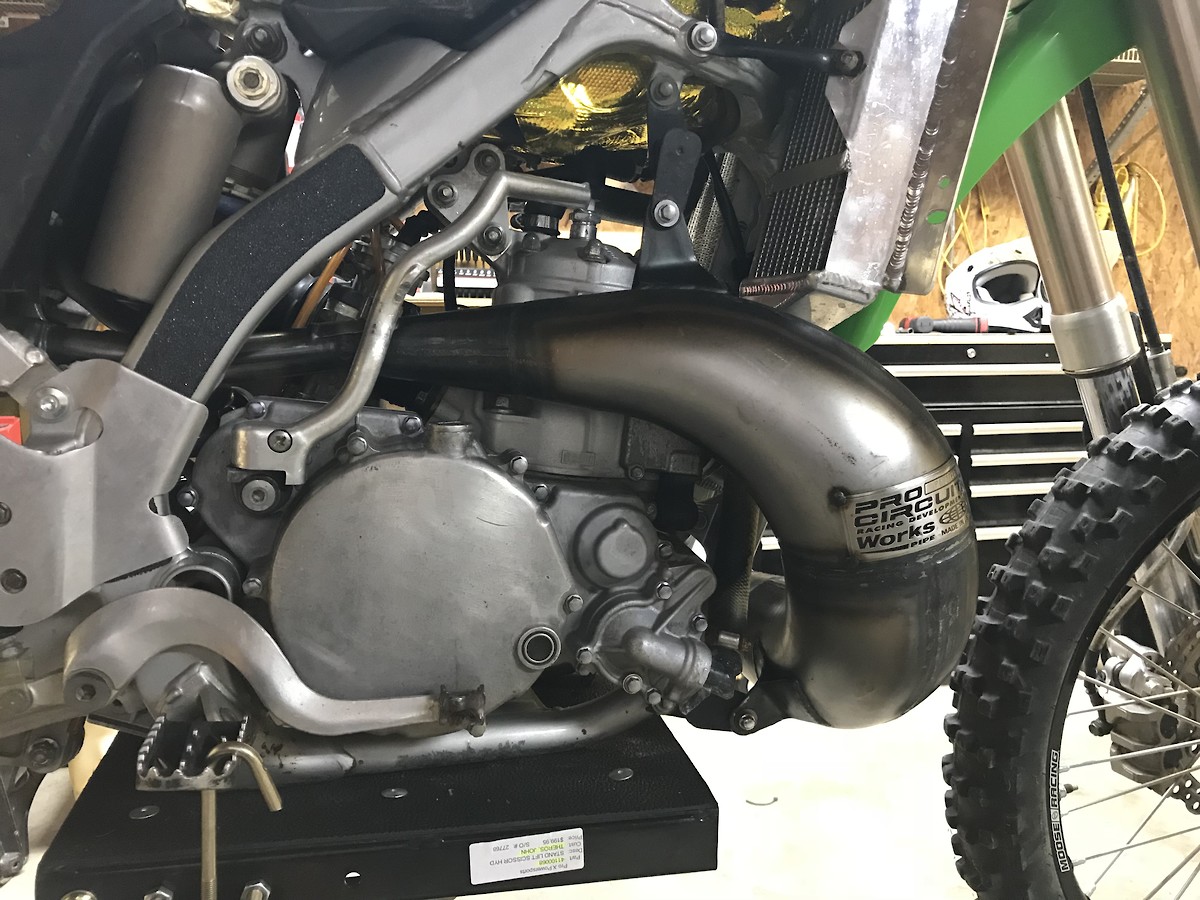

Should I stick with FMF stuff or go with Pro Cicuit on the exhaust? I've always had PC and tried the bills but.... idk maybe try DEP. What do you guys think?Photo
7/15/2017 10:41 AM
Nice pick up!! Love our 05. We run an FMF and it runs awesome. Don't forget to run race gas also! They love c12 at 40:1

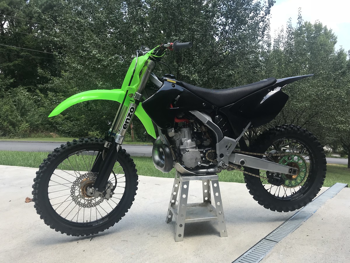

Been a hot minute since an update, but like I said it’s pocket change so it’s gonna take some time.
For a little bit I was out riding in the woods with the bike while I had the opportunity so it vaulted ny build but now I’m back on it
Ended up with a pc pipe and silencer, and got some
Wc frame guards from one of the vital members.

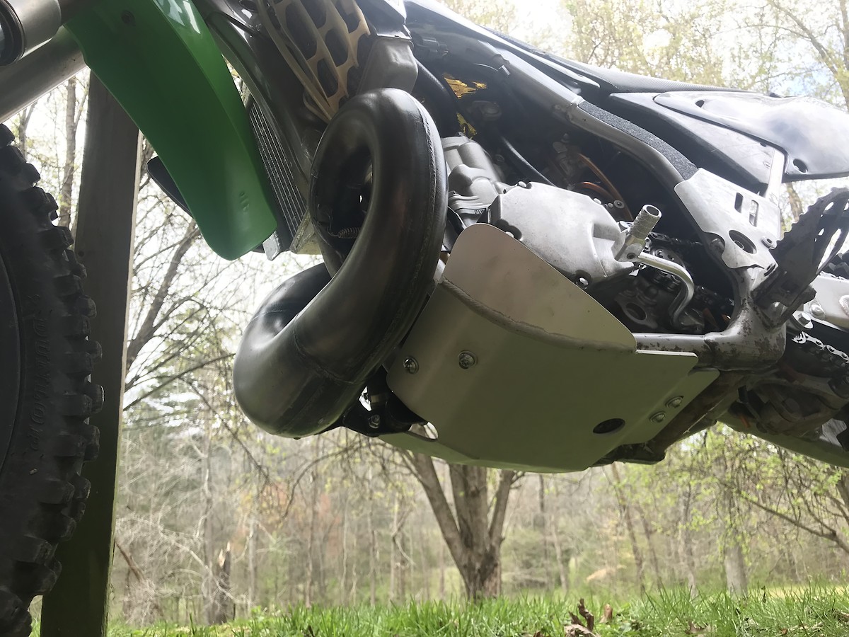

Then I had to pack everything up and move because we sold our house. Now we are in our new house and I was able to get a few more things done. I added a moose skid plate since it was really rocky where I was living in between houses and just wanted to ride. Photo
I really just wanted some water pump protection.

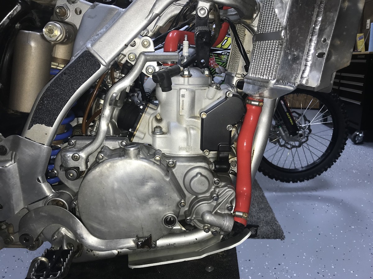

Once I got my shop set up at the new house I tore it down and replaced steering stem bearings, fork seals, linkage bearings, wheel bearings, a couple spokes, the standard seat was replaced with an SDG, and I slapped on some tires, a cheap set of radiator hoses, painted my rad lovers black with high temp paint, and upgraded the plastics a little. I still have some work to do like OS front brake, stainless lines, and I’m really really wanting to find some PSF1 forks off the 13-14 Kx450f at a decent price.
All in all I think it looks good as a naked bike and it’s probably gonna match the 450 once I get graphics for it.
I’ll update when I can guys thanks for tuning in! Photo

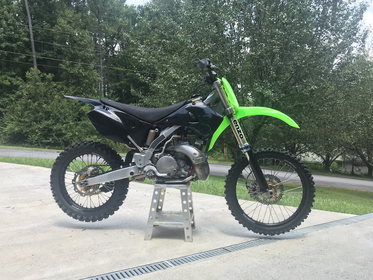

The air forks came in today, now it’s about finding the right set of clamps. Good news is these came with the WC ez fill caps! Also got a really good deal on factory fatty and shorty from some old stock at a local dealer.
If anyone has a good set of 14 up Kx450f clamps that would be awesome! Photo

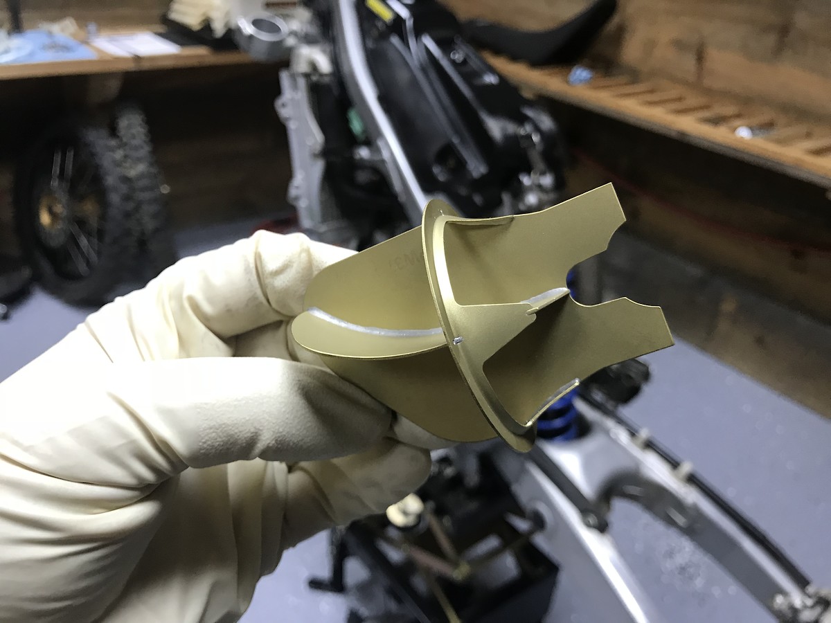

Also had the worlds gnarliest swing arm bolt, that has been at the machine shop for removal, it was so seized and rusted over that they were burning through drill bits and ended up having to cut it out Photo
I’ll post a pic of the plug they put in with the new bolt as well.
