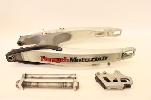

I just bought a 2009 yz250f swingarm to put on my 2004 yz250, I read on another thread something about having to mod and/or the frame to get the newer style linkage to fit.I'm just seeing if anyone here knows anything about the swap to a steel frame. I got a 09 swingarm, complete linkage, and 25mm axle on the way. I also plan on getting an 09 hub. Also will a complete brake setup (master cylinder, caliper, caliper mount) from the newer 2009-2019 4-strokes bolt onto my yz250 2stroke?

I have seen a steel frame 2 stroke with a 09+ 4 stroke arm, it was an old thread. He said something about the bolt that connects the linkage to the frame was smaller, so in order for me to use the 09+ 4 stroke link I would have to make some kind of sleeve's to fill in the gap between the bolt and frame. I also read if I use my stock linkage it will bolt up, but sit a little low.

Got the swingarm today, cleaned up great very happy with it. I got the 09 swingarm, linkage, axle, blocks, and brake mount for $215. Now all I need is the hub bearings/seals, and spacers... i think? Lol. I also plan on switching to tubliss and installing the lightest tire I can find.
