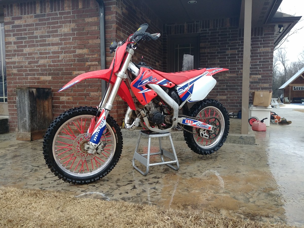

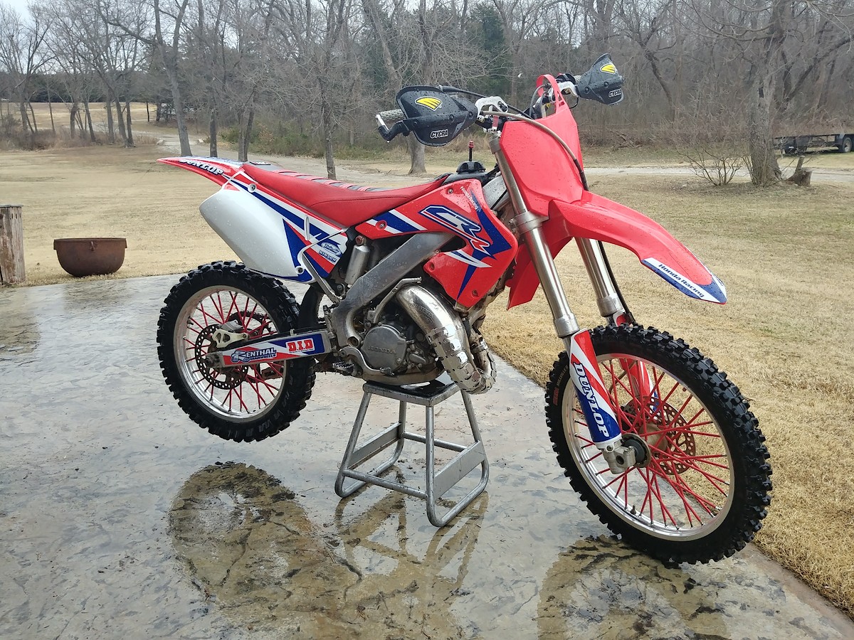

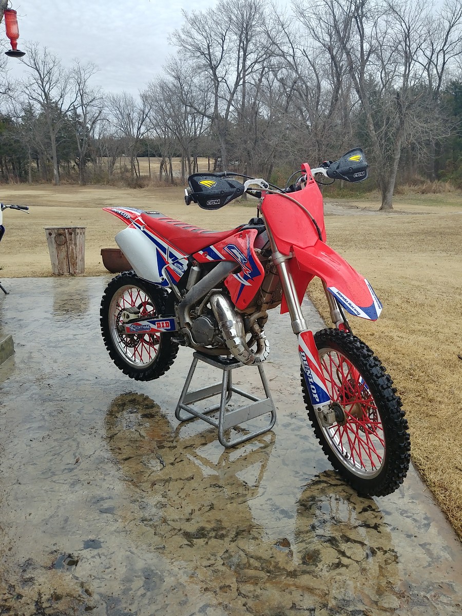

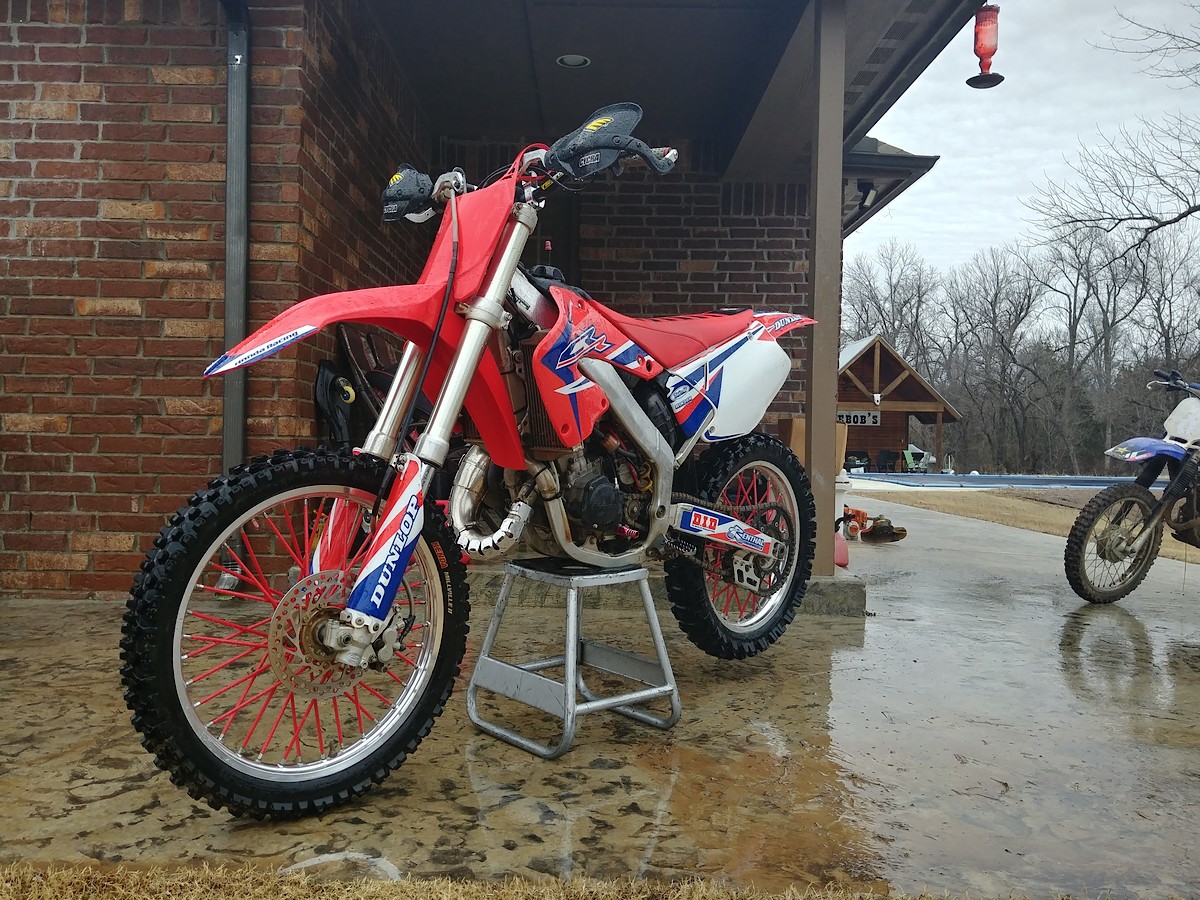

Whats up VMX... so for the past year I've had this bit of a project bike that I've been working on, its an 01 CR-125 as you can tell by the title. My original plan was to build it for more of a motocross scene, and in January I broke my CB, I cased a double and it threw me over the bars. After that I've decided to move towards more of an enduro scene, I had just got the CR before I broke my collarbone, and I didn't want to sell for a 250 4T or 250 2T, so working with what I had... I began this build. I didn't take many pictures along the way due to it being spread throughout the year, but recently I finally splurged and bought the last bit of stuff I wanted for the bike minus a 3.1 gal tank, that can wait. When I first got the bike she was making pretty low compression, and I could work on my bike all day, but troubleshooting is not my strong area, so I send her into the local K&N Yamaha, man those guys know what they are doing, I've never been disappointed in any of their work. Turned out the piston was shot, the cylinder is a little worn, and the power valve linkage wasn't even hooked up! So they threw a new piston in there, and now it's making about 140psi, still 40psi under but it still rips, at some point before this upcoming race season I will throw a new cylinder in there, but I got the motor running good, and I started to work towards making it more woods ready (Pipe Guard, Hand Guards, Moose Torque Spacer, Skid Plate (not made yet), etc.) Spent 6 hours in the shop a couple days ago getting her cleaned up, running the swingarm and frame with scotch brite and mothers polish, and here is my final product! What are your opinions on it? anything else you'd recommend for a 125 woods bike?
