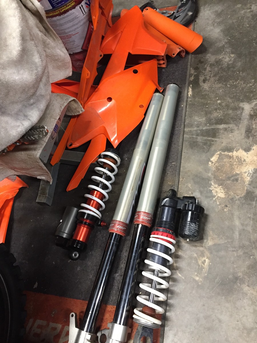

I found two great deals (imo), 2016 CV spring forks for $2.2k and a set of 2017 öhlins forks + shock for $3k. Can not decide... One way would be to get the Öhlins inserts via RG3 however after setting them up with the Swedish supplier it will end up costing between $1.8-2.5k anyways, however he does offer great support from what my friends tell me.
If you plan on staying on KTMs for multiple years, get a depressed set of forks. You can take them over to your new bike and sell the 4cs ya know. I have CVs I use on my 125 and 250f. Best $2,000 I've spent on my bike. The forks have more wear obviously now after 2 years, but I could prob sell them tomorrow for $1,800+.

Thanks for the input Carlino, I will stay on KTM's for atleast 3 years so a good set of forks would be nice. However I am on the AER forks and not the 4CS, my three bikes before my current one had 4CS forks and I never got 100% comfortable on them. I was really happy with the AER's when I first changed to them but I feel like they restrict me in some parts of every track that a "better" fork would not, four of my friends have gone from AER's to something else, one to CV Spring forks, two to Öhlins inserts and the last one with the WP spring conversion (which I do not recommend at all after trying it). They all say they can go quite a bit faster in the rough parts which I struggle with.
I have messaged a couple of retailers in Sweden about both the CV spring forks and the Öhlins inserts, would be nice to test them beforehand tho.
