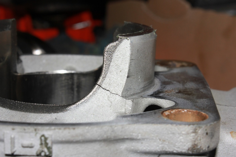

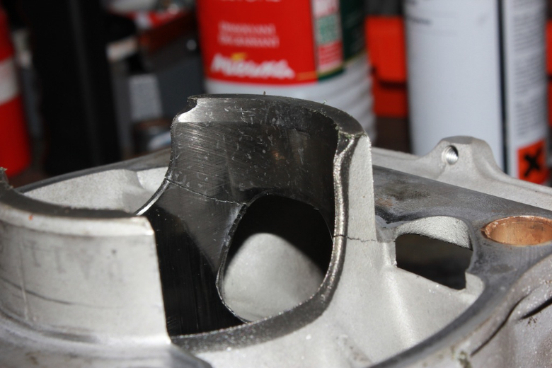

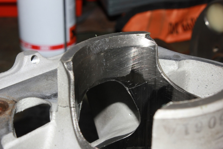

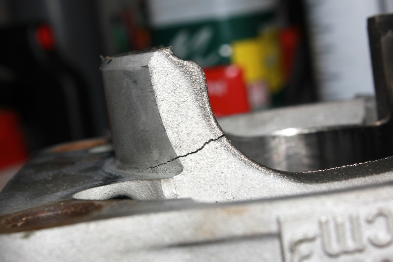

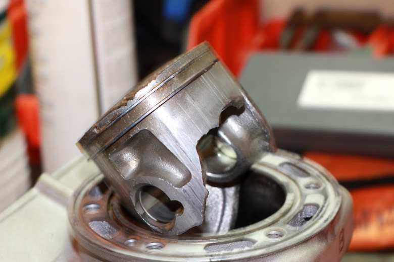

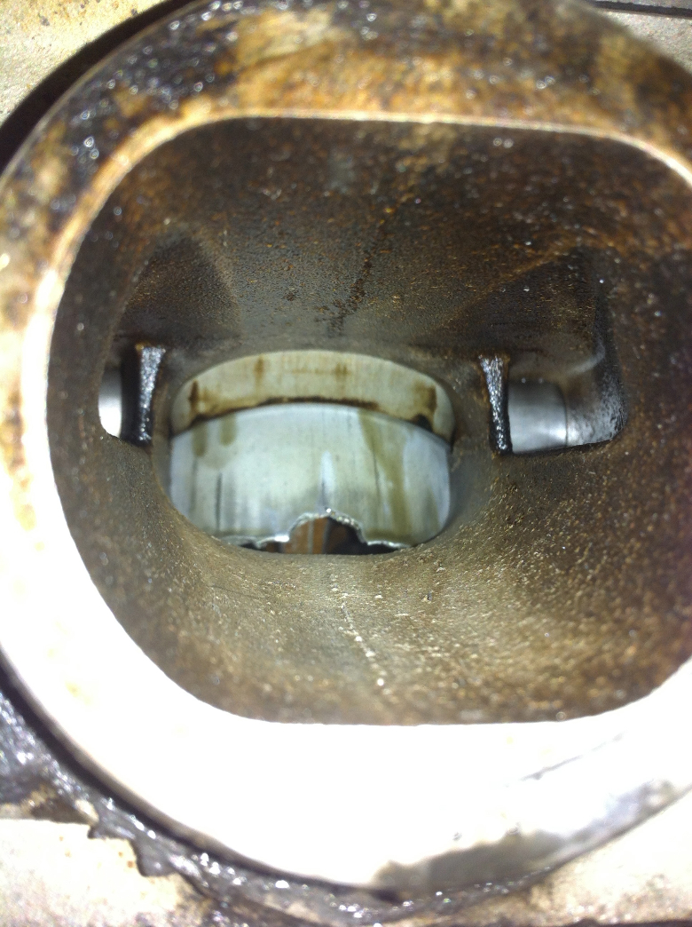

While stripping down exhaust for reinflating it, I had a quick look inside exhaust transfer just to check piston and cylinder.

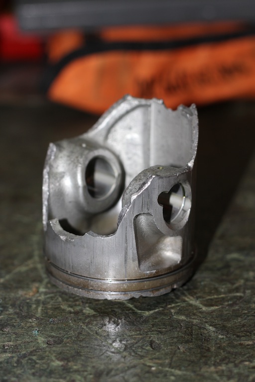

Ouch, as you can see, the poor boy was so old that it began to biodegrade....
I knew it was time to strip down engine for replacement of piston, rod, bearings, nikasil, etc...
I found a good deal on Ebay for a Wiseco crank kit, brand new cylinder with piston and gaskets so these old parts will soon join the Dead Parts room which is unfortunately way bigger than trophy room...
In the end, this bike will cost probably the same cost as a used 2007 250 YZ at normal price but good point is that I ll be sure of engine's health.
I heard bad things about Wiseco cranks, I have already purchased it, hope it won't blew the new motor.
However, I am still surprised that bike ran still pretty well since piston was nearly atomized and cylinder cracked.... Is it something usual on 250 zingers ?

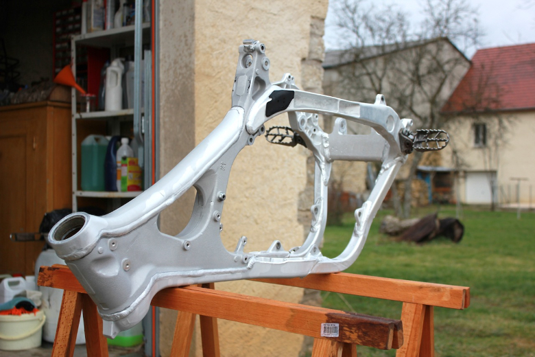

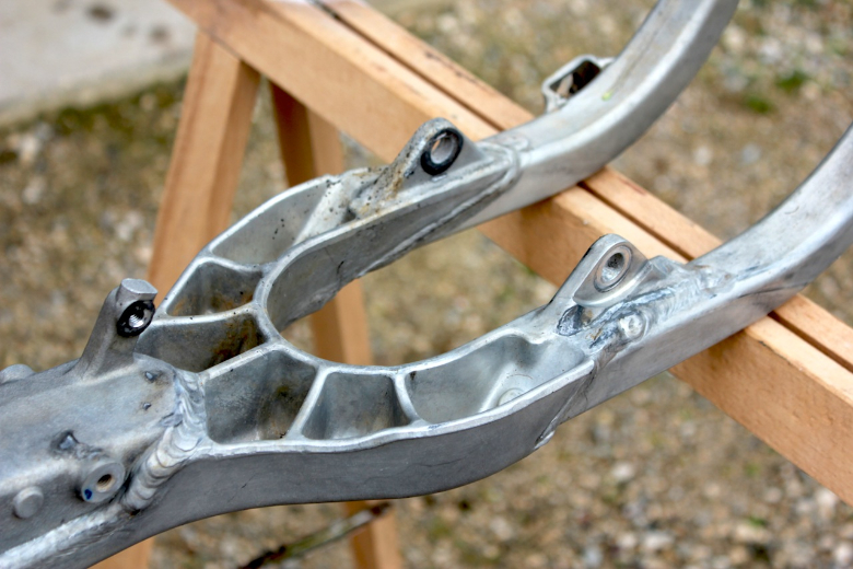

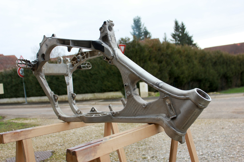

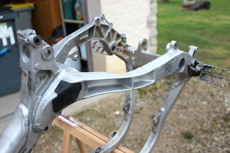

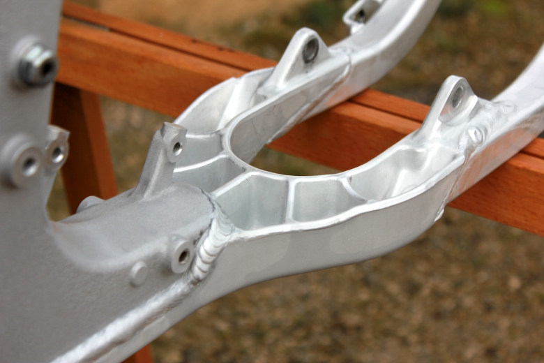

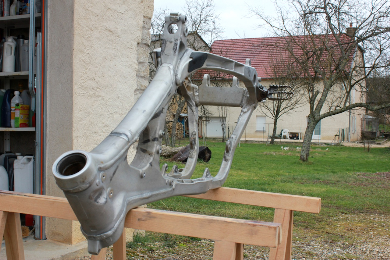

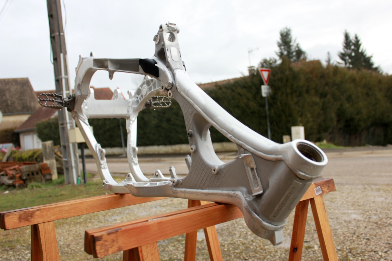

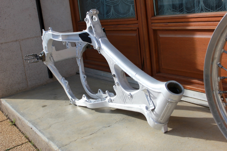

I decided to wash my frame this morning, it was a lil bit dirty and I wanted to give him a fresh aspect.
Tried to brush it and then soda blast but result was not great so I used an phosphoric acid based cleaner originally destined to industry, I was quite amazed by the result. The aluminium frame is like brand new.

I definitely think that cylinder was cracked and piston freshly broken when I purchased the bike. I am still wondering how the bike even started with a engine so damaged...

You may have pieces of the piston in the pipe and/or silencer, it would be worth making sure that wasn't the case.

Looks like that piston was in so long it started cracking (common if not replaced on schedule) and that cracked the cylinder

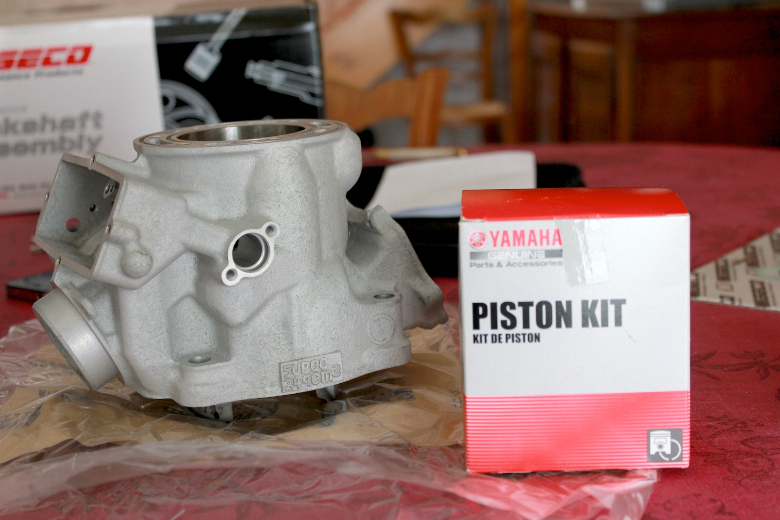

Finally got my fresh parts this morning !
I received the OEM brand new cylinder with piston kit. As you can see further back on picture, I have also received my Wiseco crank kit, I'm still considering selling it and putting a new rod in my old stock crank. I heard too much bad stories about it for taking the risk to blow everything after a couple of rides... On the other hand, a friend who is bike mechanic has installed lots of Wiseco cranks and rods reported me today that he never heard cases of failures...
