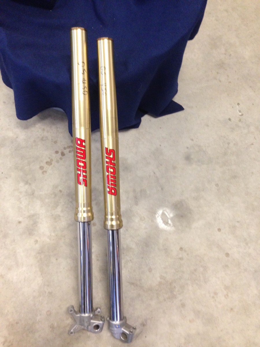

Pick up a Showa rear shock off a 2006 crf250
Going to have it rebuilt adding pro circuit hard anodized rear shock kit and the right spring for the kids weight

Got the Showa suspension back from being serviced and sprung for my sons weight

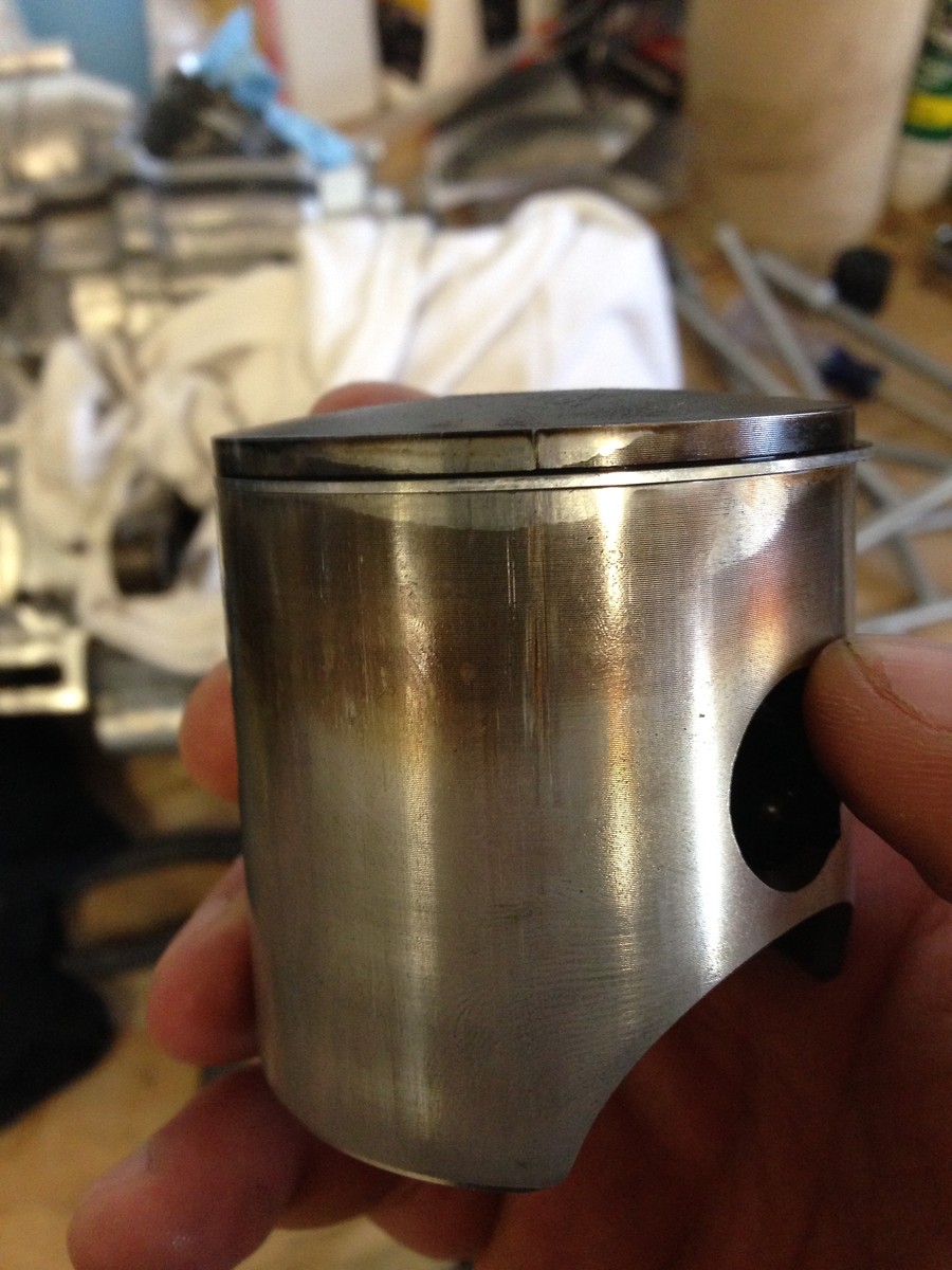

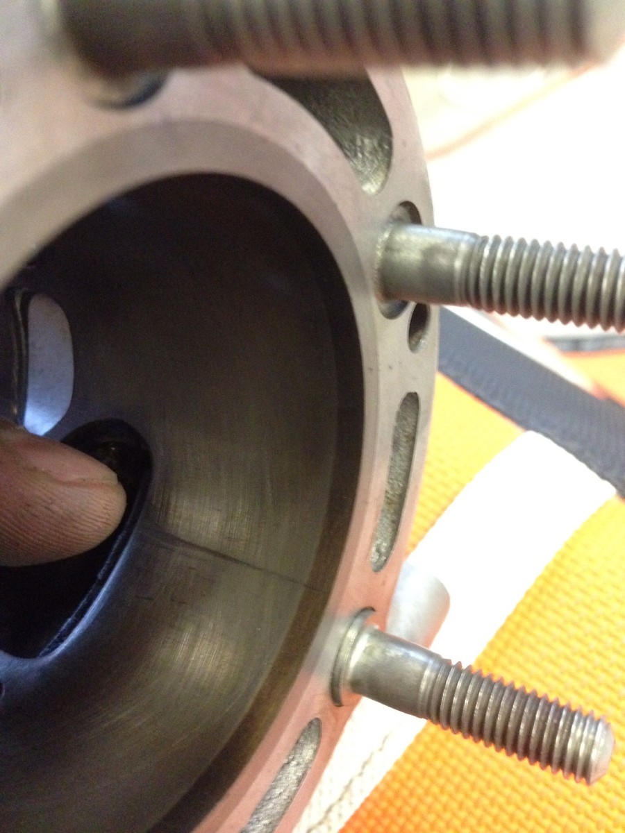

I think the piston looks ok and cylinder has a small groove that you can barely feel when you run your fingernail over it. I think I can get away running a flex hone through it.
I should be done with the rebuilt of the motor tomorrow just need to figure out what piston ring gap should be.
