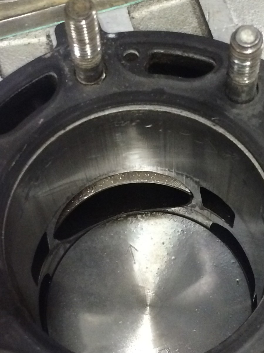

I got the bike down to my friends house and we took the head and cylinder off to find this...the nikasil is completely worn through to the aluminum so now I have to send the cylinder out to PowerSeal USA to get NikaSealed.

That piston looks brand new. I have never used Powerseal but Millennium has a deal right now where you can get %25 off in stock wiseco top ends if you send in the cylinder for nikasil replate.. Make save you a few $.

3/12/2015 9:48am
Thank you for the info! They didn't tell me that on the phone when I spoke with them yesterday. I'll have to look in to that. The piston is a brand new B piston from Vertex.

3/12/2015 9:52am

That's a shame. You cannot reuse it after you replate the cylinder. Have them match it to a new wiseco

3/12/2015 9:55am Edited Date/Time 3/12/2015 9:56am
When I spoke to PowerSeal they said they could replace the cylinder to fit the new piston??

3/12/2015 9:58am Edited Date/Time 3/12/2015 9:59am

A NEW piston. Not the new one in the engine already. You ran that piston in a cylinder that needed replated therefor it's probably no good. If you are going to replate I would replace the piston, rings,And circlips. I wouldn't want to put a used piston in a freshly played cylinder.

3/12/2015 10:00am
Thats what I meant to say...the piston in the picture is brand new it has 0 hours on it. PowerSeal said they can plate the cylinder to fit the piston in the picture since it is brand new.

3/12/2015 10:04am
The guy I bought the bike off of put the piston in the bike like a month ago when he put the motor back together.

3/12/2015 10:14am

Oh okay. Yeah they will match it to a new one.

3/12/2015 10:21am
Yeah he was going to run it till it blew I guess... Haha I'm not willing to take that risk
