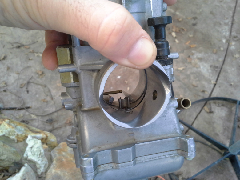

Is that one of those jetless carbs?

Yeah, PSI Big Air. Got one to try on my KX150 AF project. Taper bored 30-38mm. Need some radiators made to fit and I'll be motivated to finish it.

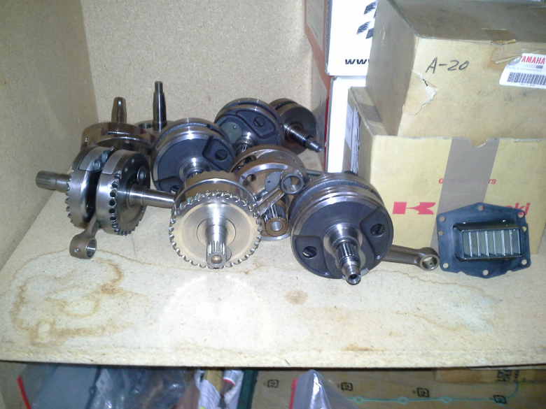

Those turbo cranks work well? Any of them fit a KTM150?? I have one trick crank, but nothing to fit it in...came from what I believe to be a 1982 RC125 Honda. One of the hollow laser welded, balanced , stuffed, polished, every bit numbered.....Someone spent some time on the workbench type of cranks. Think all those holes in the other crank could be why my 81 YZ250 is so damn weak??

I assume the 2 in front are turbo cranks? Whats the theory? The notches pick up more air/fuel mixture forcing it up through the transfer ports? I've heard the term but never seen one.

These cranks work very well. The term turbo crank has been used loosely over the years and most don't really work very well. They are machined like a centrifuge so as it spins, it creates vaccum in the center of the crank. They pull more fuel into the cases and exhaust it up the transfer ports.

That's the Pro-Action Vortex carb mod. They riffle the bore to help increase the intake velocity. It helps with throttle response and acceleration. You might be better off with the oval bore on the KTM because it has a the 36mm carb, which already has good low to mid response.
I operated a Pro-Action shop for 5 years and always had positive feedback from that mod. It's great for 38mm carbs as well as the minibike carbs. Give them a call if you want more info, they're good people.
Wow! I've never seen a crank that was that bad, it must be Swiss made. Lol.
Just stuffing that bad boy would make a world of difference.
