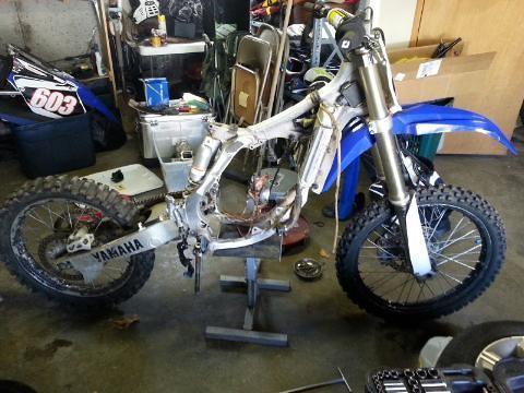

Picked up an 05 yz 125 last summer for $1200 and have spent countless hours imagining what I could build from it. Reading reviews, researching the best performance and trick products. But also something unique and meaningful. And (in my mind) a piece of artwork. I see these bike builds on here and am often left drooling, jealous of the time and effort put into each build. Well I'm going to "try" and see if I can get some photo's rolling up. The assembly process has begun. Take it easy on me this is my first build. I'm always open to suggestions
Here is what I started with.

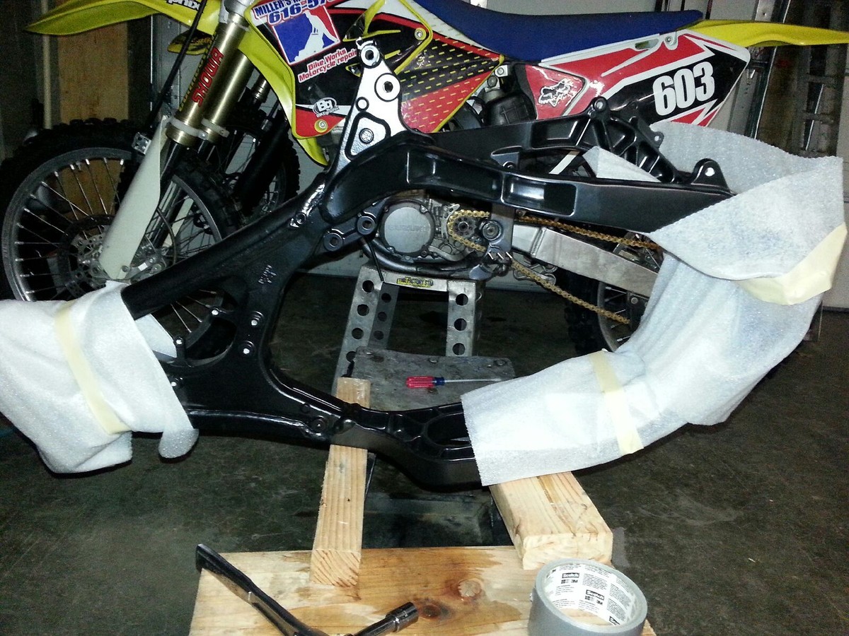

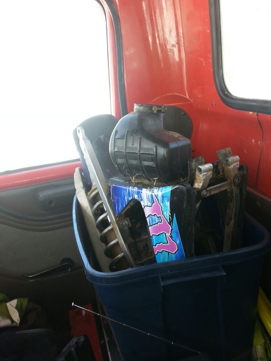

As I'm a truck driver, I browse good old craigslist of the areas I know we deliver to, And I found a guy on craigslist parting out an 06 yz 125 in Tulsa OK. So I gave him a call and arranged to get a trip in that direction to pick up all he had left. Mainly for the rear shock. Success. And didn't even use any of my own gas!
5/7/2014 5:31pm Edited Date/Time 5/7/2014 7:17pm

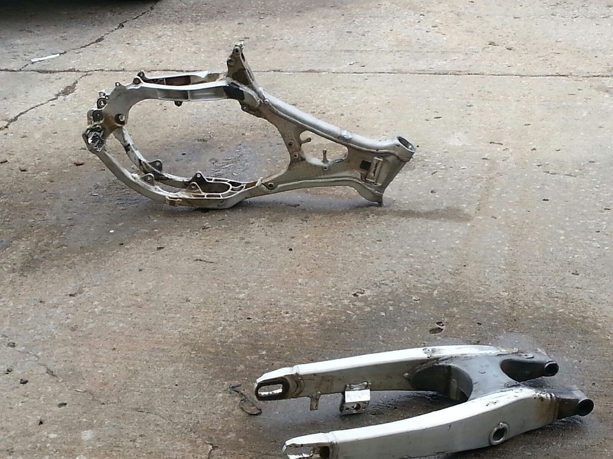

The frame and swing arm were stained in that red Oklahoma clay. They said it wouldn't be a problem bead blasting all of that out.

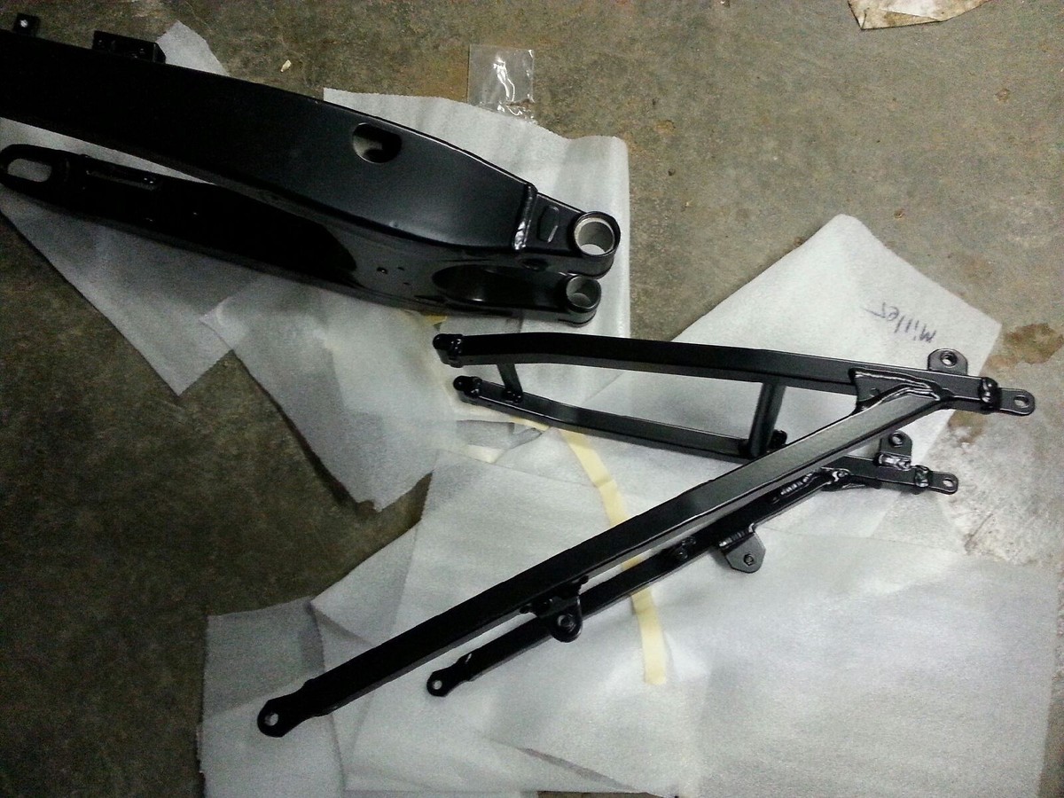

I was given 3 choices in black, Flat black, semi gloss, and gloss. He was trying to persuade me to go with a gloss black but I thought it would be a little too shiny after he showed me some samples. I ended up going with the semi gloss hoping it would show less wear and tear, But not look faded like flat black
5/7/2014 5:31pm Edited Date/Time 5/7/2014 7:10pm
I took the frame to a company in Kansas City Called Liquid & Powdercoat Finishes. They do all the Harley frames for the Harley plant here in Kansas City. He also said that he does a lot of the KTM frames. Says they run about 250 frames a week.

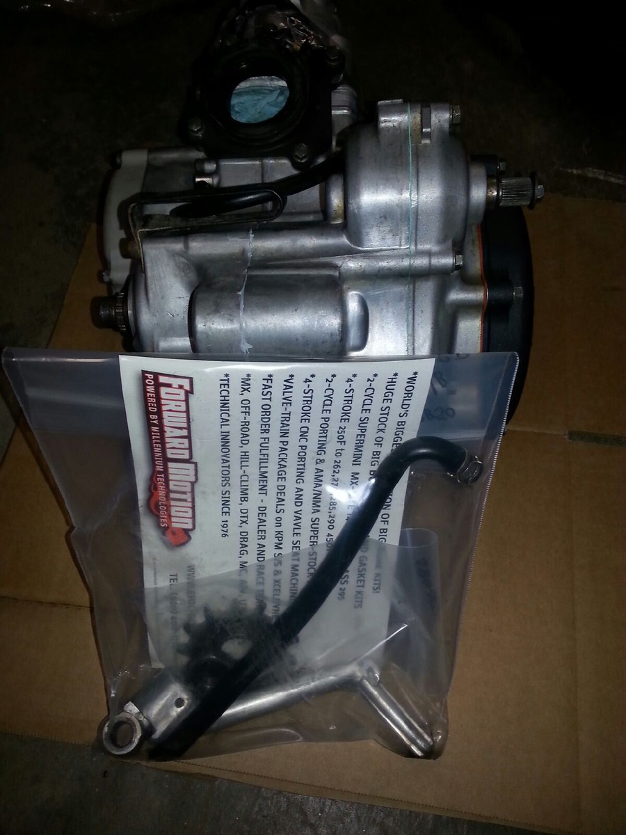

I see that shipping label to Forward Motion/Eric Gorr - I have a 144 kit on my '05 YZ125 ported for more mid-top and the thing hauls. Just make sure you are using 50/50 pump & race gas.
keep us updated with pictures - looks good.
That's the same set up I'm going with,.. But when you shipped it in did you check the box for race gas? or pump gas? I planned on running it 50/50 with race fuel. But I checked the pump gas. Also what fuel do you mix with. There aren't any 100+ pumps in my area. What VP fuel?

If there's an airport nearby, try 100ll. Stuff works great. Eric did my son's 05 YZ125 cylinder and head. Mid-top end power, cut for race gas.
I checked the box for pump gas and thought it was going to be OK - turned out I was wrong. See this old thread where it broke the piston due to detonation:
http://www.vitalmx.com/forums/Race-Shop,42/YZ144-broken-piston-detonati…
Luckily, there is a Sunoco gas station on the way to the track and they sell 110 octane, so I mix 3 gallon 93 and 2 gallon 110. My understanding is that it needs higher octane or detonation will happen especially if it is ridden wide open.
I went with 14/49 gearing and that fits perfect. The bike screamsSmile

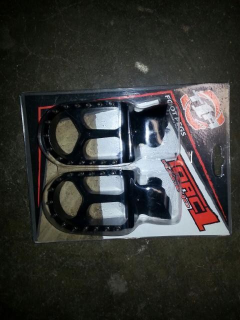

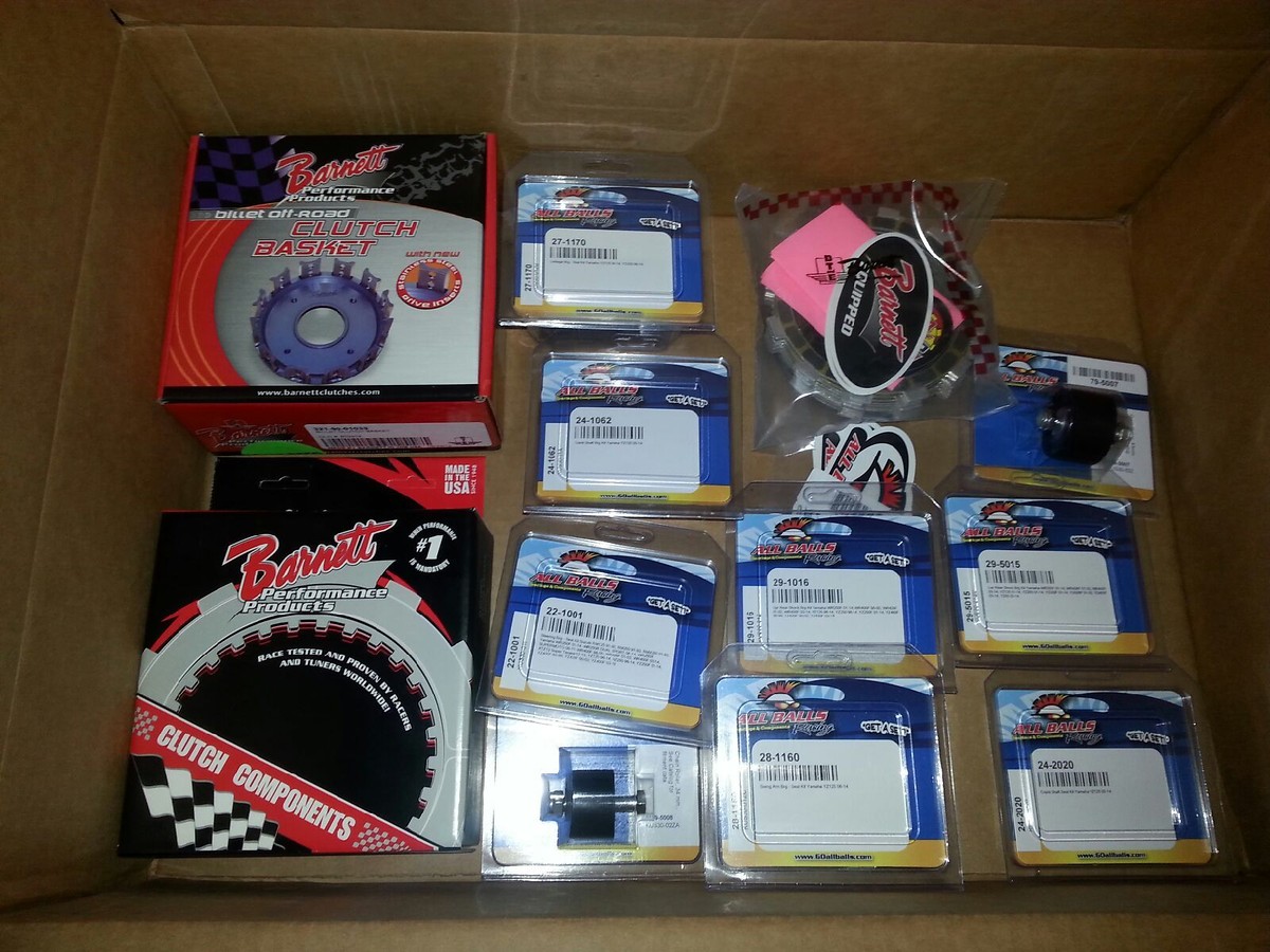

Came home to some goodies today!! It's like Christmas morning! Went with a full Barnett clutch, Everyone I know who has one LOVES it.. Plus I figured it would handle the extra torque. Also went with All Balls bearings for all the frame/linkage bearings.
5/9/2014 7:42pm

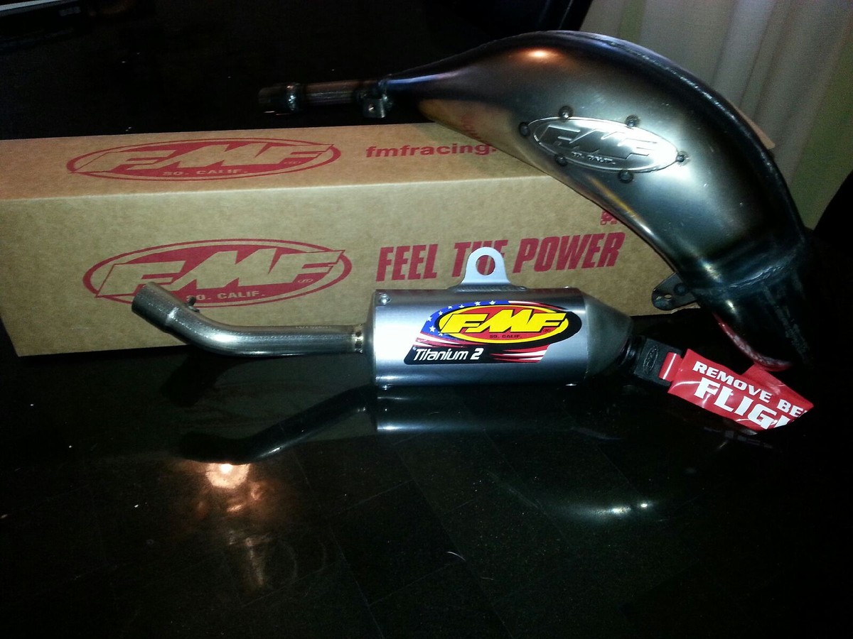

Mika Metals, Bars/sprocket set up. Went with a 13/49. May have to test the 14/49 as benchracer suggested.
New DT1 filter
5/12/2014 7:00pm

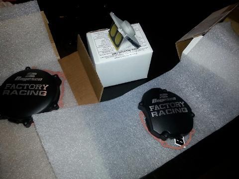

A lot of debate between the V force 3 and the Rad Valve, I had the vforce on my previous 06 yz 125 7 years ago. So I figured lets try out this Rad Valve and see if there is any difference. It's looks like it's built better (cast housing) rather than plastic. And of course the pretty ignition/clutch cover for that "factory look"

Received the Motor back! Caught the feedback in time to Call Eric and have him set the head up for 50/50. Said that it wouldn't be a problem. 144 ported and polished for more mid to top.

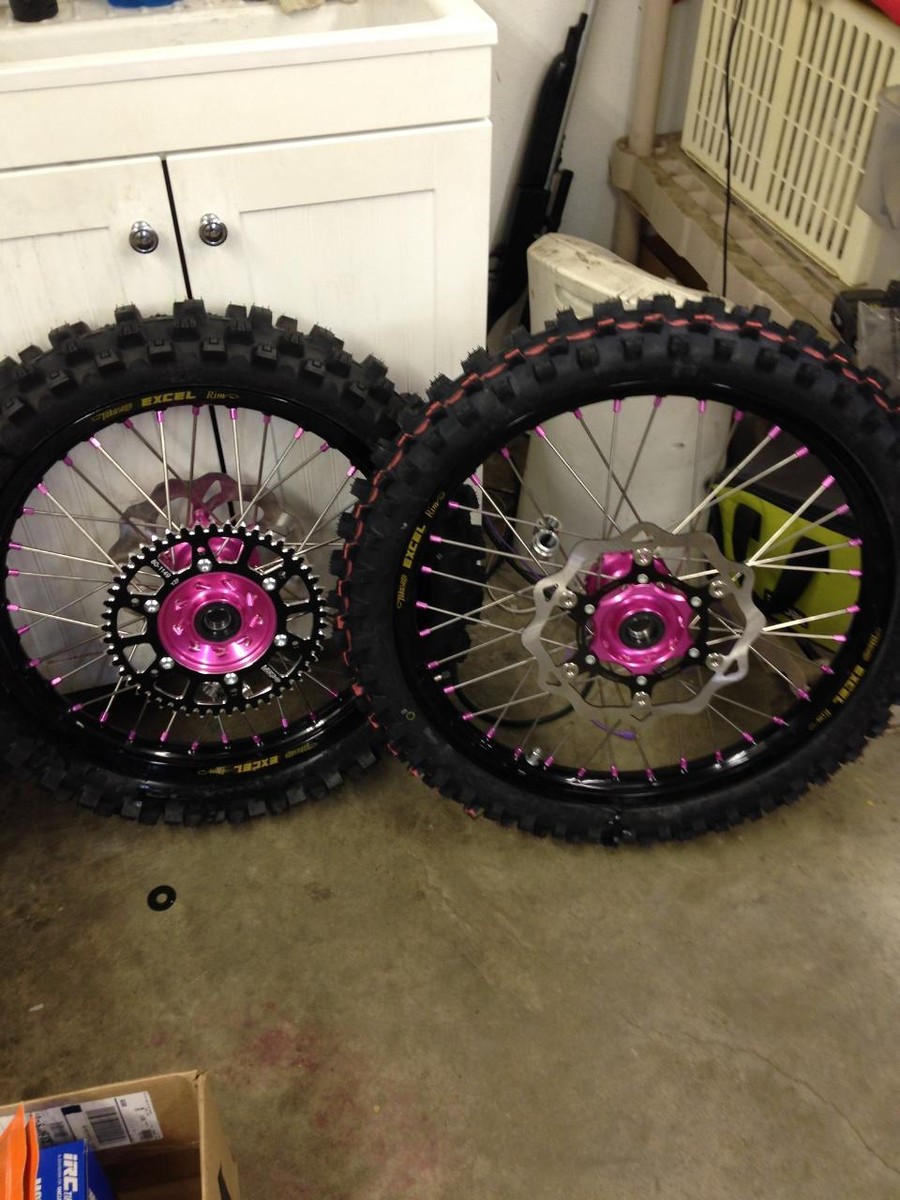

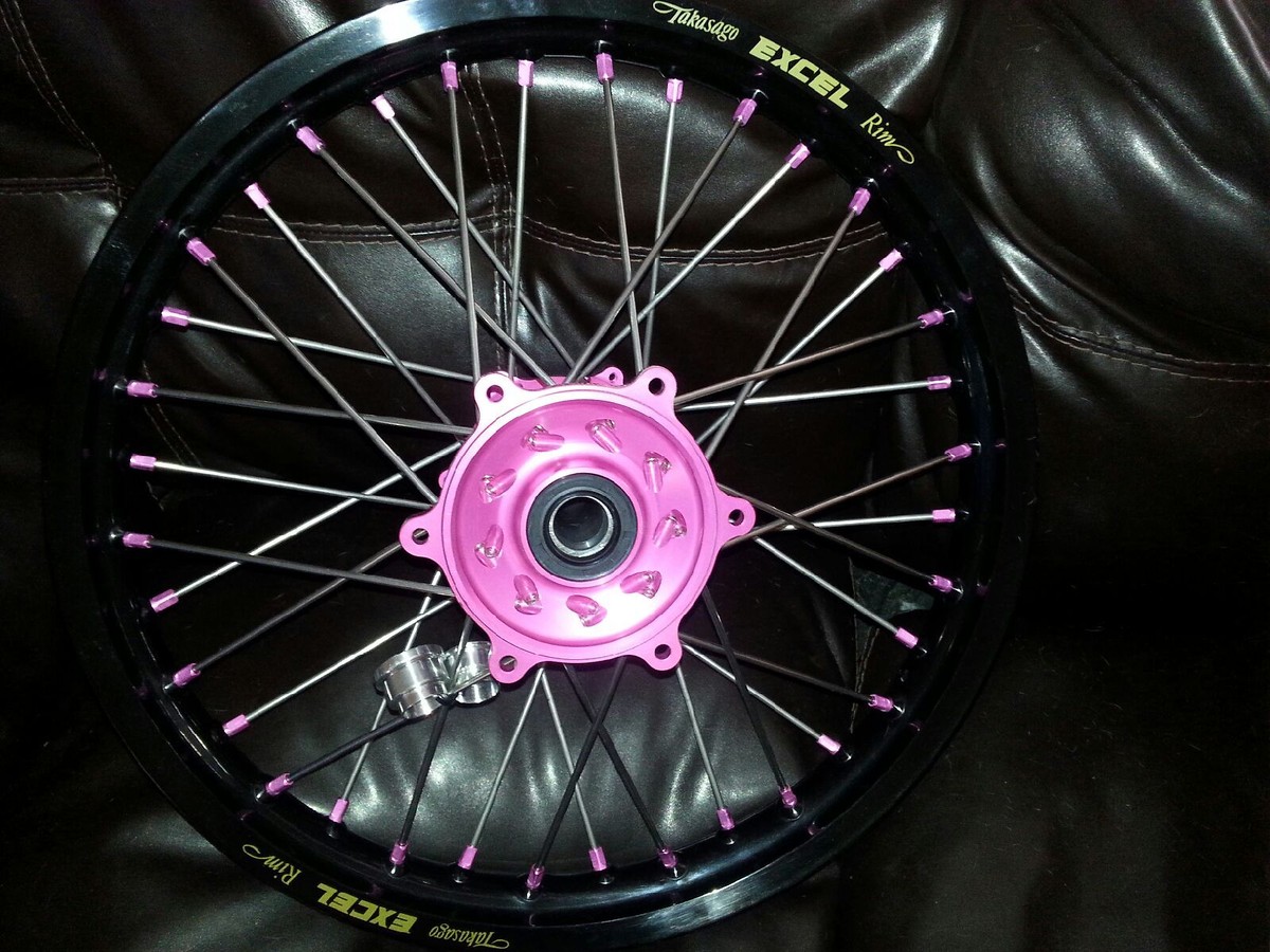

Is it the picture or are the wheels Black / Pink?
5/21/2014 6:25pm
Your eyes are not deceiving you. Went with black wheels, pink hubs and nipples. You will soon have a better idea as to why. Assembly is in full swing. Stay tuned. You won't be dissapointed.

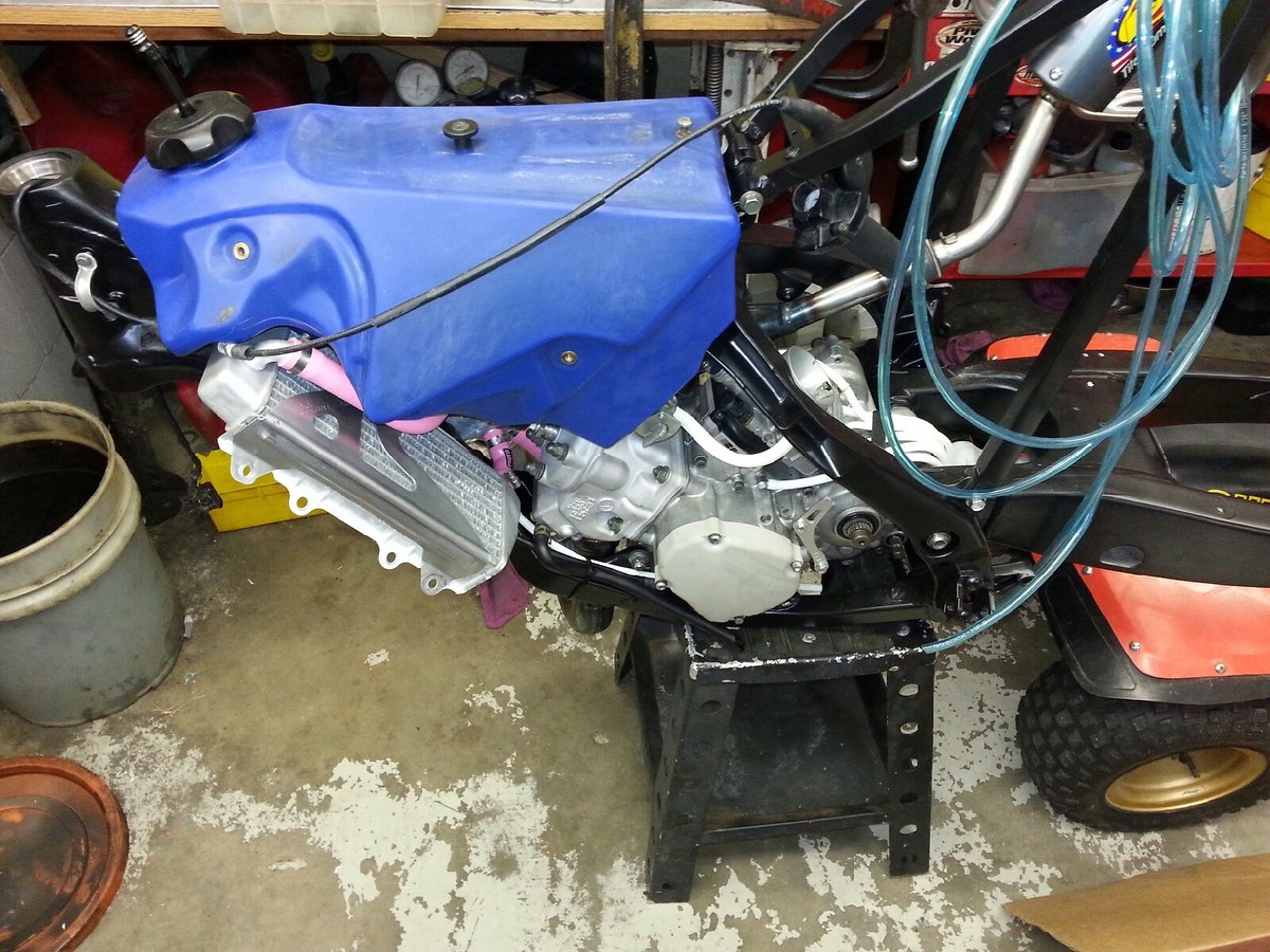

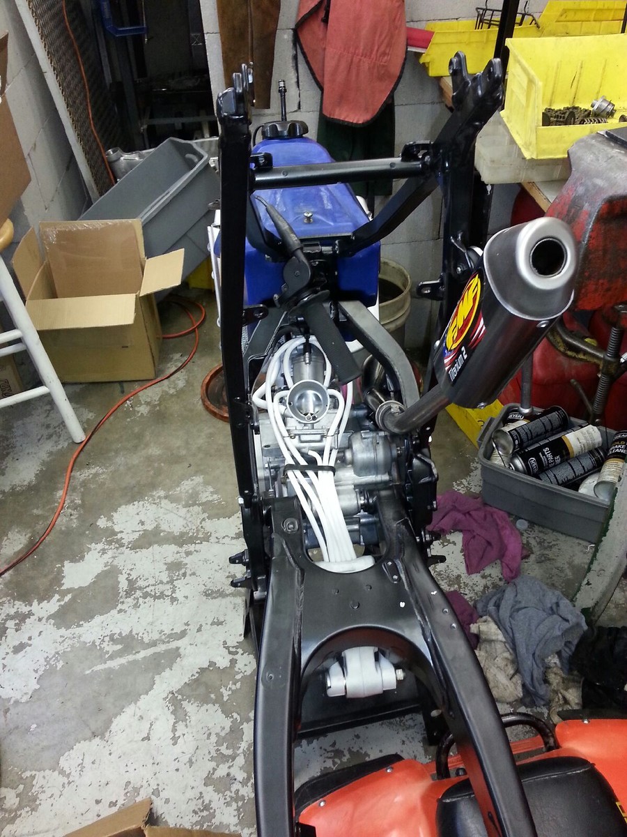

More pix coming tomorrow. Sorry for the late response. Working 2 jobs eats up the majority of my time. Good news is she's purring, got the motor in and she fired right up. Anyone have any ideas on what kind of jet changes will be needed?
