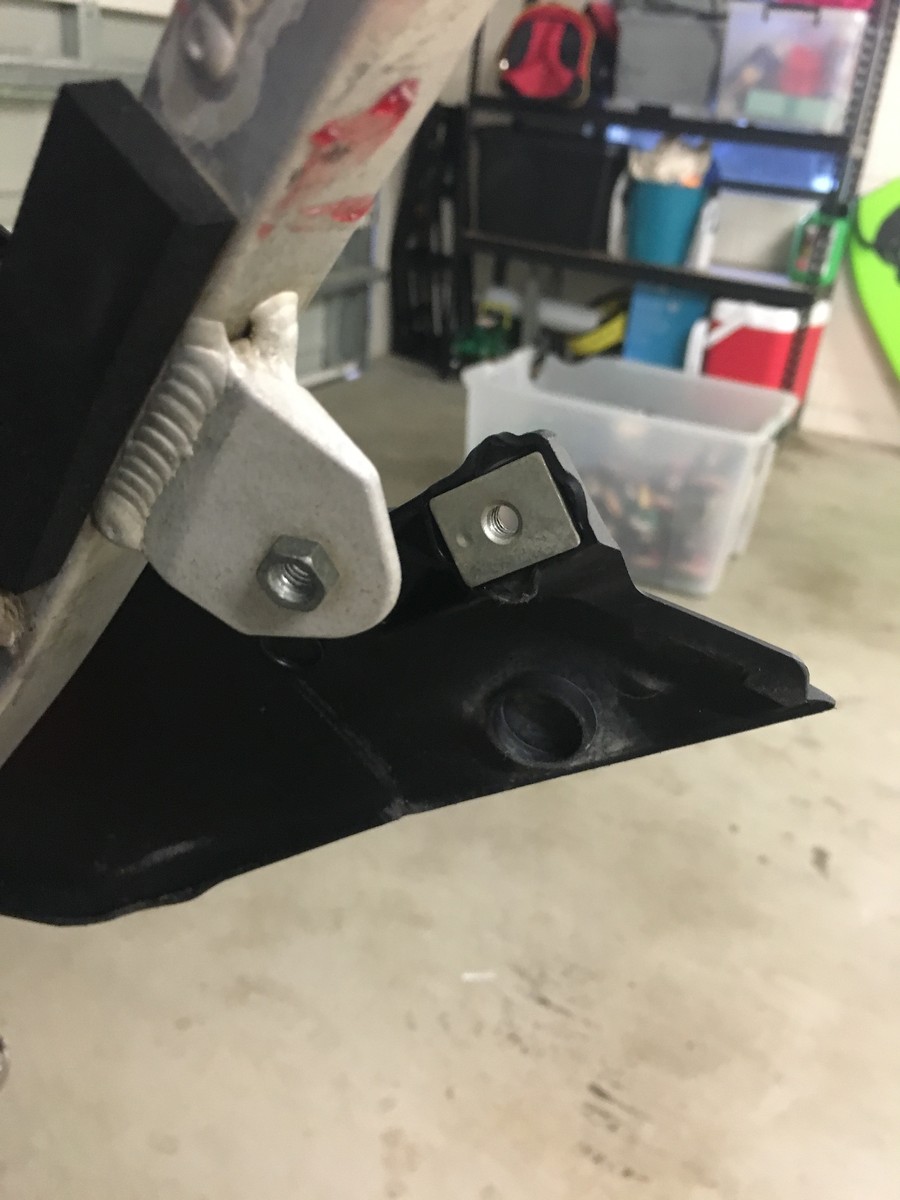

Since you're going into a lot of detail here...
What the deal with the new plastics and their mounts? Specifically where the number plates bolt to the airbox. There's a cheap square peice of steel that's embedded in the back of the plastic that just spins around when trying to remove bolts. I had to use vice grips on this crap to take the plates off. Is there a fix for this?
It's kindA funny people begged for a plastic update for a decade and they give you this complete garbage.

Hey mate, I see what you mean I never had any trouble with them, they are commonly used they are on my 16 WR450f to hold the mudguard on. suppose just don't over tighten them or use loctite or anything like that, I don't usually have any dramas with them.
