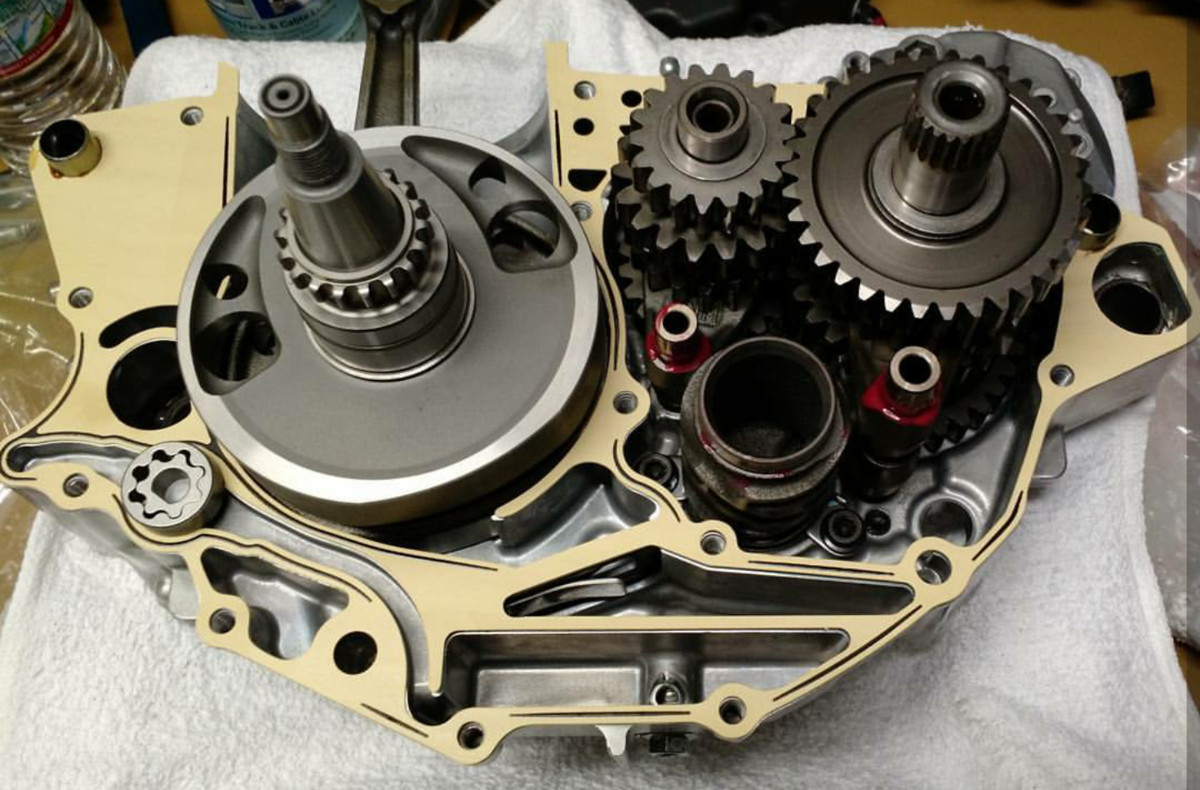

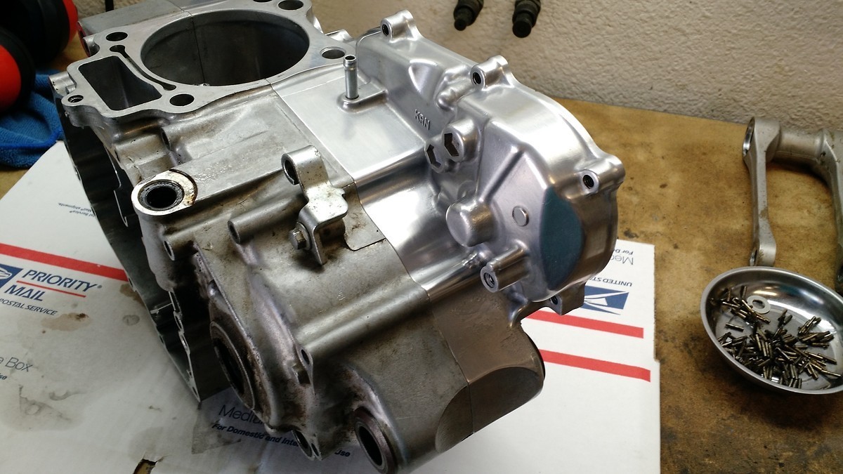

So this is what i started with, motor was completely seized previous owner had no idea why, so i started by pulling the entire bike down and quickly ripped into the motor and to my horror found this
Looks like a valve failed and made a complete mess of the motor, i wound up trashing the cyclinder, crank, and head. I then got to cleaning/anodizing anything that needed it.

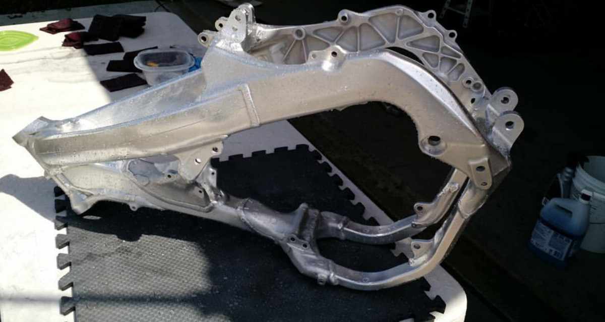

I used Lye to strip the swingarm, followed up by eagle one and lots of scrubbing
Before and after of the cases

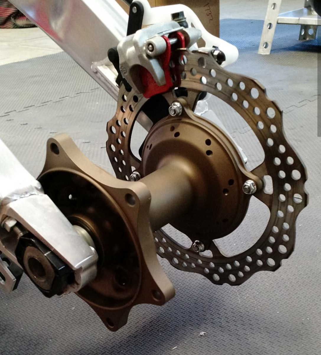

Hubs were cerakoted by OC custom coatings, they do all of AHM and Dubyas parts

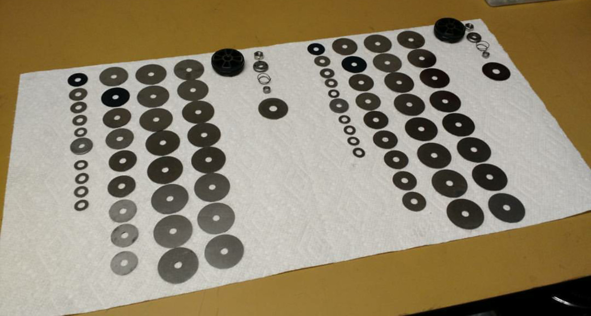

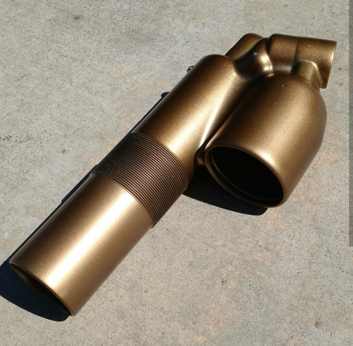

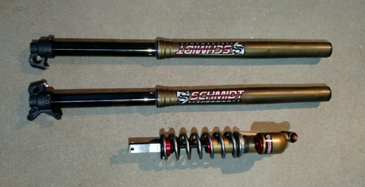

Fork and Shock shaft were DLC coated, check valve and works PC piston in the shock valving from Schmidt Performance
Motor got a Vertex HC piston, Stage 2 Hotcam and Moto Tassanari airboot

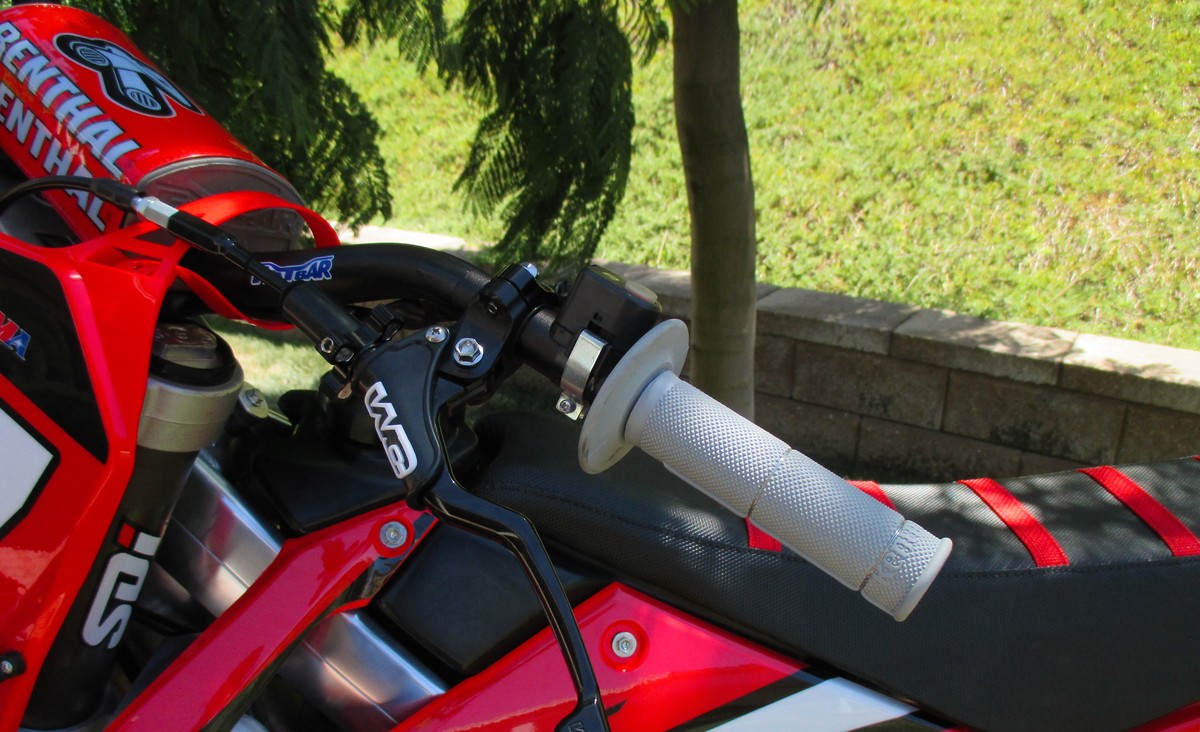

Used the 2016 clutch cable/mount/actuator for smoother pull

Hey man mint build, just a few questions. How did you clean your cases so well? And how did you prep your side covers for anodising?
Thanks man, the cases I used 320 to smooth them out followed by maroon scotch brite and brillo pads, they were really dirty and a major pita, probably spent 2hrs per side, will definitely vapor blast them next time. For the side covers I started by stripping the ignition cover with aircraft paint striper, then had it bead blasted along with the primary and water pump cover. They were all hard anodized, water pump and ignition/oil filter cover are dark gray at .002, and the primary is "clear" at .0005.

I never thought you can order just the shim stack from suspension companies?
Sounds good, might have to give it a go. Nice job
Thanks man, I actually used work for Schmidt, but we do sell valving to diy guys and people in other states/countries on occasion.

When you end up throwing a leg over it let me know if the "a-kit" coating make a difference or just make a trick look. Sweet build, i had a 2012 crf250r and loved it until there was rattle coming from who knows where, and the engine needed a new top end. its an awesome bike if you keep up good maintenance.

Thanks man! Yeah I've got about 10hrs on it now and i absolutely love it! As far as the coatings its hard to say because I didn't have anything to compare it to, but I've built alot of suspension and when you build something that's coated you definitely notice how much smoother everything is so on some level its definitely doing something, whether or not you feel it is hard to say, looks cool though!

Thanks man I greatly appreciate it! For the frame all I did was wash it with eagle one and then I scrubbed it with maroon scotchbrite and sos. Same thing for the cases except no eagle one and I used 320 sand paper first. I did polish the header and it did blue very nice, one of my favorite things on the bike
Right on! I've never done a full frame job on an rmz like this yet, one thing I've noticed is every bike reacts a bit different, some are shinier then others, just depends on the alloy and how the peices are cast. The rmz's seem to clean up quite nice though, the factory guy's frames are probably the nicest in the pits.

How much did it cost for cerakoting the hubs? Wonder if its any cheaper going directly to the company versus going through dubya.
dereka15
Vital MX member dereka15
48559 dereka15 /images/default/avatar/c50.png http://www.vitalmx.com/community/dereka15,48559/all 08/22/15 http://www.vitalmx.com/community/dereka15,48559/setup 1 19 1
Posts: 20
Joined: 8/22/2015
Location: USA
12/2/2016 5:05 PM
It only cost me $100 to have them done which is half of Dubya's cost.
