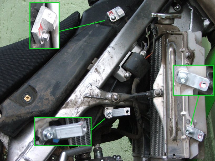

Does any one know if the newer style kxf shrouds(13-15) style bolt up like the older kxf shrouds(08 and older) to the kx frame? And does the newer style front number plate and fender bolt right up?

It has been done before, however I read that you need to weld a tab onto the frame to make the shrouds line up, and if you want to go all out on the rear also then you may need the '13 airbox, subframe and seat, if you want to upgrade the rear to the new gen plastics. The front end (fender/plate) bolts on without any mods apparently.
I have seen it done before just never knew how difficult it was! But thanks for the info!

Sounds like the KXF fender is actually a little short, in the sense that it doesn't seal off the airbox and leaves a gap
... you know how the KX rear fender is sticking up a lot? The KXF kinda droops down...
Here's the shroud brackets:
If you're going to get shrouds, 06-08 work the best, they line up with the tank and that's the biggest thing. 09-11 are off, and 12-13 are even more difficult to fit.
