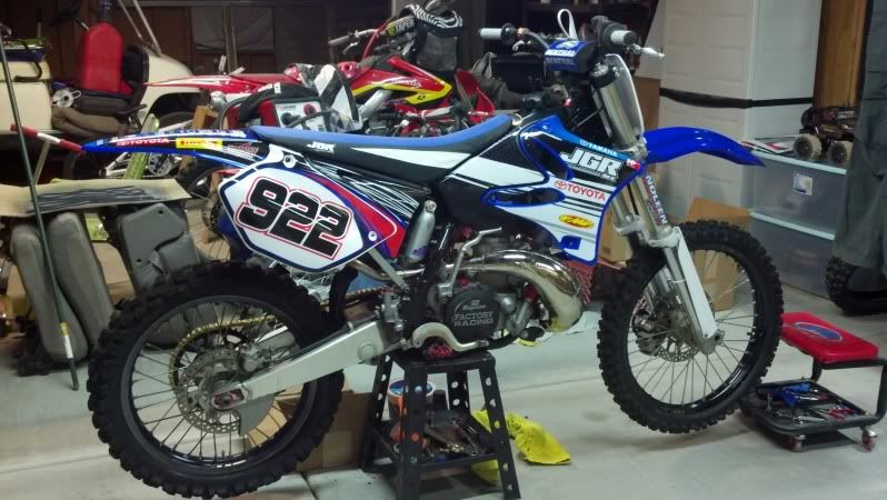

Wow that bike is gorgeous.

Move that one a few feet to the right and let us see the one behind it with dem pro tapers.

Here are some pics from yesterday. 95% done.
