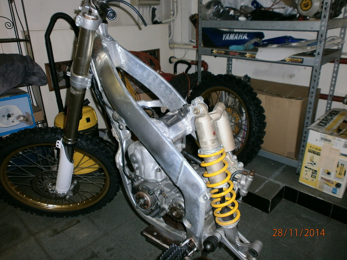

Started stripping the bike 2 months ago.

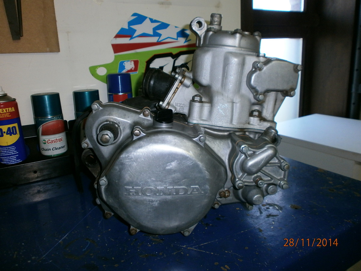

The engine together with my YZ80 engine, 2stroke power !
Parts are all over the place!

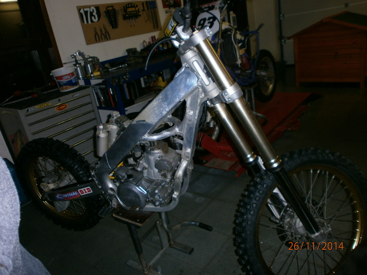

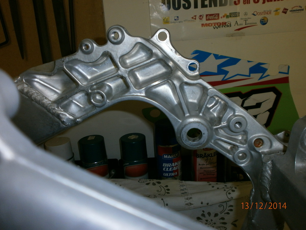

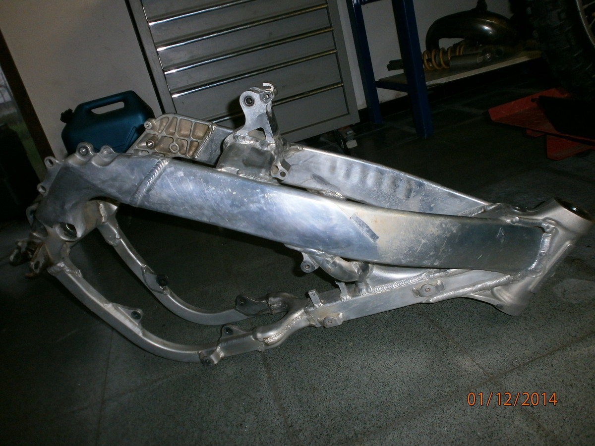

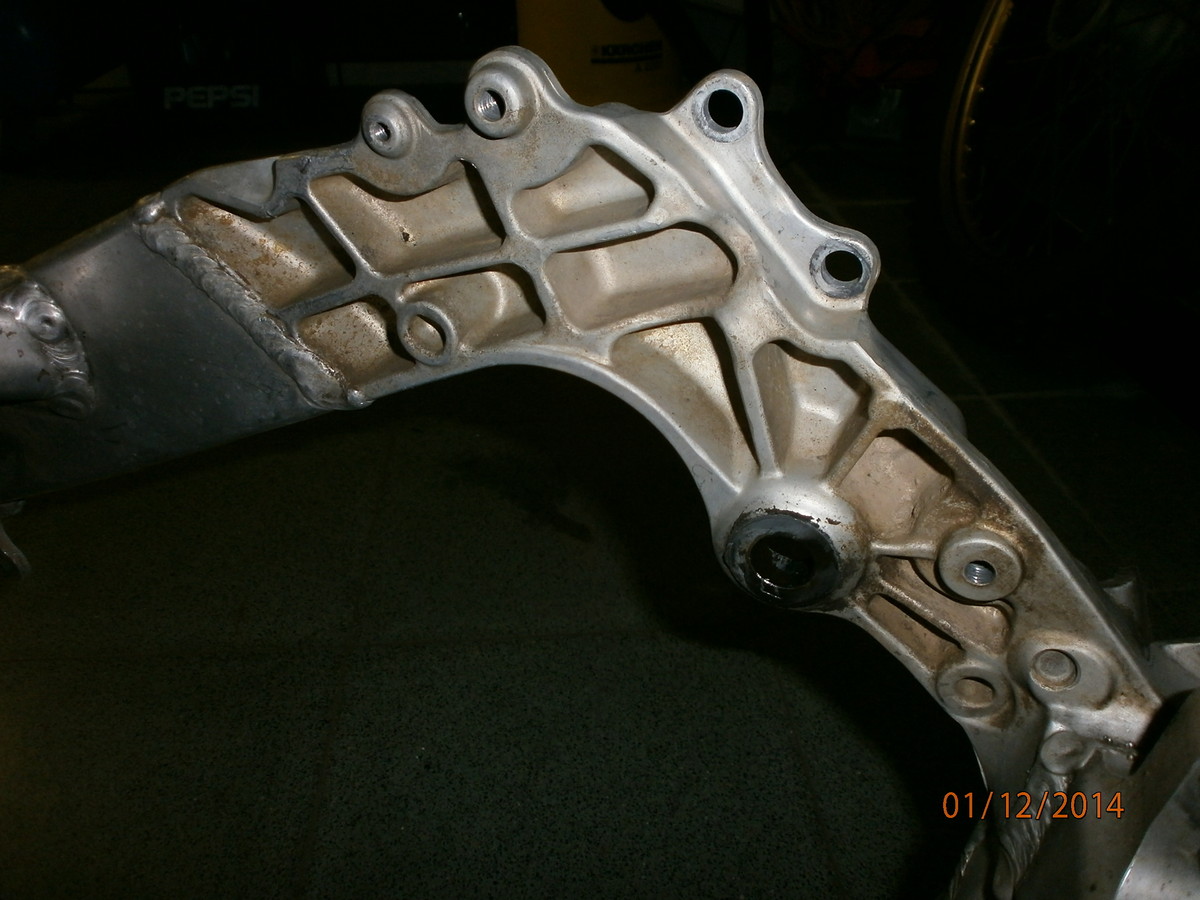

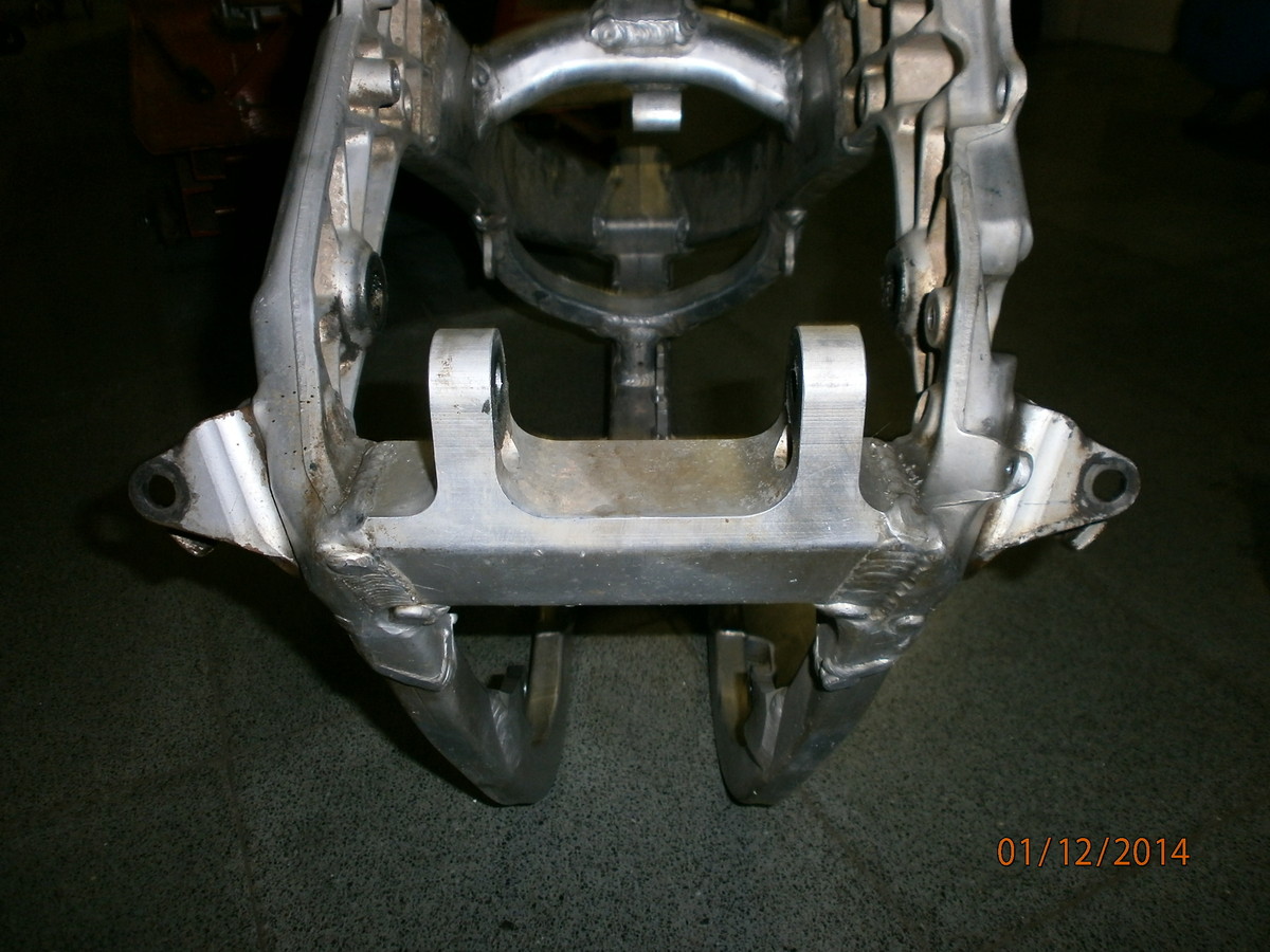

The frame needed to be like Ricky's MXoN bike so i cleaned her with alloy wheel cleaner and high pressure water, Then used green scotch brite, WD40 and elbow grease.
Before:
After:
5 days ago i gave it another shot with green scotchbrite for a even better result !
Pictures not very clear !
Many thanks to the people who helped me and gave usefull tips to get my frame look almost new again !

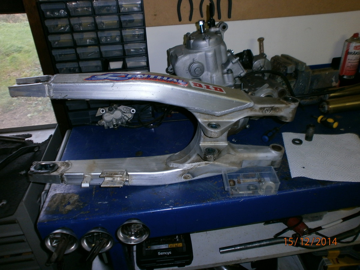

Time for cleaning the swingarms, bearings will be reused cause they only ran for 30 hours and had no signs of dirt and water inside !
For cleaning the swingarm i also used green scotch brite and WD40. Happy with the result !

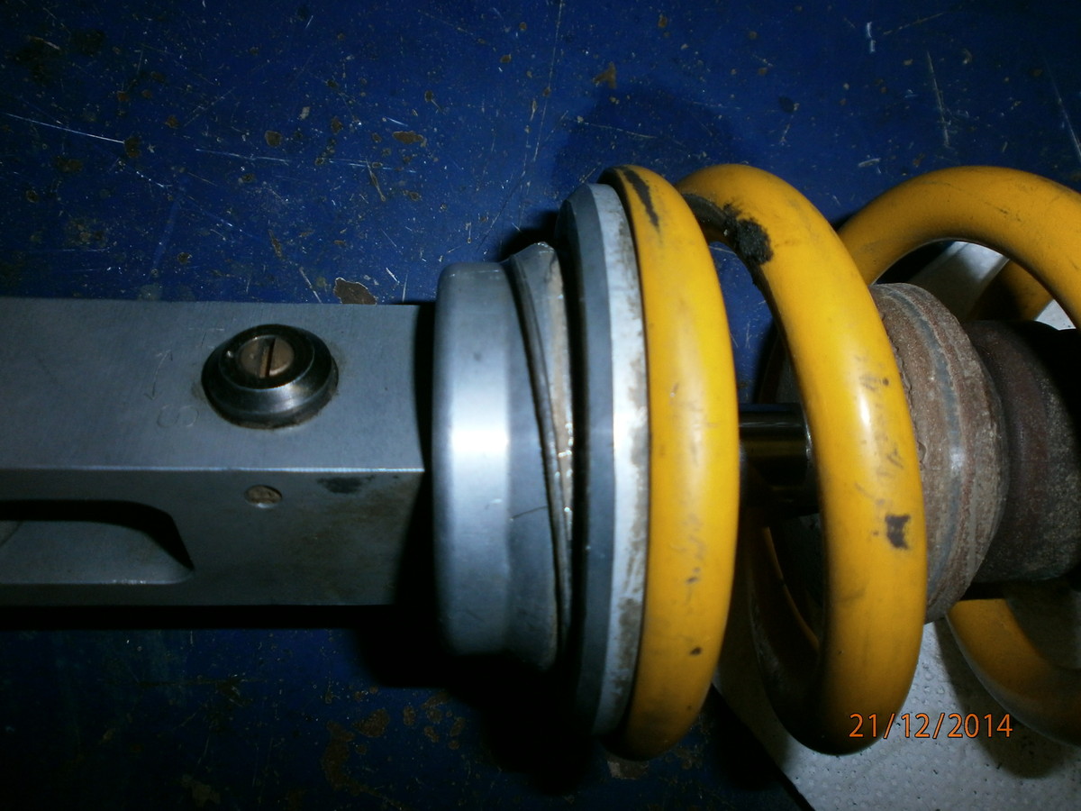

Cleaned the throttle housing and disassembled the rear shock.
Cleaned and greased the linkage bearings. They have no play and no signs of dirt and water inside, only the sinlge bearing at the small side needs replacing. The wheel bearings need to be replaced to !

Hi guys, some updates from the past weeks.
Got my swingarm installed, rear brake caliper and a brand new slave cylinder. The brake hose was in a pretty good shape for it's age so didn't use a new one.
Also blasted the front brake caliper and master cylinder, but the brake hose looks crap from it's age so have to get a new one.
I received another small batch of Honda OEM parts for rebuilding the front and rear brake caliper, all brake pad clips, pin hangers, banjo bolts, some bolts and screws for the front master cylinder gets replaced.
Picked up my spring from the powdercoat today and looks perfect ! shock also got a new bearing on the top.
Also received the HRC shift lever i bought from Chuck "Norris" Davies (the guy from the Peak Honda and Splitfire Kawasaki) so again thank you ! Cheers.
Called my suspension shop, my front forks should be finished in 2-3 weeks. Eagerly waiting !

Hello.
Some updates from the past few weeks ! Today i picked up my suspension from the shop, after they gave it a "A kit" touch.
Fork lugs were hard-anodized in black, inner tubes have the gold Ti-nitrate coating and the upper tubes anodized in silver.
Got my engine stripped and the cases shipped to Holland for vapour-blast, the cases were finished today so should have them back in a week !
So last week i received my titanium nuts for the cylinder and head, and i ordered a titanium "HRC type" bolt kit for the engine from Phil Denton Engineering in the U.K., should have them in about 2 weeks !
The engine should be complete in a month, only piece missing is a Honda Racing ignition cover.
I have the Honda Racing clutch cover already which i bought a year ago. Only i still need to paint it.
These were the cast aluminum ones, but i'm not so happy about the finish of the words HONDA RACING. It looks pretty rough, i've seen better ones out there for sure !
Meanwhile the parts pile is growing !
I'm planning a photoshoot of the engine when it's finished, should be awesome !

11/30/2015 3:35 AM
Got my engine cases back from vapour blasting and found a sandcast replica Honda Racing ignition cover which i painted in grey.
The clutch side cover was supposed to turn out more like a brown/grey finish ! So probably it will be repainted with another paint, depends how it turns out when everything is together.
Also received my HRC replica titanium engine bolts from Phil Denton Engineering !
Everything is back at the shop for assembly, engine should be finished this week.

12/15/2015 12:43 PM
Engine is almost finished, but here's a sneak peek !
Here with the HRC shift lever and carburetor on it.
I think the titanium bolts are looking friggin awesome !
