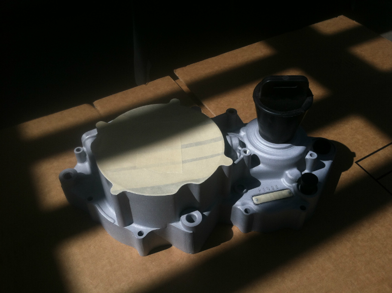

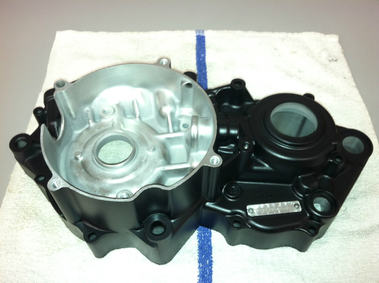

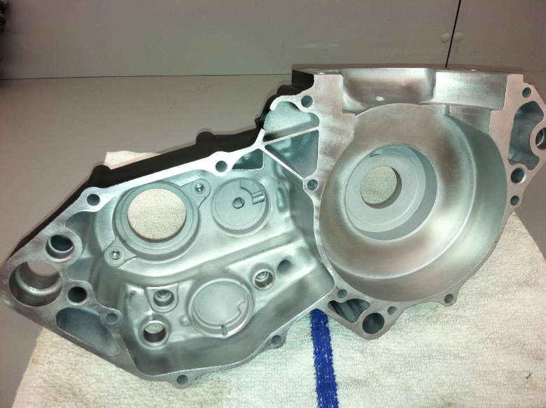

this is how it looks from start to almost finished.

Leeroy,
Could you tell me what grade/media you used to blast those cases....they look great! Also, what paint did you end up using and how are the results after use? Thanks!
