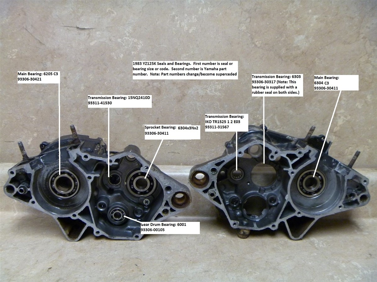

Then engine was tired and needed a full rebuild. Every single bearing and seal was replaced. In fact, the cases were replaced as well as getting Eric Gorr to resleave the cylinder back to standard, fit a Wossner piston, machine the head, match the power valve and do a port job. The OW had a rotary valve engine so I was never going to replicate it, but I could make screamer by following the Yamaha Race Report.

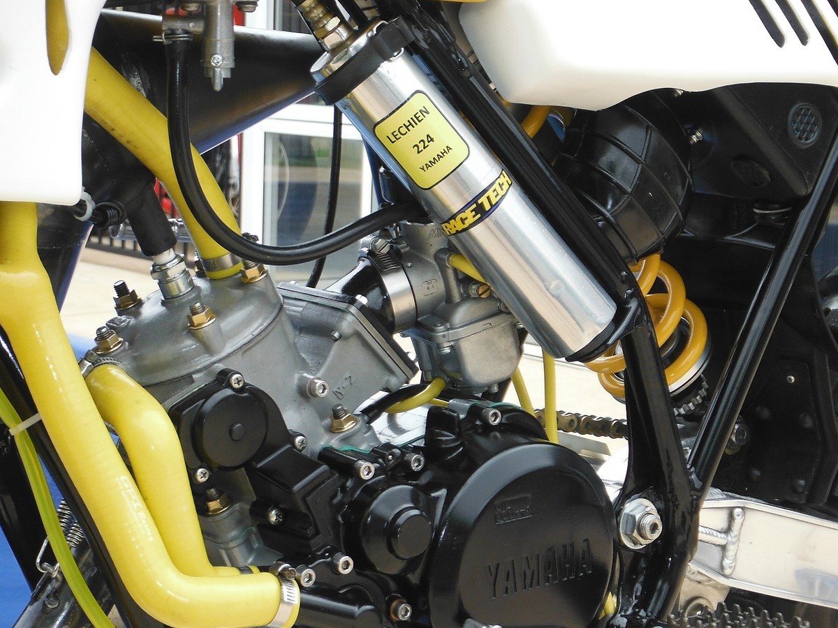

To go with the engine mods, a 36mm oversize carb was fitted as per the Race Report, and Jon Easton at Jemco made me custom cone pipe. The bike also runs a DG muffler. The electrics were getting old, so I replaced everything with a digital PVL setup that was supplied by Newman.
The rads were bent, so I sent them together with the hoses to GPI and had them reverse engineer a set for me. These came back and fitted great. The yellow silicon hoses are quite trick too.
Lechien ran a vented black number plate back in 83. There were a few variations on the “holeshot” plate, but I found a genuine Preston Petty plate which is very similar. The OW also had Takasago rims, so I had mine rebuilt with gold Takasago rims with gold nipples and Dunlop tyres. I also drilled out the rear brake arm similar to what the works bike ran.
Race Tech in OZ rebuilt the rear suspension. It took 3 shocks to get one that was suitable as the alloy bodies get scored and become unserviceable. Gold valves and a heavier spring were fitted and the initial feel is fantastic.
