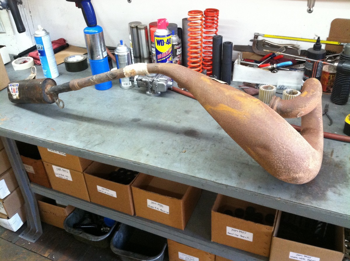

Some before and afters of the pipe. Got a solid 20 hours of labor into cleaning it up by hand with various stages of sandpaper down to various stages of scotchbrite.

I know it's a works pipe, but I would have throw that thing in the garbage! Holy cow nice job on that! Speaking of pipes, I have one off that 87 CR 125 if you want it, it's oem with rather large dent in it, but other than that is like new with way less rust than that thing. I will start a separate thread for that, don't want my photo's messing this one up.

Thanks guys. Yeah the pipe was pretty crusty but being that it's the real deal works suzuki pipe I felt I had no choice but to restore it. It's paper thin and wicked light. Was pretty nervous blowing the dents out of it being so thin and all. I re pooled all the welds with the TIG to get the proper width bluing again. Still has some pitting in it but from 2 feet away it looks new. Should get some more work done on her tonight.

I have a cone pipe for my bike I want to use sgthubbard. How can I get the fresh weld look?Actually what was the process? You got amazing results. On the pipe on my bike now I stripped the paint. Then sand blasted then a kinda aggressive scotch brite. I was happy with mine until I saw what's possible from your work

That pipe was so rusted that I submerged it in CLR for about 6 hours then hand sanded it starting with 220 working my way down to 1000 grit wet (WD40 not water). Once you get it to that point it is way too shiny so dull it back down to a natural steel look with scotchbrite. For that I started with the grey scotchbrite then finished it with red scotchbrite, again wet with WD40. Once it was as good as I felt I could get it I reblued all the welds with a TIG welder. To get the proper width heat signatures I dialed the welder in on pieces of sheet steel the same thickness as the pipe then repooled all the welds. I no joke have at least 20 hours of labor into that pipe. It was all worth it in the end as it would have been as wrong as two boys kissing to put anything but the orignal works Suzuki pipe on the bike.

Nice job so far! For the welds on the pipe you just trace them with an oxy/acetelene torch. No need to actually weld it. If you mess up with the torch you can sand it off and trace again.

Thanks. Normally when I restore a pipe that is what I do but with this one being so rusted I had to sand it enough that some of welds were flattened. I just ran the TIG over the welds enough to puddle them back to normal. Prob overkill but hey, it is a works bike so no corner cutting. Lol.

I hope you ran some Ar / Co2 mix inside the pipe while tracing the welds...

For those results I don't feel 20 hours is a lot of time. For me the welds make it. It would still look good without it but it would look like a production PC pipe rather the hand built factory part it is.
