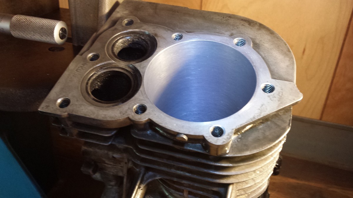

Hey guys ive looked around on this site some and talked about old bikes I dont see exactly where to post this or if I can ? I do cylinder boring and resleeving and thought this would be a good site to place it a mod or ? Please let me know if this is ok to post if not let me know as well but anyway ,,,
I like the older bikes and remember back in the 80's used to bore cr's yz's rm's kx's all the time I got out of it and now have repurchased another boring bar I can bore or resleeve 2 strokes and 4 strokes , thanks

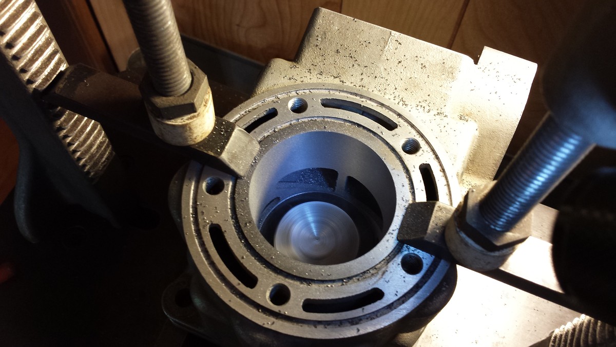

Well fresh off the machine id say none I like to hone the last 0.02 thousands to make the bores smooth I will check the next one I do with my dial bore gauge and see ,
This boring bar was designed just for motorcycle cylinders and the way the cylinders mount on parallel bars on the deck and the way the bar cuts down into the cylinder I cant see any way it could be anything but straight , on honing you could possibly get a difference from top to bottom but after boring all these years and hundreds of cylinders and blocks I have never had a problem ,
I will check one fresh off the machine and then after its honed
