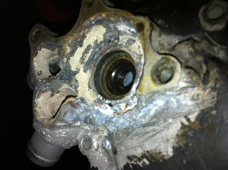

I got a 86Cr500 and the water pump is rotted that badly, I can find the original case second hand, on eBay anywhere..
But looks like you might of solved my problem, which cover would you recommend?

there is the pump.

CR500Rider
Vital MX member CR500Rider
9638 CR500Rider http://p.vitalmx.com/photos/users/9638/avatar/c50_111880340_1236089276.jpg?1294183058 http://www.vitalmx.com/community/CR500Rider,9638/all 04/04/08 1 http://www.vitalmx.com/community/CR500Rider,9638/setup 40 1297 4 4
Posts: 1337
Joined: 4/4/2008
Location: San Antonio, TX USA
5/10/2012 11:11 AM
If you buy a used or new 86' magnesium cover it will eventually rot out. There is no stopping it. The water pump assembly should be the same but you were gonna rebuild the 26 year old unit anyway, right? Those covers aren't terribly expensive brand new so I'd just spring for the 01'. That's what I did for both of my 87' engines. You'll have to strip and paint the cover for it to match your cases. Honda went to that style pump cover in 89' when they went to the lowboy pipe. If you'll go to one of the CR500 sites and do a search for parts interchangeability, you'll see what year they quit using magnesium.
