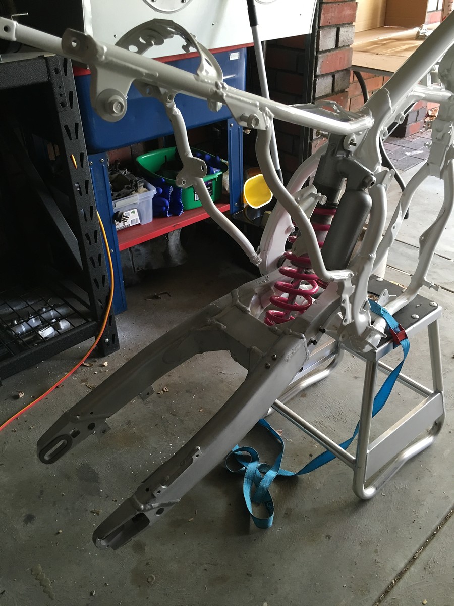

Just a little update, had frame powdercoated, and other alloy bits glass beaded to get back to bare clean metal. Intend to rub back by hand then clear coat. Have 2 sets of forks to make one good set out of and 2 rear shocks. Not finding much time to do anything but it's going along slowly.

So after not touching it for a while due to having a baby and other things, I've started putting this thing back together. Any tips with getting the bushes etc out of the shock and swing arm linkages?

You want some threaded bar size m8 some strong washers a few nuts a couple of sockets one slightly smaller od than the bushes and one socket slightly larger id than the bushes i can post pic up
If your unsure what i mean

I think I do, large socket on the back, thread through the linkage and small socket on the front, then nuts and washers to press it out? If you have pics that would help but I could prob find some on the net.
Same process for the seals on the bottom of the swing arm where the linkage meets?
Going to tackle making one decent set of forks this weekend
