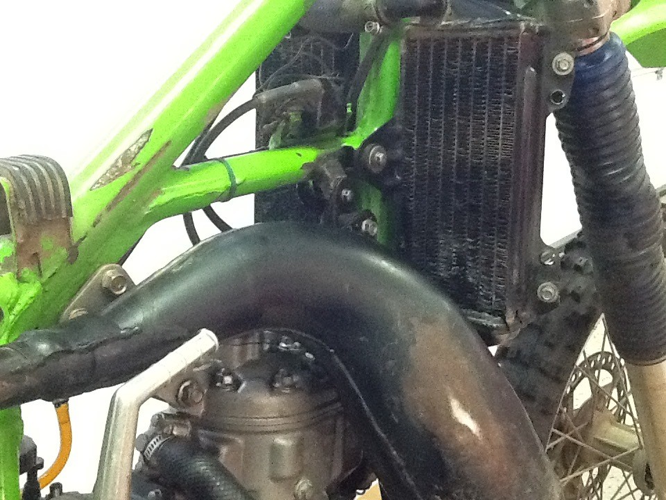

Been looking for one of these for a while now, the 89 does not pop up to often around the northeast. I owned & raced 89, 90 & 91 kx 250"s, back when they were new. I really liked the 89 the best. Took the 3 hr drive to look at this one, price was right, so, here we go. Just got it yesterday, Chassis teardown today. Kawasaki guru"s feel free to chime in with advice, This is my first kaw restore.
Both radiators are in very good condition, radiator grilles are also good. Stock pipe is prett good, could be blasted/ painted but I" m looking for a pro circuit pipe.
Foot pegs & brake pedal very loose & sloppy. Do newer kx foot pegs fit?

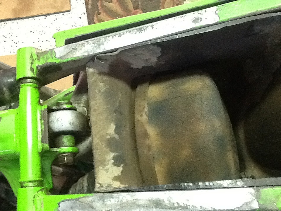

Dirt in the air boot, looks like it will be a full engine rebuild now
Engine out!
No frozen bolts yet!
Spoke to soon, rear axle frozen in swing arm , soaked with pb blaster let it sit overnite.
