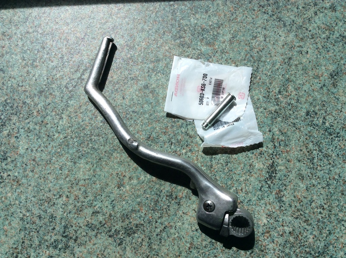

A few more bits in the post today Cool
Was happy to see the bottom chain slipper was there as well, I thought it was only going to be the main guide.
I will probably use the genuine Honda one I bought recently as it is black like the original.

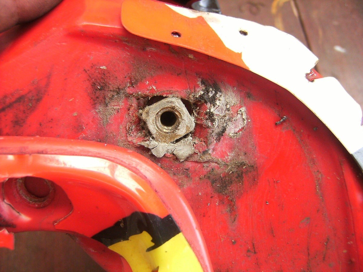

Had a go at sorting the threaded inserts in the tank, tried a heat gun but it was just going to melt the plastic as it is really soft!
So ended up melting in a couple of red cable ties with a soldering iron!! I know it's not to show room standards but this tank is now a spare as I am waiting for a good one to come this week I hope Wink
Before
After
Amazing what some tar and glue remover can do as well Cool
