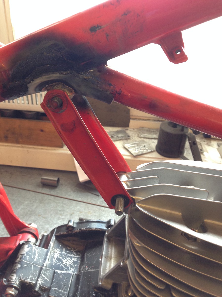

What are you guys mounting the upper cylinder head mount to on the frame side. I'm going through my 80 CR250 now and planned to run a 79 head. I have the Fox sketch to make the bracket but don't see anything to bolt it to other than a wimpy looking tab that hangs down.
I run a 79 head on my 1980. You cant use a FOX head steady though as the bracing tube above the engine is in different position on an '80 and it simply wont fit.
I cut the air box mouning tab off (the wimpy tab you mention) and turned up a steel bobbin the same widthe as the 79 mouning point, and using an original 79 head steady bracket (along with the 79 airbox mouning tab) to position it welded it to the frame. The i used the 79 air box tab (its just a simple L shaped bracket) and a billet version of the stock 79 head steady mount.
