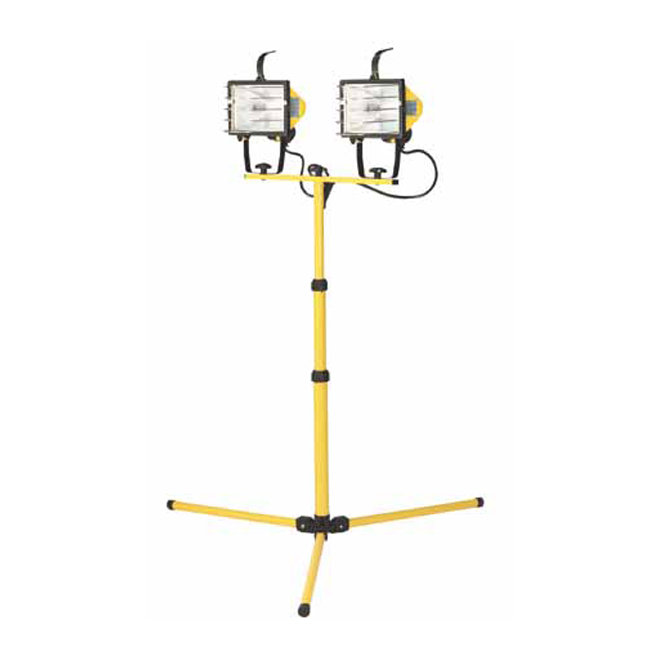

I have only done number plates but I do them on the bike and use windex like others have said. I use my halogen work lights to heat up the graphics and to keep heat on them while I work on mounting them. These lights put out a decent amount of heat over a decent area but are not that hot where I worry about damaging the graphics.
