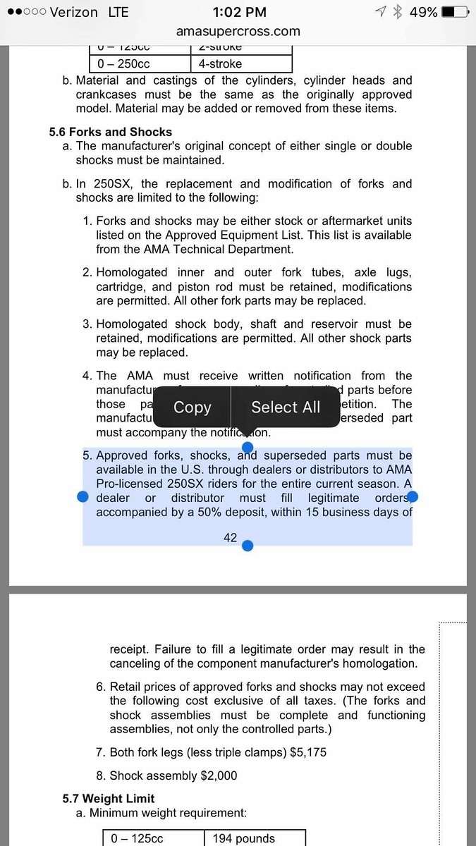

Not familiar personally the new stuff like the 53MM Air Fork KTM runs or even the 47MM that Roczen runs, but to put it easily simply internals, and size usually. For instance KYB won't even sell you oversized stuff unless you you are related to a Maeda I bet, and if you aren't you're gonna have to settle for "B-Kit" which means interior kashima coating, internals, bottoming cones, etc. The average rider does not need a-kit and the above average rider or "fast" local pro does not need it. In fact true over sized a kit isn't really that necessary unless perhaps you're a distance jumper, race sx, freestyle, or you still have a steel frame bike. So for example if someone has an old set say from 1999 that wouldn't matter either. Because they weren't twin chambered yet wich is was the current YZ lineup has on them. I can say that for a fact I believe simply by looking at old photographs of all the factory bikes with enzo sub tanks not very well hidden behind the number plates. Those would be nearly useless on a dual chamber fork because that's what they're trying mimic. It allows you to run a higher oil height but retain plushness. Next it doesn't matter who the hell you are if the valving and setup is off. Read any article about RC's 02-03 bikes and you'll learn that any OEM showroom bike would have worked better than that thing. I believe James has a little of that problem still too considering he still runs a ton of sag and a front fork that I haven't seen move past half stroke in years. It's funny too because you could perhaps make a two hour highlight film of just James washing his front end because it most likely feels like riding with a flat front tire on one of the best turning bikes ever made, or maybe he's just worried he may get some head shake and get slammed like he did back in 12 nationals. I like to think he rides so much SX that when he gets on an MX bike it feels like a low riding water bed. Who knows. Honda/Suzukis kinda mimic their cornering habits so you want a well balanced bike. Kawi/Yami are a bit of a twist your hip and turn your shoulder to initiate. The brands are total opposites in feel. the twist your shoulder lean and lean your hips type of the Suzuki/Honda explain it. But some are more stable and some turn better; usually don't get both. If you read what I said above you'll understand Tomac & his struggles this year as well.
But tbh its internals, size, and quality of them.
1 click can be felt in some setups by whomever. Factory's stuff very well might be 1/4 of a click in 1 versus what I just said
or 2 1/4 in 1 against the non factory stuff.
depending on the shock body, bladder, size, and valving of it. It's the little things, and unlimited budget is where they win.
Everything ran on a 250F in the pro ranks can be bought in America. It even can't cost more than I think $$8k?? Good luck finding decent triple clamps. That's usually the hardest part. But boy do the fork lugs look purrtttty. But with 3D printing CNC machines billet isn't that rare or expensive to produce hopefully stock oem stuff will get them soon PC showa kit and you're in business. Along with the clamps, and when it's time to service them only they can do it. They won't sell the bigger internals to anyone but their team and support riders. I remember reading a while back that FCHonda runs stock tubes but internals off their shelf that they sell and offer. But tbh everyone says that the YZ's are basically factory suspension stock, and that could be wrong they may actually be better than factory stuff because of valving depending on person and riding type. TM's come with an identical fork and they get trashed on. Why?? Valving it's simply setup and valving. Yamaha has a deal with KYB that allows them to get exclusive rights to that valving setup on all their bikes and no one else. They did offer a ti shock spring there for a while too. Saved weight but was quit touchy and didn't exactly break in.

Didn't read this before my post. The two of ours should be part a then part b but it's backwards =p lol.
I also do agree that 10-15 year old fine statement. Best bike I've ever owned out of the box suspension and just overall was an 06 YZ 125. Best bike after setting it up would be a 06 RM 250.
And best four stroke I've ever ridden was an 08 Honda with true b kit on it. Very very very well balanced bike and above average on nearly every measurable trait.
250f class doesn't matter it's all about hp. But just remember on your style and know two turn while two others don't but they're stable
I believe everything he said is pretty much correct. But like I said not familiar with air stuff. I'm just as ex racer who was fortunate enough to ride and race with most this stuff we are discussing, but didn't know what or where anything went but the "gas and water" till after I stopped riding

A kit Stuff will just have smaller tolerances and less variation, which is what makes it work better, all Spring suspension is pretty simple in the way it works, controlling the way it works is what makes it better. Less variation , better materials and coating etc, so the operating condition can be optimised.
DLC, Ti Nitride , and superfinishing on the components will help them work better .
As for the feet, 3D printing is not billet, as someone else said,, 3D printed feet exist , but the practicalities of validating the build quality , plus the cost,mean billet fork bottoms will be factory for a long while to come.

I'm not a machinist philg... But I used autocad once in wood shop

True the that's what I said above. They're bigger usually such as the bladder in the shock etc. and the oem stuff is designed to cover a broad range. The a kit you have i assume is setup for an outdoor track and that's it. Probably has a nice plush too top half each stroke with your high speed rebound setup pretty fast to handle the big chop. You probably wouldn't like it so much on a ax or SX track where the shock only really moves fast in the whoops and you're falling 15 feet every couple seconds.
Sounds like you have a good suspension setup though. Run what works for you, but make sure you get the bushing and seals serviced because they will begin to loosen up and get sloppy just as fast as the oem stuff.
The stuff the PC bikes or anyone for that matter doesn't cost more than this in the 125/250 class
