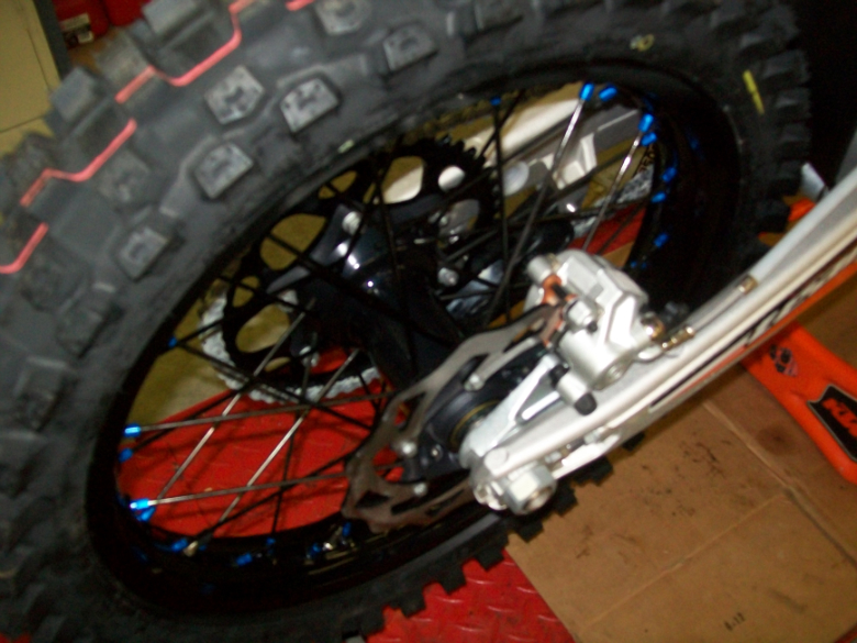

THOSE WHEELS ARE STOCK WHEELS THAT HAVE BEEN COMPLETELY PULLED APART AND ANODIZED. BLACK HUBS, BLUE NIPPLES,BLACK SPOKES, AND BLACK RIMS. THEN PUT BACK TOGETHER.ALSO WE INSTALL A GPR STEERING STABILIZER.

Actually, why wouldn't you do that to the wheels? KTM hubs are quite nice and I do not believe there are any aftermarket hubs that are lighter. TCR rear hub weighs exactly one wheel bearing heavier than stock because, well there is an extra wheel bearing on the drive side. The KTM hubs are machined to about as minimum as you would want to go. The bike comes with Excels rims so no big deal there either as there really aren't any better or lighter rims. Black spokes and alloy nipples are standard issue items. So without spending $1000.00-$1500.00 he got himself a nice set of wheels on the cheap. I can admire that.
While looking for a set of orange triples, I decided to same myself $895.00 on the X-Trigs and get my stockers stripped and anodized orange. Looks great and only costs a hundred buck plus shipping two ways.

If it was 2010 again I'd agree KTM had the best wheels hands down, the hubs isnt what i was talking about though, the hubs are great. In 2011 KTM changed rims, they also went to a different spoke manufactuer with smaller diameter theads on the nipples and while the rims are still excel they downgraded to cheap aluminum. While the bearing and hubs blow away 90% of aftermarket wheels the rims are toasted quickly under hard riding condition.
I was never too happy with the stock 22mm clamps so I went a different route, looking for orange clamps though if you have no complaints then stripping the stock and getting them down would be cool since they're billet and well made unlike other manufacturers.
