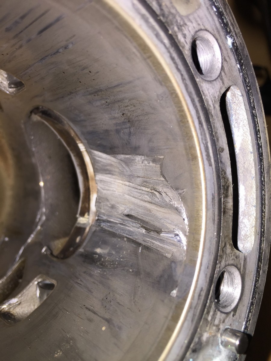

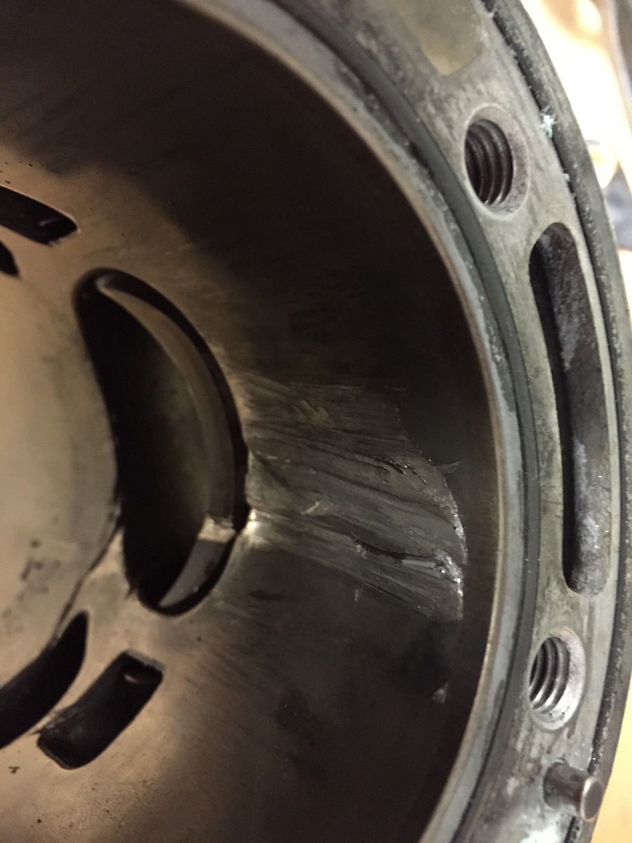

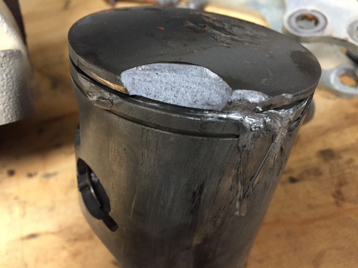

2013 250sx with over 200 hours. 2 pistons done but original crank and clutch. Both are still good, thought that's what went! Bike seized racing 2 Saturdays ago, bought a new 15 on wed. Didn't want to miss one week! Cylinder is at power seal now getting fixed. Then selling it, thinking either bad gas or pulled a lot of dirt through.

MotoKiwi,
It looks like your ring snagged a port. I've seen bad fuel cause detonation that resulted in the ring groove tapering out. Eventually the groove gets so wide that the ring can twist, get bound up and hang on the edge of the port.
There are plenty of other causes for snagging a ring too. Power Seal does good work, I've had several cylinders re-plated by them.
