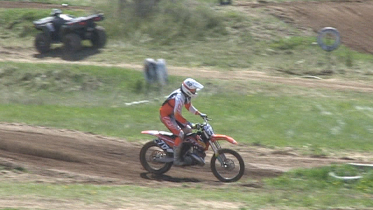

So,
After watching some video of a couple of my motos last week, and watching how effortlessly the little guys move around on the bike compared to me, and how I make my 2012 KTM 250sx look like an 85 (OK, that probably isn't going to change anytime soon), I finally decided I needed to spend some money to open up the cockpit. I'm a bit bigger then the "average" rider, standing 6'7" and weighing in at just under 220 lbs, but I've always kinda shied away from tall seats and pegs, as I haven't liked the feel of tall seats in the past (not to mention they look weird), and 5mm lower pegs just didn't seem like they were going to do much for me, but I was determined to try something. As I was looking through eBay and other sites I came across 2Tall Racing, and long story short, bit the bullet and spent too much on their stage II Space Kit. Simply put, the kit moves the handlebars, tank, subframe, and seat up and out about 2". The Stage II kit's goal is to convert modern linkage style KTMs to fit riders above 6'4". For more info the kit, click here.
Anyways, while I was debating on whether it was a good idea to give my right arm for the kit, I discovered that there really isn't a whole lot out there on the kit itself, other then a few positive words on a couple forums, and the info on 2Tall's website. I started this thread to give my thoughts on the kit and hopefully help other tall guys like me!
Again, I'm a 6'7", 220 lb motocross rider, 22 years old, and ride C (I've been told I may have to move up to B next year so I'm moving up in the world). I run Windham mids and have my suspension set up for me (interested to see how the kit affects those numbers).

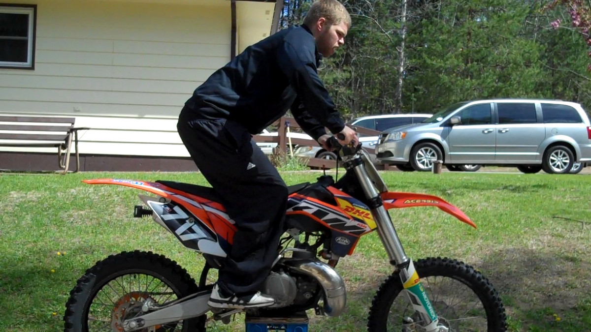

Here are some before and after shots of me on the bike. Its crazy how tall it is, in one of the pictures you can see I'm on my toes with the bike off the stand. This very well could be the first bike I've ever been able to let me legs dangle on, its a crazy feeling for sure! Had my 6'4" cousin who rides sit on it, he could hardly get his leg over the seat!
Stock:
Kit Installed:
Sitting
Stock:
Kit:
Standing
Stock:
Kit:
Off Stand
Kit:
5/21/2015 10:59pm

Pay attention to your jumping, I promise you with the super high bars you're going to find your neutral position back further than normal and some potential air wheelies and bruised arse cheeks are in your future!

Loaded the bike up this afternoon and headed over to the family farm to try it out. Out in the horse pasture there's a grass track the weaves up and down the hills that I've probably logged about a billion laps on. Back in the day my dad used it to train for vintage nationals. I spun my first ever motocross lap around it when I was 5, and it is basically the same layout now. It's great for technique and cornering, so I thought this would be the perfect place to break the kit in.
First off, there is no comparison to this bike and the one I had a couple days ago. They are completely different machines, not like I added a tall seat and bar raisers, but like I stepped off my bike and took a stranger's non ktm out for a test. I was expecting it to feel different, but I didn't expect it to lose its overall feel in general if you know what I mean. It is definitely going to take some time getting used to, and I only got about an hour of riding in so this is going to be an very early evaluation.
Right away one of the biggest things I noticed was how I could feel the bike with my knees and inside thighs, especially when standing. I've always struggled with the concept of gripping the bike with my legs, as its just never felt natural, and probably because of that I have destroyed a few pairs of gloves in my day by way of superhuman death grip of the bars. Furthermore, standing has always felt unstable, especially on high speed jumps or rolling woops, as I was pretty much holding on by my hands and feet. That definitely will be changing, though, because as I started getting some laps under my belt I could start to feel myself gripping the bike with my knees naturally, and what a difference it makes! It's feels as if I've cut a bunch of excessive movement out of my technique, like its smaller and more compact. Because of that I have never felt so stable on a bike. Short guys imagine chopping your subframe down so that when you are standing, the seat is below your knees. I just now today realized how tough that really is.
Another thing I noticed was my elbows stay high naturally. I've really struggled with keeping my elbows up, as they tend to stay down at my sides way too much. This year I've put a lot of effort into correcting that. However it hasn't been showing much:
(also notice my knees above the seat)
The added bar height and overall length of the cockpit must help as my elbows were staying up without me having to force them to. It felt nice for sure.
The transition from sitting to standing and visa versa has also benefited from the kit. I was explaining to my dad that before it was like I was locked in to whatever position I was in. I was either sitting or standing, and to change from one to the other required a lot of effort and movement. I actually know the feeling all too well of preparing myself to do a full squat to stand up on the face of jumps or G outs. A lot of times I would just give up trying and end up seat bouncing everything. With the kit the transition is so much easier. To be honest this is what I wanted most out of the kit, as it was the biggest advantage I saw that shorter riders had; the ability to move from sitting to standing fluidly. So far so good, but I haven't been to a modern track yet so we'll have to wait for the final verdict on that one.
Cornering felt good for day 1, actually had a few instances where I thought I was loosing the front end, but I think it was actually the bike oversteering. This is weird because I have never quite been able to get this bike to turn. So the fact that I was oversteering on a regular basis might be a good thing, I'll mess with suspension and see how it reacts.
One discovery I made was that the mud flap doesn't like to slide between the rear tire and the swing arm too nicely. There's some sort of casting ridge on the swing arm that the now-raised bottom of the mudflap catches on. Result? This is how the mudflap was after I pulled back in.
Any ideas on how to correct this?
Thats pretty much it for my maiden voyage aboard the 2Tall Stage II fitted KTM. First impressions are really positive, I'm excited to get some more time on this thing! Again if you have any questions just let me know!

Here's my opinion, im 6,4, so not in the same league as you, but again, its my opinion.
I think you stand too upright. Head over the front number plate and elbows more out. That way you should get more in control under acceleration, and I personally find it easier to move around and everything.
