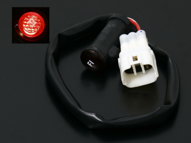

no, it doesn't. the 13 has an optional one, Part No. 36380-28H00. not sure if it would work on a 12 or not.
read here:
http://motocrossactionmag.com/Main/News/f93bc35f-68c9-42b7-a610-610187aff7b2.aspx
" A brand new option for 2013 – riders can now easily track engine-operating time and better manage maintenance intervals using Suzuki’s optional FI indicator light (Part no. 36380-28H00)."

MXA talked about it again in their '13 RMZ450 test. I could be wrong, but it sounds to me like the hour meter comes built into the ECU - the optional part is just needed to access it.
"You need Suzuki’s optional fuel injection indicator light (P/N 36380-28H000) to access the codes (not to mention a quick eye to read the flashing light). There is an hour meter embedded in the ECU, but it also reports its time with flashing lights. Yes, you read that right. Thomas Alva Edison would be impressed, but most racers probably wouldn't be."
My friend has a 2012 YZF450, that he says has an hour meter built in, but you need the device to access it. I have no idea whether this is correct, though.
I usually put hour meters on my new bikes and I agree that built in meters are a good idea.
hmm, well that makes sense. i did an image search for the part number and this came up from Yosh.
says it fits 10 - 13's i have a 12 and never saw anything about it in the manual, i guess it would take a ph call to yosh....
http://shop.yoshimura-jp.com/en/product/syousai.php?id=12336

Found this thread searching I bought the fi light everyone talks about using to show hours but you also have to buy a lead wire assy from Suzuki and hook it up to a 12 volt battery to make the fi light work according to my now found manual.
So I now have to spend another 43 bucks or so to get the wire and buy a battery at this point I'm probably just going to do it cause I have no idea what hours are on my 13 rmz it's never had a hour meter

5/18/2014 1:15am
buggz wrote:
Yami has had it in the 450 since '10
And it is able to be reset with the fi tuner. Fyi
