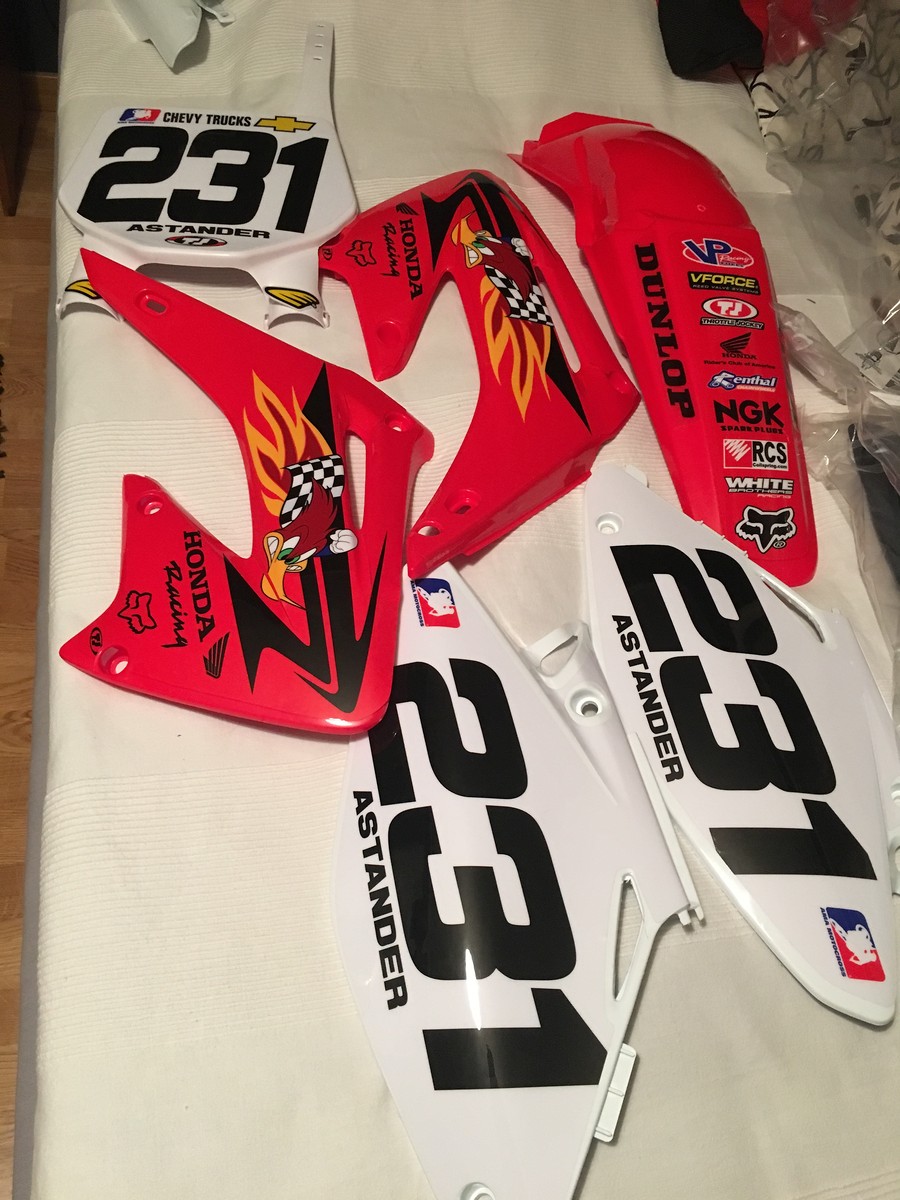

I spent quite a bit of money on just new OEM Honda hardware in the past week or 2.. here are all the little Honda packets with bolts, washers and other parts as I try to keep tack of them. The original parts were fine, but the new hardware is what makes the build look so much nicer in person.
There were few parts that Honda changed as replacement parts that weren't up to the quality of the original items, for example, the replacement carb boot clamps were too flimsy and the tabs bent even before I got tension on the clamps. I chucked these new parts and used the original parts. The fenders and radiator guards are still available and plentiful. Side panels and radiator shrouds available but in short supply. Fuel tanks available but getting scarcer. Air box is no longer available and impossible to find. The fork guards and front disc cover are available from Honda, but no longer in the original white color.. it is now a kind of translucent white which is different than original. Some of the rear brake line guides/ rear brake covers are available, but a few are no longer available from Honda, but I could find them on ebay. It was a good time to do the restoration as the right parts are starting to disappear.
Bike should be finished in about a week or so, but there are a few things that I have had to redo. I mistakenly used aluminum cleaner on the HRC cast magnesium ignition cover and it turned it almost black. I found out later that you should use scrub less bathroom cleaner that has bleach or some other oxidizer in it to clean magnesium. I used the bathroom cleaner after the screw up and it lightened it back up quite a bit.

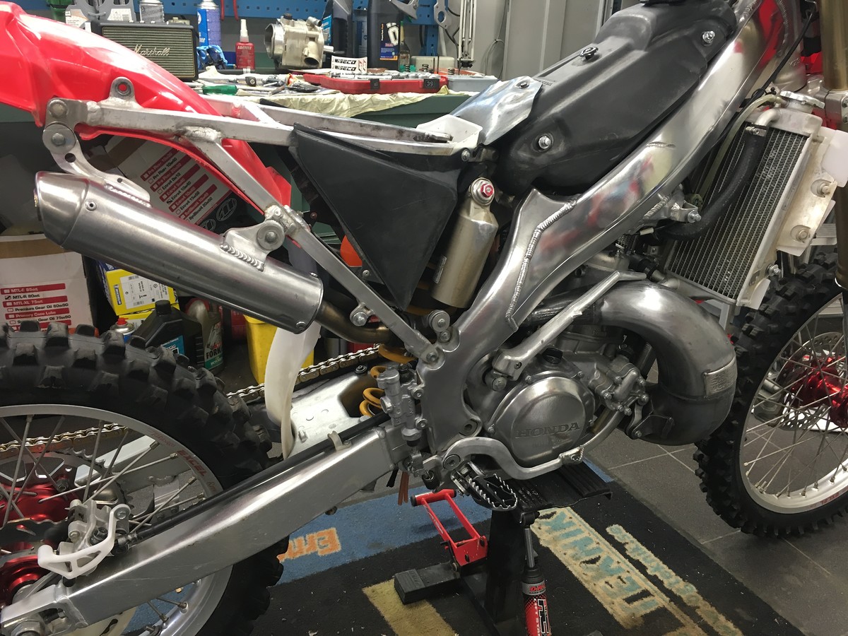

Bike is nearly finished and I started her up today. It started on the 2nd kick and I wasn't expecting it to start so easy since the carb and cylinder were bone dry and I just gave it a few half hearted kicks to prime the engine with gas. She certainly wants to run... it starts just halfway through the first kick when she is warm. I am just waiting on a few more parts coming in next Monday or Tuesday, need to put on the remainder of the plastic, and will do some more detailing. Not sure if I should use the NOS OEM front rotor cover or a carbon fiber one I have had sitting around. I was not satisfied with some of the replacement Honda OEM parts, so I tracked down some more original NOS stock. I spent as much time searching for the original Honda parts as I did working on the bike.
1/21/2017 1:10pm
Here you can see how much lighter I got the magnesium ignition cover using bathroom clear with bleach. The aluminum cleaner had turned the magnesium almost black and thought I ruined it.
