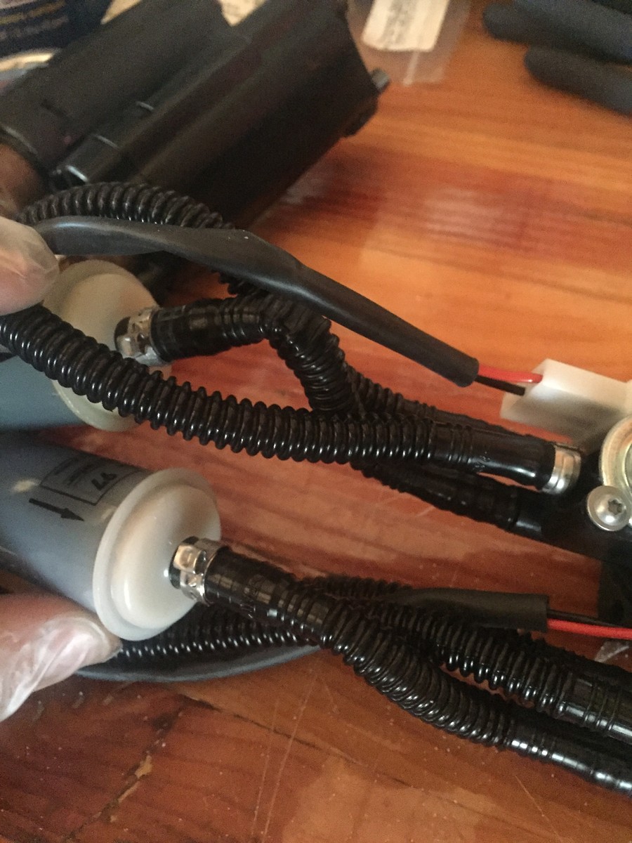

When I took my fuel pump out it also had a kinked pipe that a poster mentioned earlier. I swear the bike has revved better since I sorted that.
Having ridden 450s for 16 years I also think the hour meter with the Rev counter in it is a good move forward. I'm only just learning to really rev the bike as hard as it requires, but have no proof of that without the meter..................
6/21/2016 1:42pm Edited Date/Time 6/21/2016 1:45pm
Here's a photo a kinked fuel pump(top) vs normal(bottom): [img]https://p.vitalmx.com/photos/forums/2016/06/21/140430/s1200_image.jpg[/img]
Mine was exactly the same as that. They get kinked when the shove the pump into the tanks.
Only found mine when I fitted a new tank.

6/21/2016 1:49pm
I fear I'm not extremely handy with the bike; I'm an hvac/boiler guy, so I have tools in hands daily---where do i find this, just pull the seat? Pull the tank?
6/21/2016 1:58pm
Pull and drain your tank.
One part of pump is secured by the 'nut' on left hand side of tank by the fuel line. then you remove the 4 bolts at the rear of the tank and the pump can be removed. Well that's the 15 model. Cant see the 16 being very different. Not great that they both seem to suffer with same issue.
I pulled a 250 FC apart as well and that was kinked too but was still performing fine. But they are highly pressurised.....
gwilson
41
2/6/2016
Easthampton, MA US
6/21/2016 2:04pm
Ok thanks, now is this what people are talking about with the fuel line recall or is that a different issue?
