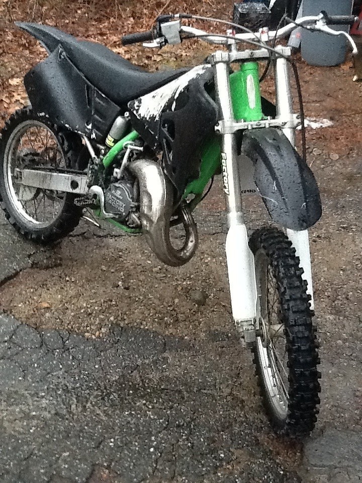

Stock up on Mr. clean by the gallons ( the green original blend no febreeze additives or other crap) lots of scotch bright pads and steel wool, WD-40 and PB blaster for stuff that doesn't move, acetylene torch for stuff that really doesn't move, Wire wheel to re finish hardware, a small parts cleaner, and a soda blaster to take off old paint,rust,dirt and what ever else is encrusted onto it. Stay organized. Zip lock bags and label them, small boxes label them. Took me almost 2 years to finish my 95 CR125. Most important of all is to have fun with it. I like fixing and restoring them almost as much as i do riding them. Really great feeling when you have a awesome finished product that you created with your own hands.

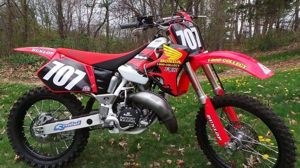

I hope money won't be much if an issue for you. If you're sixteen at least you don't have any real bills to pay. I remember those days.
I found a hell of a deal and bought mine for $550 and it just needed a carb rebuild. By the end I think I had about 4k into it, but it was a complete rebuild.
5/12/2017 7:31pm Edited Date/Time 5/12/2017 7:31pm
Fantastic looking yz right there. Great job.

braaap707 wrote:
Stock up on Mr. clean by the gallons ( the green original blend no febreeze additives or other crap) lots of scotch bright pads and steel...
^^ Woohoo

5/19/2017 11:01am
Why was that bike green.....Huh
