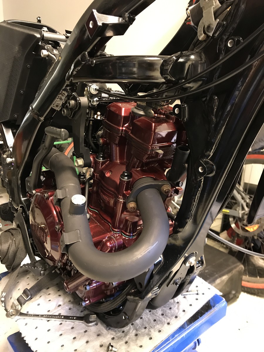

Progress, managed to put some parts together:
fork lugs with lots of loctite mounted on the coated inner tube:
Reinforced the peg brackets since the holes where not so round anymore:
welded a bung so I can dial in the jetting a little more precise:
Was about to start with old awful air box, but then I realized that I don't have the time and patience. So this was the solution:
Almost ready to run lol:

She's ready to start if I add the fuel tank, and I also need to find a road tire for the upcoming dyno run

Kicked it over a few times and bang it started! It seems to running fine, I'm about to install a battery and a innovate afr meter to dial in the jetting on a nearby field. Probably gonna run it on a dyno later on, but can't wait to ride so this will do for now.
